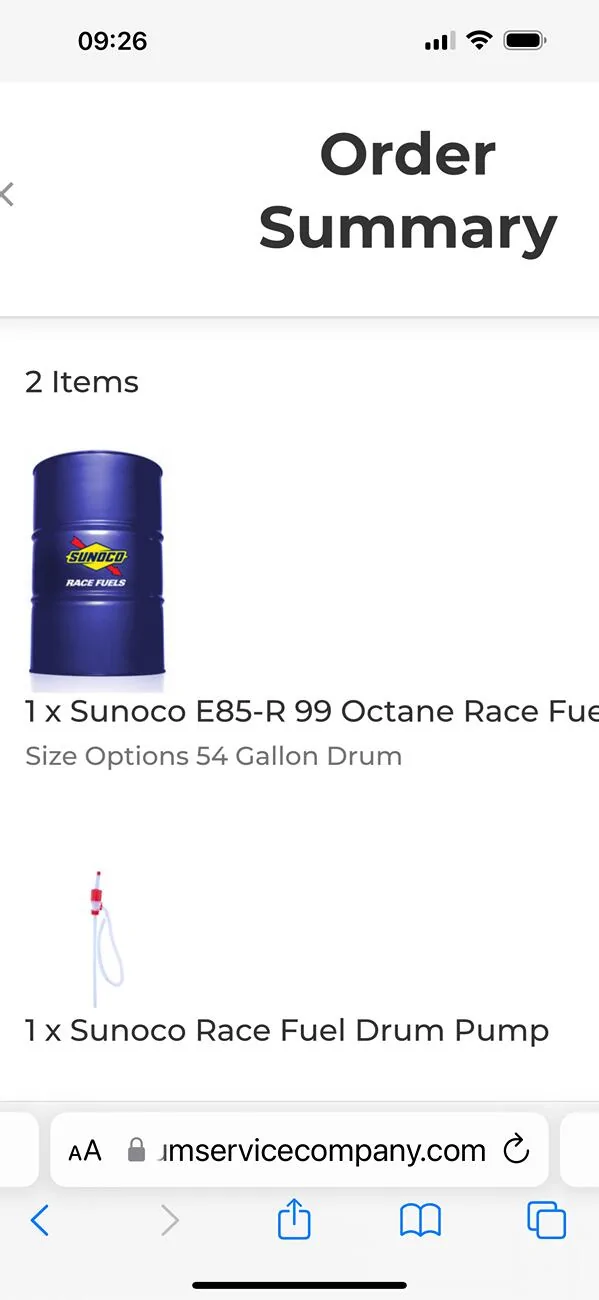

Sooooo, not the smartest purchase ($$$ value wise) I’ve ever made in my life, but certainly not the worst. I’ve spent better money on dumber items, lol.
Anywho…55 gal drum of E85 on the way to finally get the tune set up.
