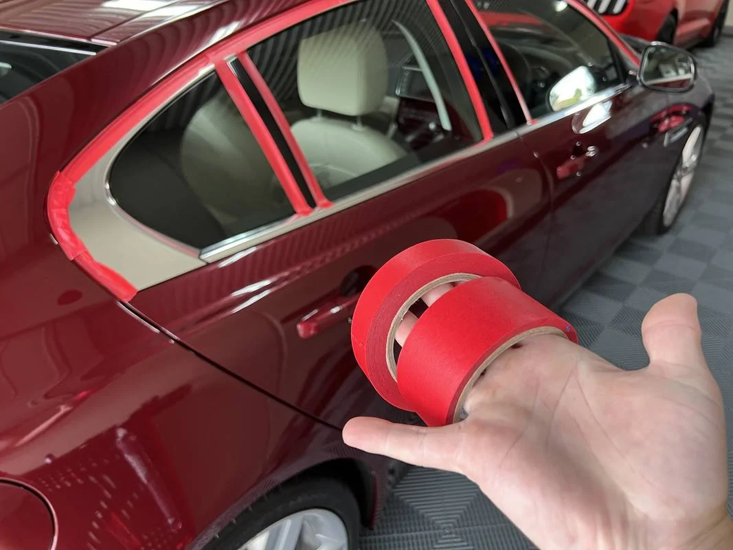

This is a topic that came up when I did the advanced paint correction class with Sandro last year.
- With general purpose type masking tapes, you really shouldn't leave it on for extended periods of time as you risk expensive damage to your paint.
- Painters tape is ok, but from memory, it doesn't have the same heat tolerance. Polishing generates heat, which could cause the adhesive to react.
- Some tapes can leave residue behind, often from heat. Removing that residue can re-inflict marring.
For those reasons, I would stick with tapes specifically designed for automotive/detailing tasks. Something like Carpro's red masking tape, Kamoi or 3M Precision. The Carpro stuff is surprisingly affordable.
CARPRO Automotive Masking Tape 1/2" - 30% More Tape!
CARPRO Automotive Masking Tape 1" - 30% More Tape!
CARPRO Automotive Masking Tape 2" - 30% More Tape!
Kamoi Kabuki S | Auto Detailing Masking Tape – Parks Car Care
3M Precision Masking Tape for Automotive Detailing - High-Quality Japanese Made Tapes in Multiple Sizes – Obsessed Garage
From my perspective, I hate taping because its tedious and time consuming. Paying just a little bit extra for these tapes is money well spent, you don't want to be stuffing around reapplying tape because it didn't hold or reacts to heat and leaves residue behind.
