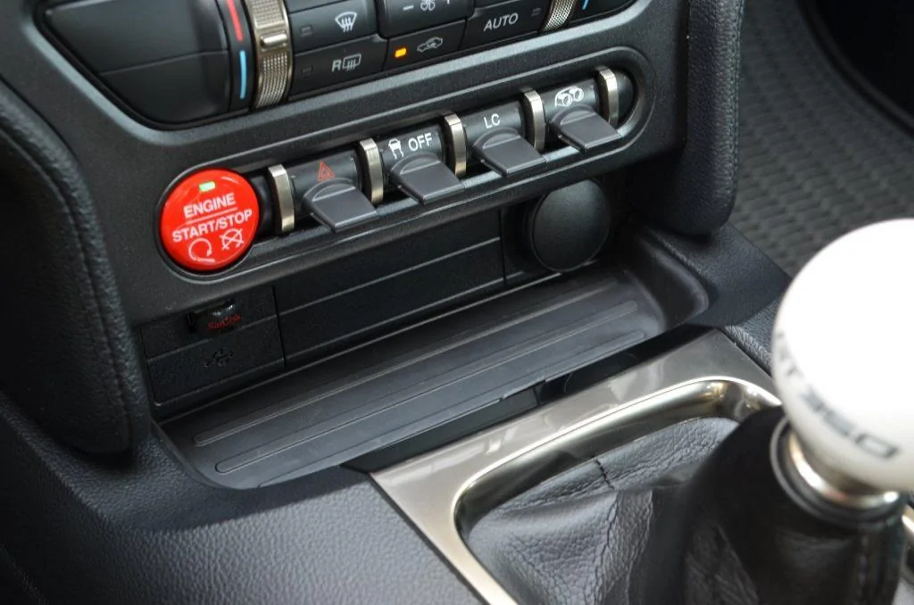

Sometimes it's the little things... Always hated the dumb logos on the interior. I don't need to be reminded that I have a Ford housebrand radio every time I get in the car.

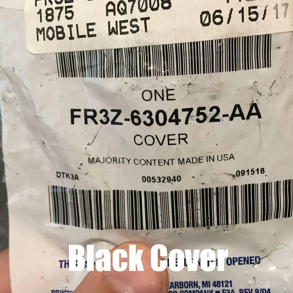

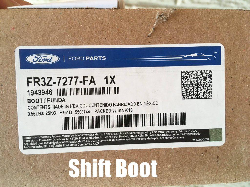

FR3Z-7277-FA is the GT350 shift boot w/o Sync branding and FR3Z-6304752-AA is the black panel w/o "Shaker" branding. Note that if you find these on parts sites like Tasca, they will be listed as "with Sync" and "with premium sound" and the descriptions are BOTH F---ING WRONG. Ask me how I know...

AWESOME!!!! I did not know I could buy a blank plate. Thanks man!
It's what comes on an R with the radio delete. Note that I also swapped the shift boot (and bezel, all one piece) out with the one from the R that has no "Sync" branding on it.

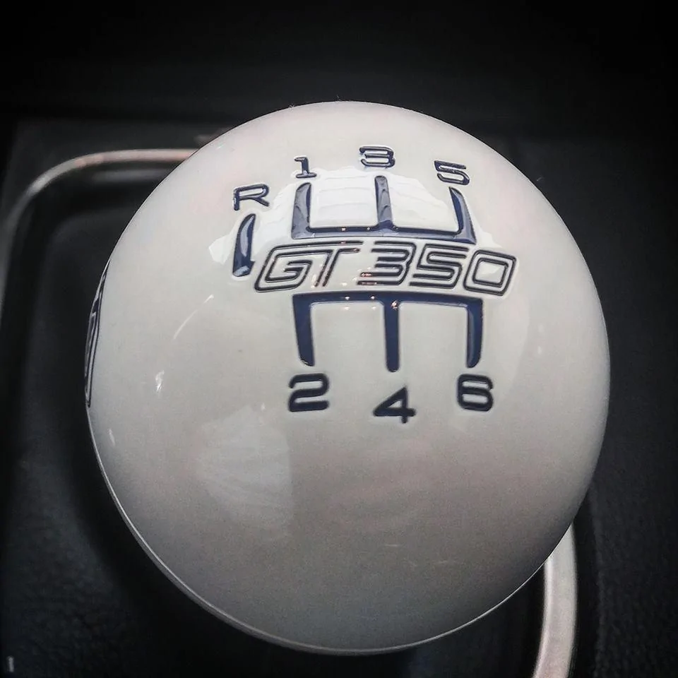

Not knocking the mod, but I find it funny that you hate being reminded you have a Ford radio every time you get in the car, but felt there weren't enough GT350 logos so you had to add more (your shift knob). :D
The GT350 brand to me is more important than "SHAKER"

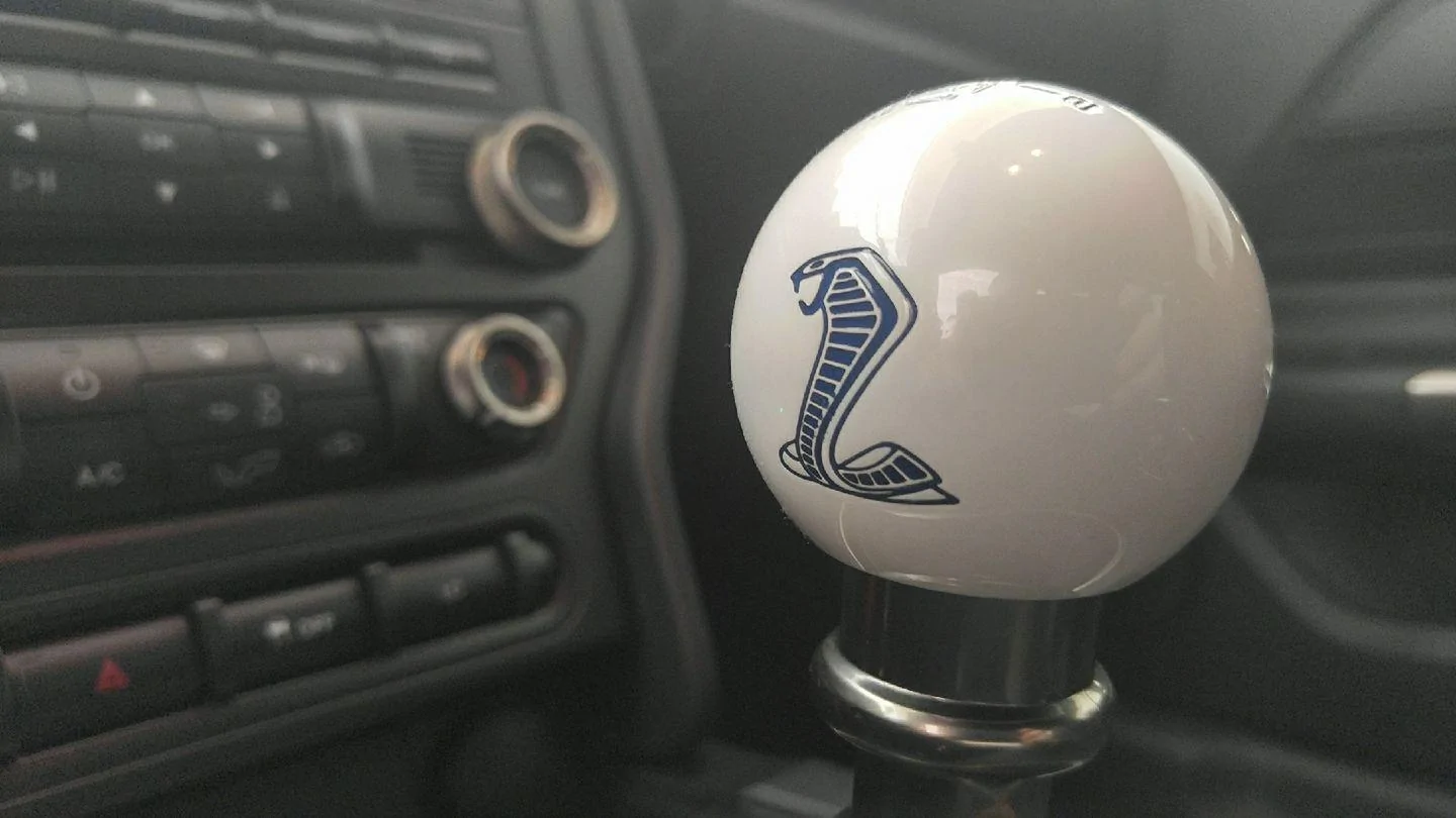

That said I thought about doing a plain white knob like I had on my GT, but for the goofy GT350 threads (which are carried over on the MGW shifter) there aren't a ton of options. That's a Ford Performance knob. It grew on me after a while. I should be getting a custom knob from Anarchy Motive soon that has both the GT350 stylized text and GT350 cobra emblems, similar to this: (not my pics)
So uh... your criticism is valid. :crackup:
Damn, I wish I'd have seen that design before I ordered my shift knob. That's pretty badass.
