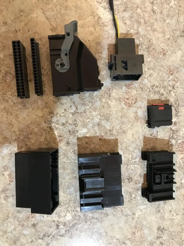

Things will get easier pretty soon for this swap, I received the final version of the APIM connector I improved. So everything for plug n play is ready to assemble
Do you need a guinea pig? :popcorn:
