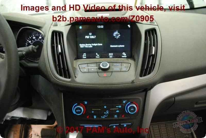

KevinG
Jan 22, 2016
385
102
Fredericksburg, VA
'16 GT PP 6SPD Recaros w/black roof
So basically this screen/APIM from a 2017 Escape will work as long as I get Mustang brackets and new Mustang bezel?

As long as it’s the screen and the APIM it’s a pretty good deal. As Jim said watching Car-Part.com will yield the best prices. However, if you purchase an APIM from a wrecked car be certain to ask for the VIN that the car was removed from.
I recommend calling the source of the salvaged part. I think that some of these are screen only and may not be APIM and screen. To be safe I am also looking at 2017 model year parts as there is discussion that some early 2016's may not be Sync 3 although for Mustangs I believe they all are, correct me if I am wrong.
I am putting together a shopping list now. Great winter project!

All 2016 Mustangs received Sync 3. Most salvage facilities are selling touchscreen and APIMs together because frankly most of them don’t teally Ford considers them separate parts.
Yes, you just need to flash as built data from a Premium car that is identical to your options
