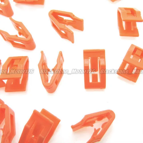

I want to thank @HextallS550 for this wonderful thread and also the power adapter he had for sale! This was a lot easier than I thought it was and the only thing I was getting stuck on really was taking apart my center console. After some prying and praying, it all finally came up. Just need to replace about 5 clips that either snapped or have been lost in the process lol.
