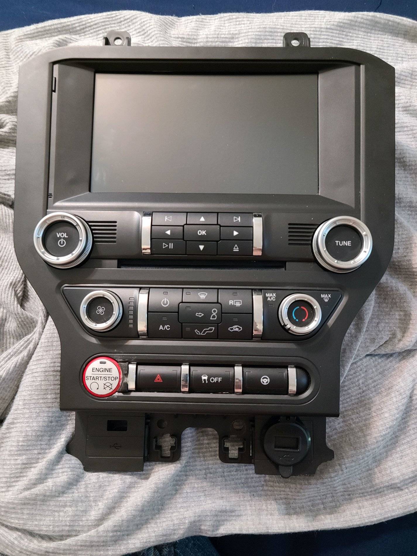

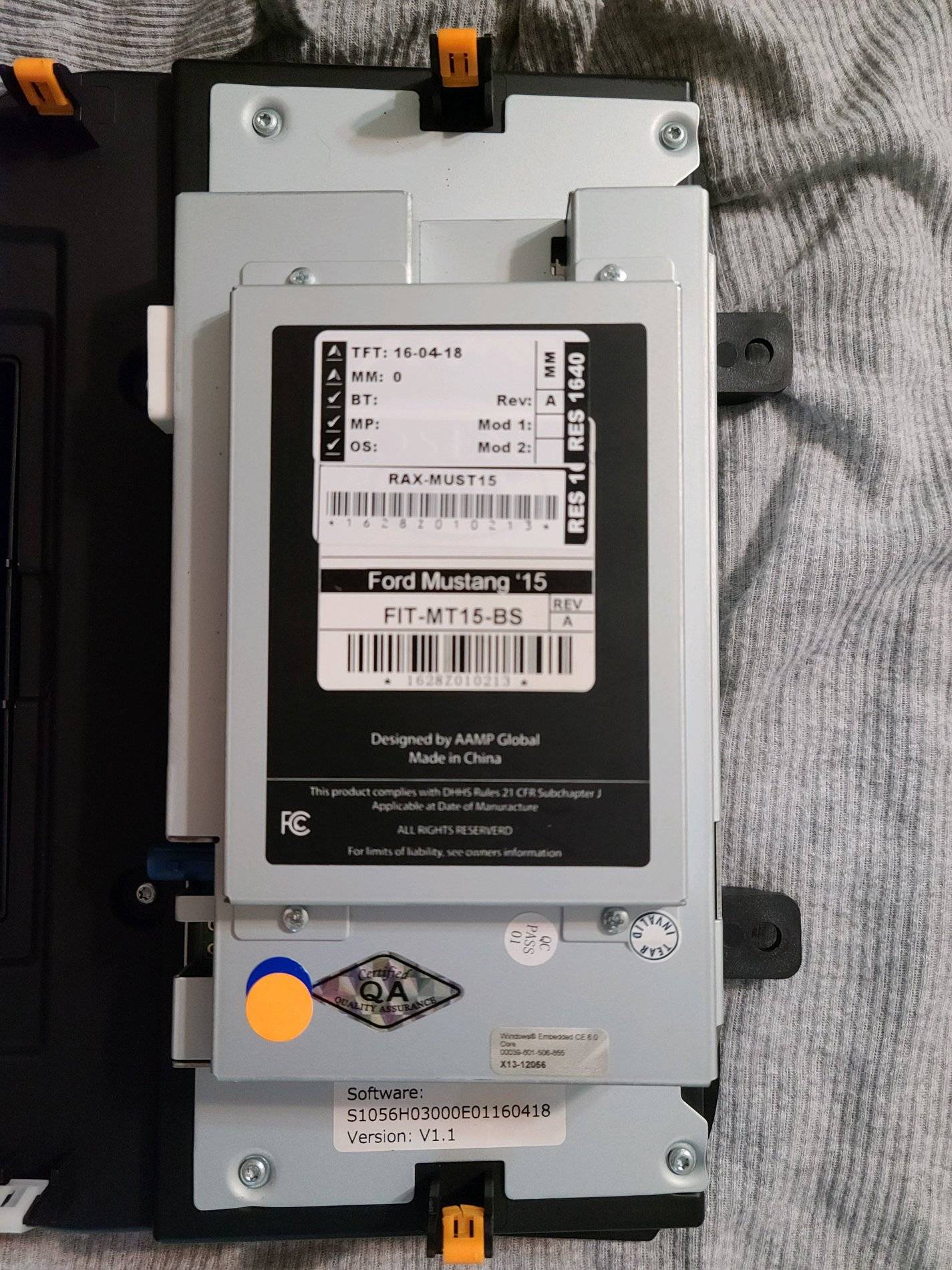

Hello, new to the forum. I have a few questions with this, and I'm not 100% sure this is the right thread but you guys seem pretty knowledgeable about these systems. I bought a 2015 GT that had a Raxiom 8 inch navigation upgrade installed in it. It doesn't work....screen doesn't come on at all, back up cam doesn't show up, sometimes I can get sound but when that happens the volume drops quick and have to keep spinning volume control. I'm not super tech savvy with all this stuff. Would like to do this sync 3 upgrade but not sure what I would need since the original stuff is no longer there (original wiring is, though, as it was a plug and play thing). Do you sell it all as a kit that would be plug and play or do we have to find the parts elsewhere?
