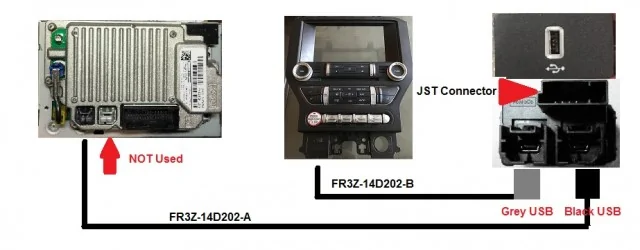

The FCIM usb cable (the usb under the start button) runs not into the FCIM or SYNC, but back to the usb hub (in the center console storage box) and then one cable from the hub back to the APIM (far right in the photo). Did you confirm the FR3Z 14D202-A is connected behind the FCIM? That's where I messed up at first
EDIT: Is FR3Z 14D202-A properly connected behind the APIM (far left)?

I believe:
Hmm I wonder if I plugged it in correctly to the back of the APIM... fingers crossed I didn’t. I’ll take a look in the morning and let you know. Thank you

It also dawned on me that you have a 19, correct? You don't need change the hub or rewire any of the usb cables running in the center console. The 19+ hub is powered correctly for carplay, so you should have just swapped items behind the dash, and retained the existing usb cables and hub.
On my 16,I had to rewire the entire center console and swap hubs.
Good luck!
Good luck!
Would help if it was plugged in!! Thanks for the help
