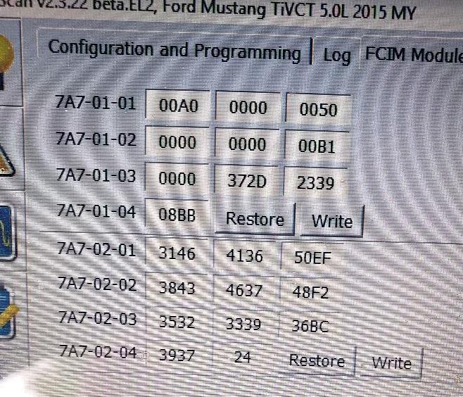

I got everything programmed and put back together but still have the following DTC's that I can't get rid of. I attached a pic of my Forscan screen for the FCIM. Any advice?
FCIM
B1A64 - Left Solar Sensor
B1A63 - Right Solar Sensor
B11E6 - Right HVAC Damper Position Sensor
APIM
U028 - Lost Communicatin with Digital Audio Control Module D

2 of those FCIM DTCs are an artifact of this swap. You can’t write them out. The other is incorrect data. The APIM DTC is because your ACM data is wrong

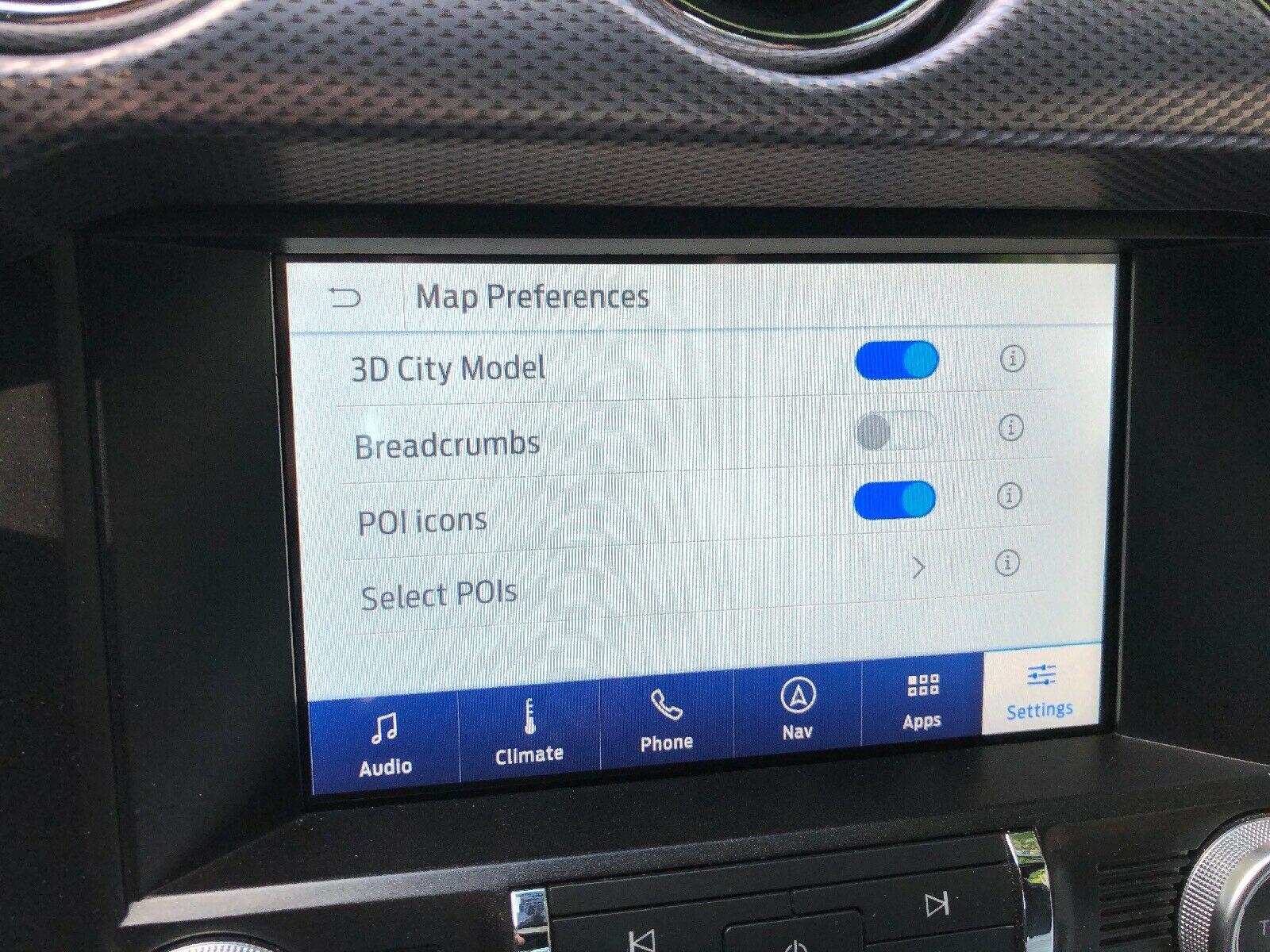

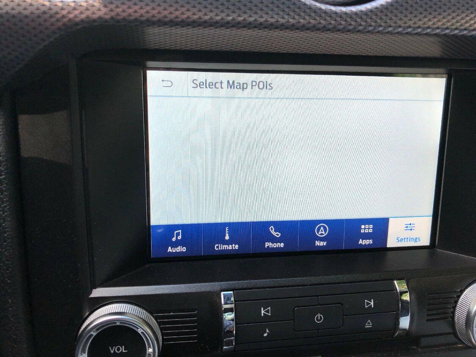

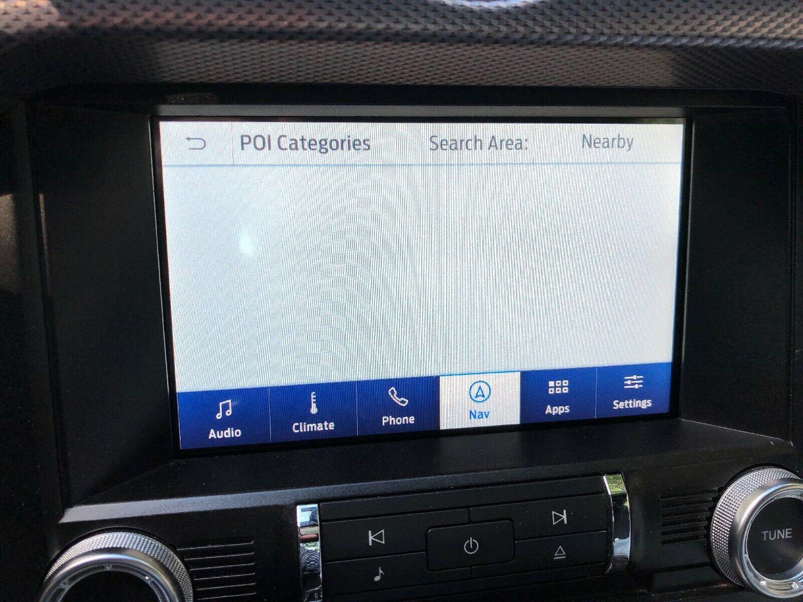

Anyone with the new module with sync 3.4 on theirs have the POI's loading. I am getting the following blank screens when I try to search for POI's
Thanks
