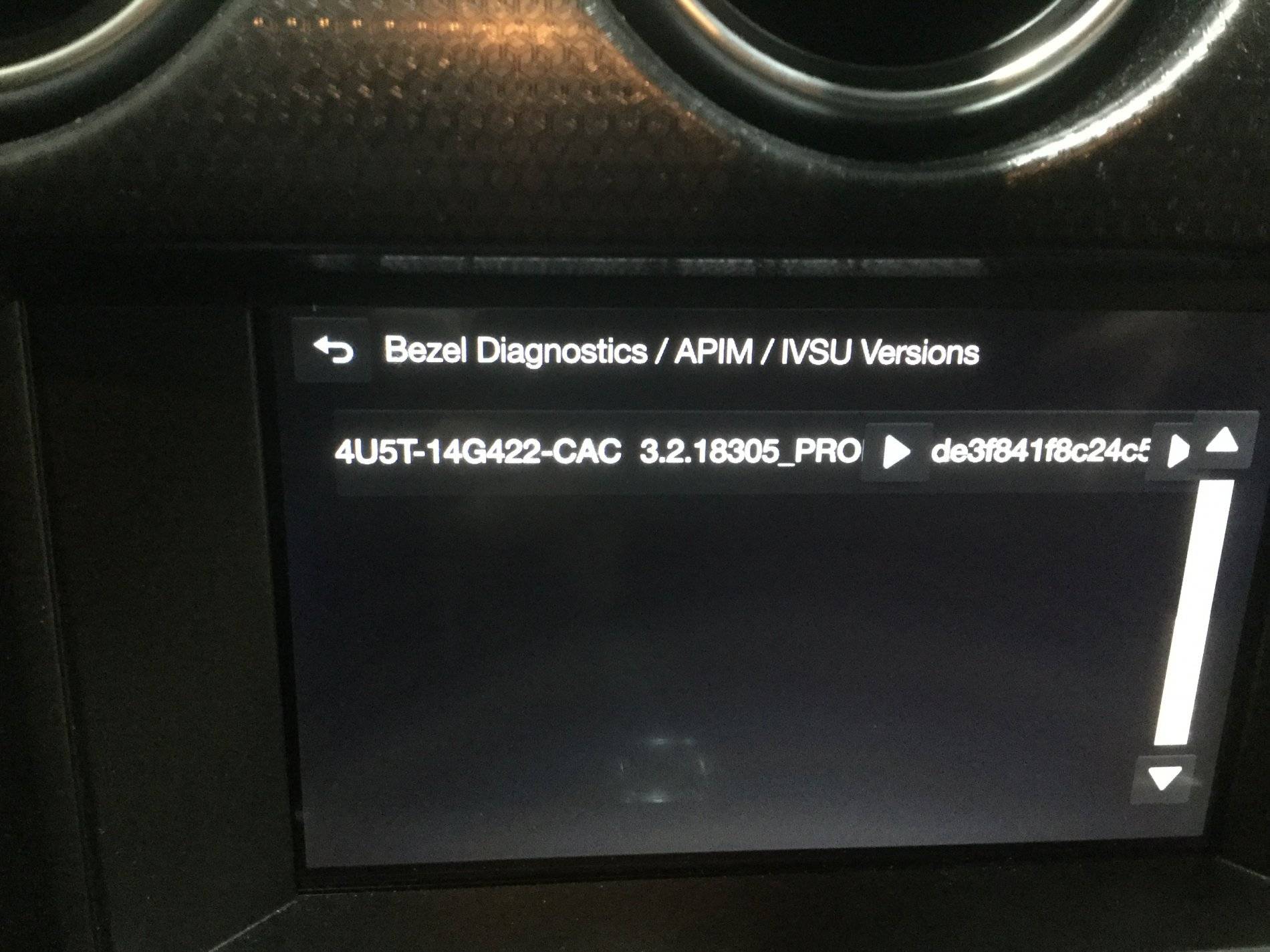

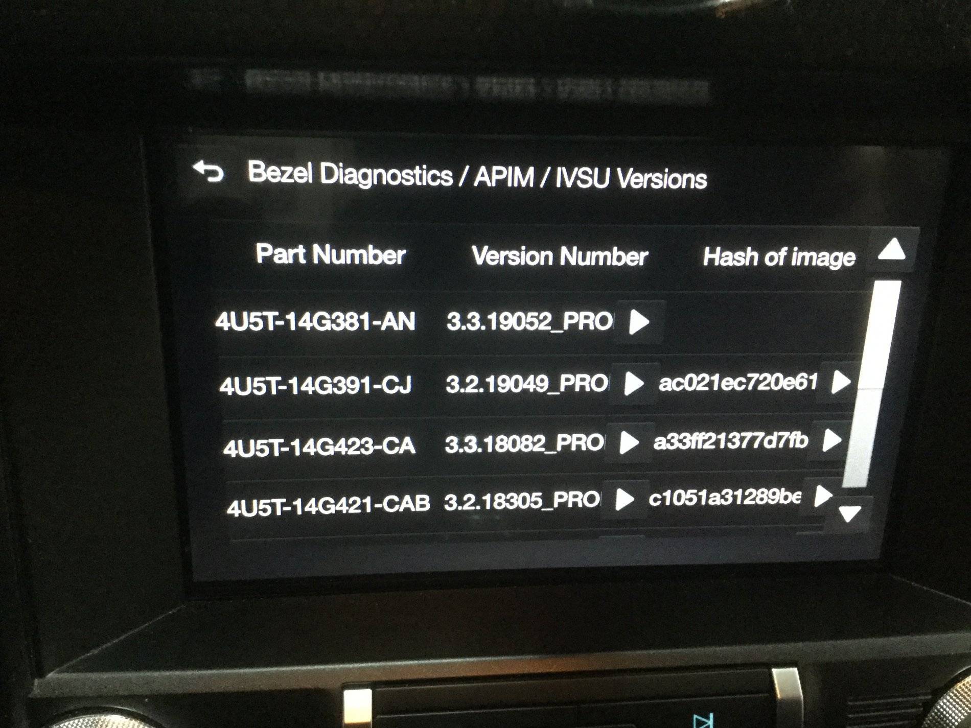

This post list the new map and voice nav files...
To access diagnostics screen, set your mode to audio then press and hold eject and forward buttons as seen in this video around the 2:30 mark
Then go to APIM DIAGNOSTIC screen, scroll to IVSU Version
OK, so getting in was easy enough (you would never know i'm a computer guy). Here are the screenshots of the ISVU versions. So based this I have maps 1.18?
