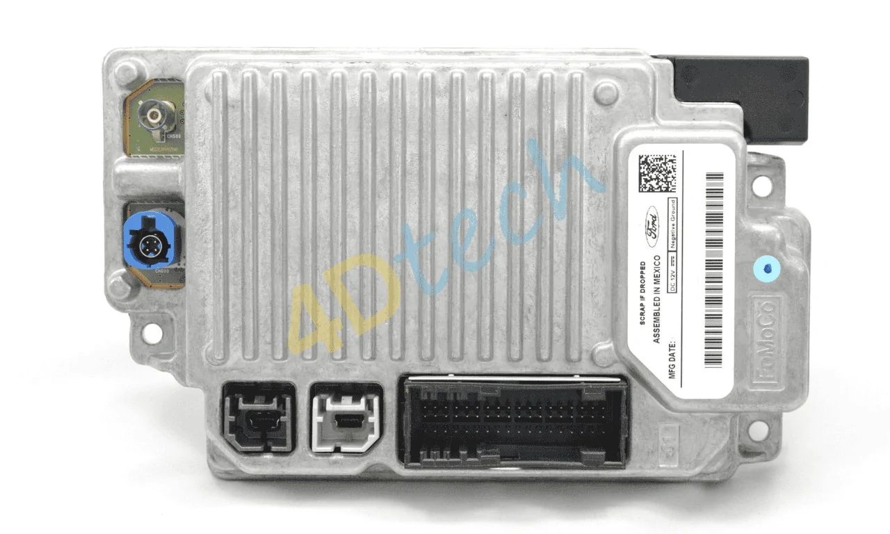

Sounds like you need to do some research. APIM is Accessory Protocol Interface Module. It's the brain of the sync3...
And that is exactly why I recommended not trying to do this on the cheap. Without the basic electronics knowledge the chances of making a mistake go up as will the final cost.
But to answer the question here is a link to an APIM. It's just a FYI as there are other alternative purchase sites.
https://www.amazon.com/Module-Latest-Navigation-Suitable-Lincoln/dp/B09LLZMQCJ

Yes, as I said before the screen is the same. It’s the APIM that determines whether or now you have Nav. I’m not sure who Midway is but unless they offer tech support I’d pass as you are going to need it.
