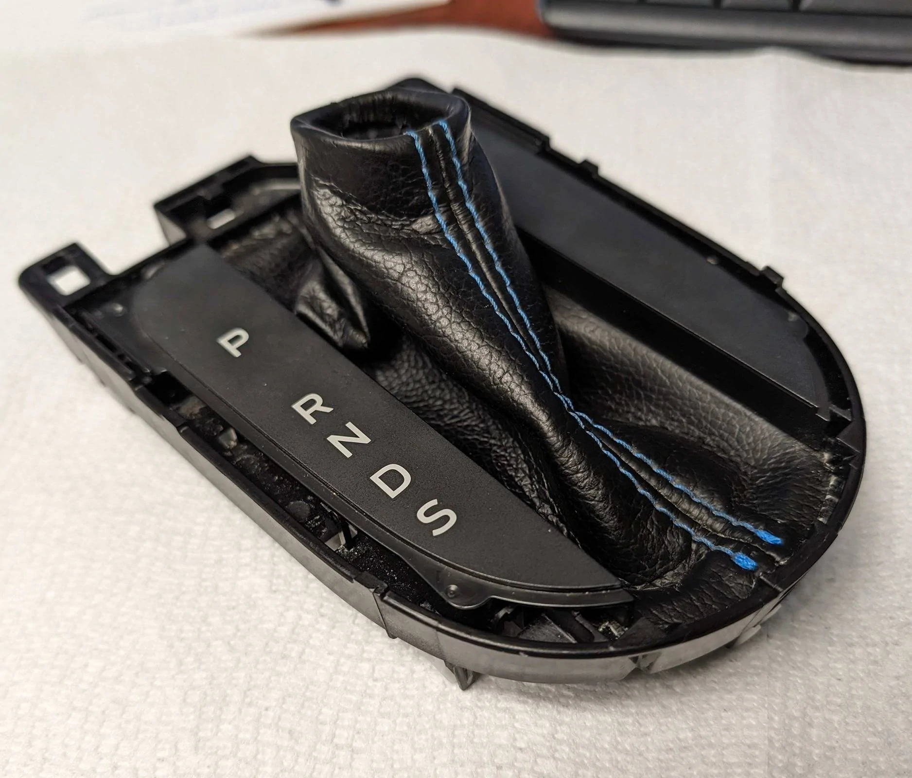

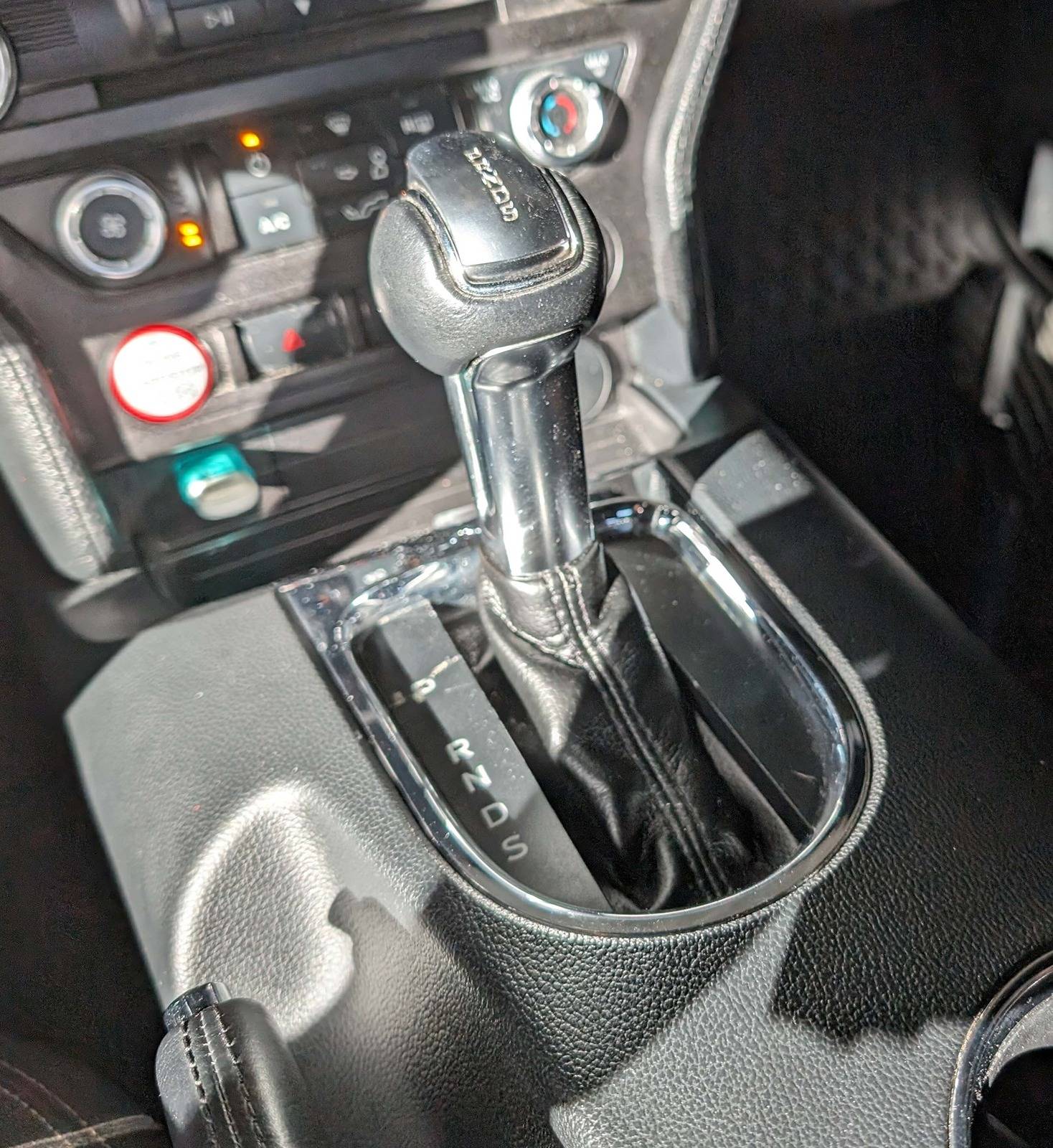

I have acquired the parts, and am collecting data from related threads. And more or less waiting for good weather to perform the operation. For some measure of practice, I replaced the (automatic) shifter trim assembly. The "P RNDS" plate was cracked and was annoying me, so it had to go. I pulled up the center console to push the shifter assembly out from below. It was fairly straightforward. I learned something I already knew: the plastic is brittle, so be careful (I've done this type of thing on other cars).
m2016v6
Mar 13, 2024
206
77
AB
2016 V6 Base Convertible
The offending part (note the crack hear the "P"). Please excuse the state of the interior, I haven't detailed it yet.
m2016v6
Mar 13, 2024
206
77
AB
I took the "P RNDS" plate off of this part. Note: at some point, around 2018, I think, Ford removed the light from underneath the plate, so it no longer glowed when the headlights are on. Kind of lame, because I like the glowing letters. So I pried off the "P RNDS" plate and just used that. The attached picture shows the replacement part.

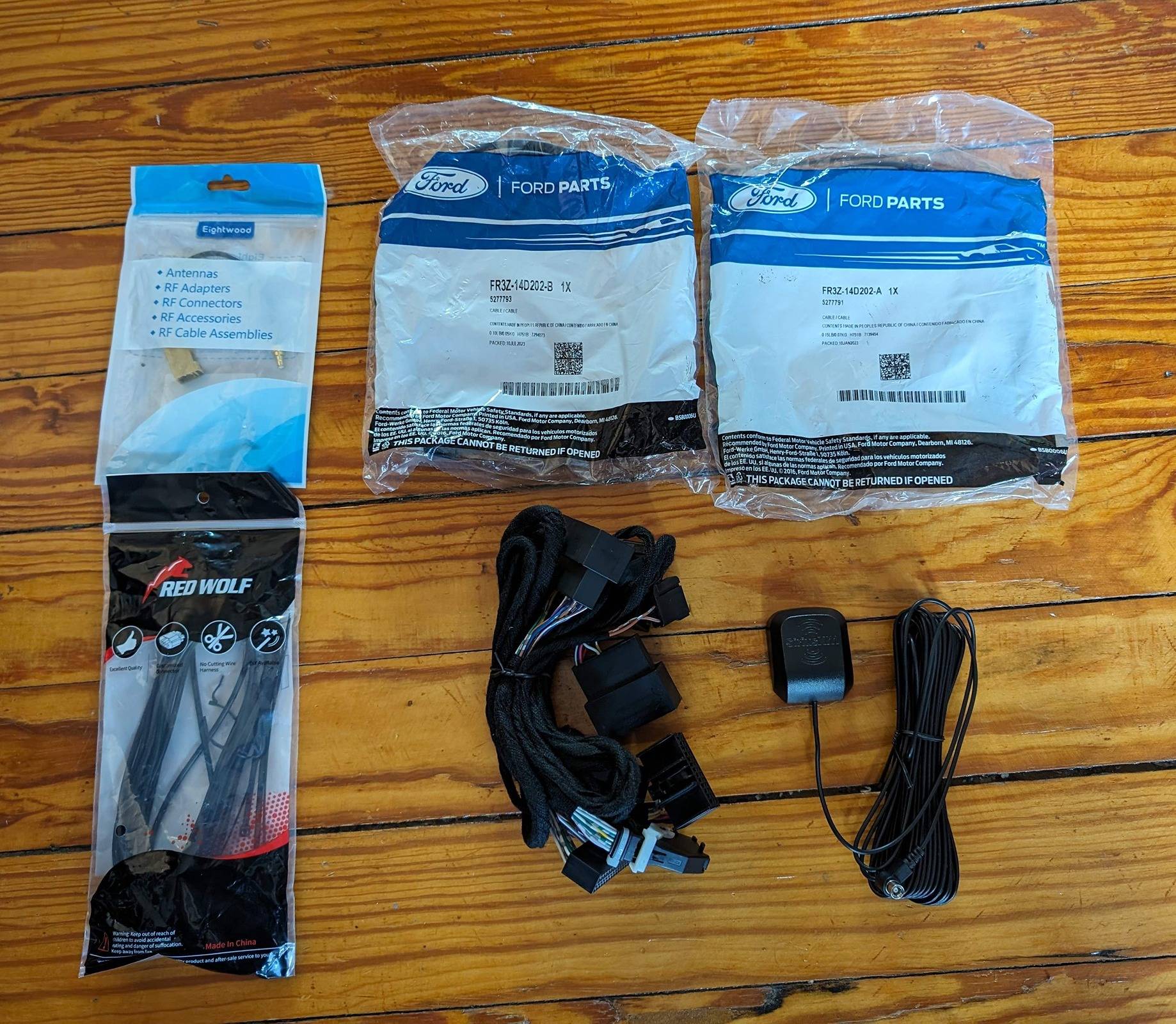

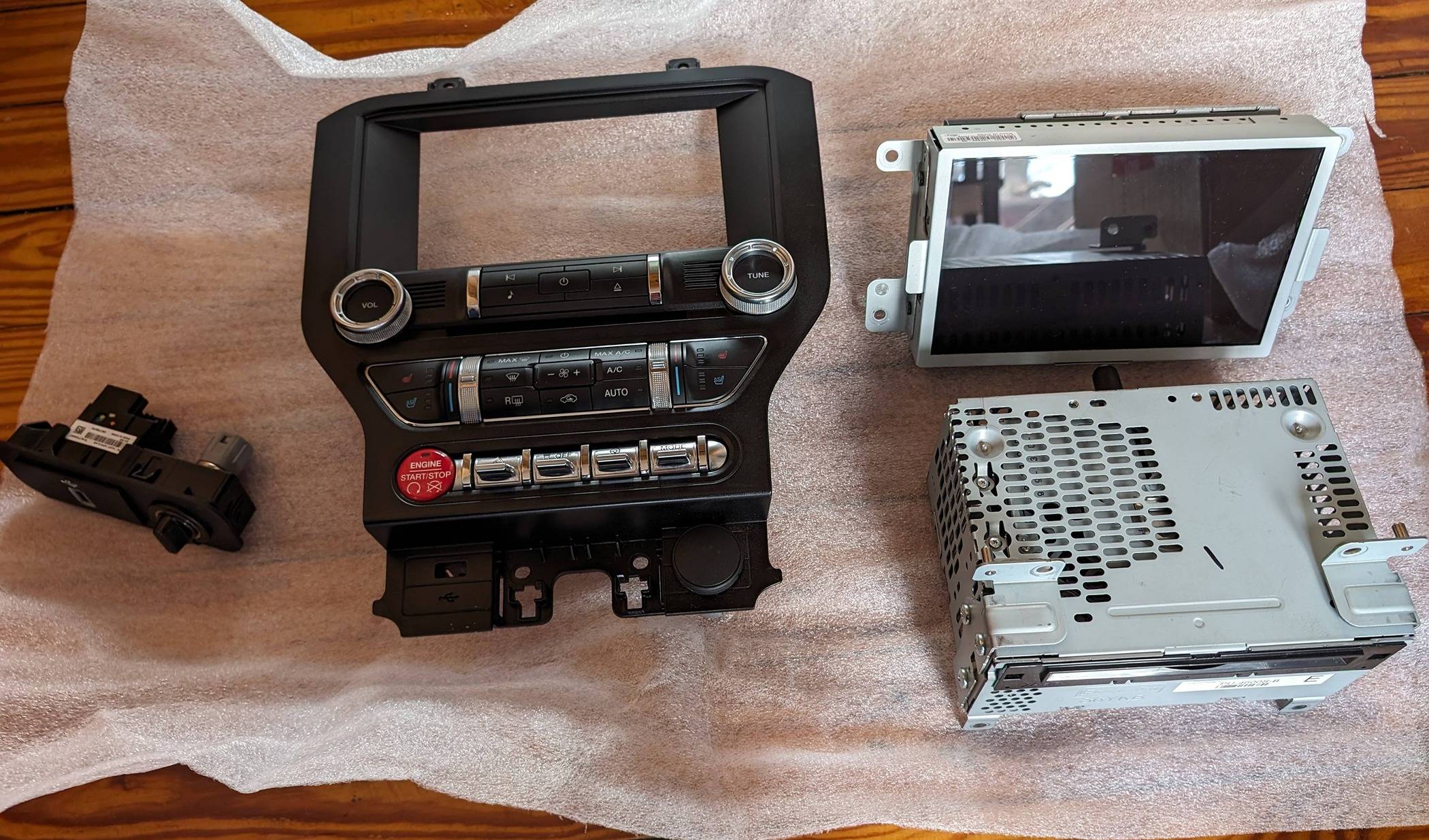

This image features the infotainment parts. I will be going from base 4" infotainment to 8" with nav and HD/Sirius ready (God, Allah, and Vishnu willing).
m2016v6
Mar 13, 2024
206
77
AB
If anybody floats through and thinks I might be missing a part, please leave a comment.

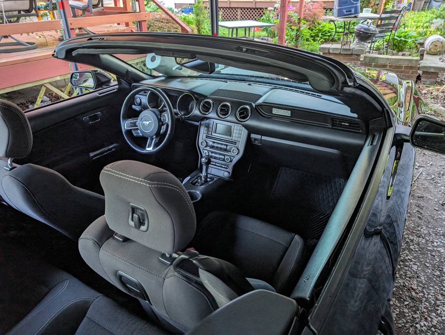

The project has finally begun. The photo below depicts the starting point, the sad little screen. No nav, no nothing.
First, I will have to disassemble the dash.

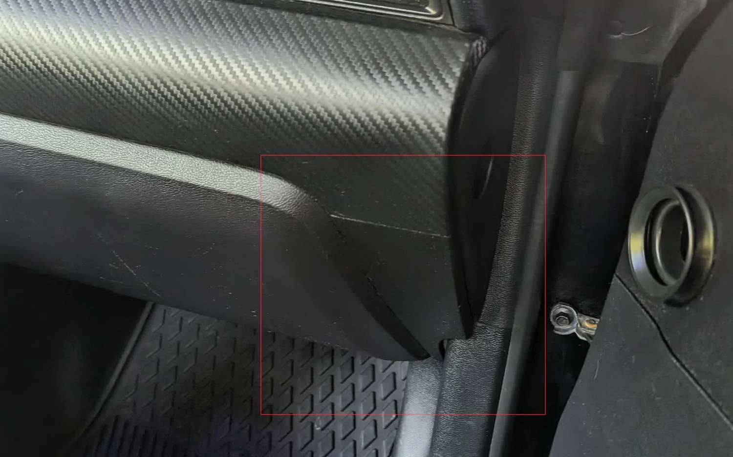

Starting with this little panel by the passenger side door.
m2016v6
Mar 13, 2024
206
77
AB
Using a plastic dash pry tool and my delicate fingers, I removed the panel. I thought I broke it, but it seems fine.

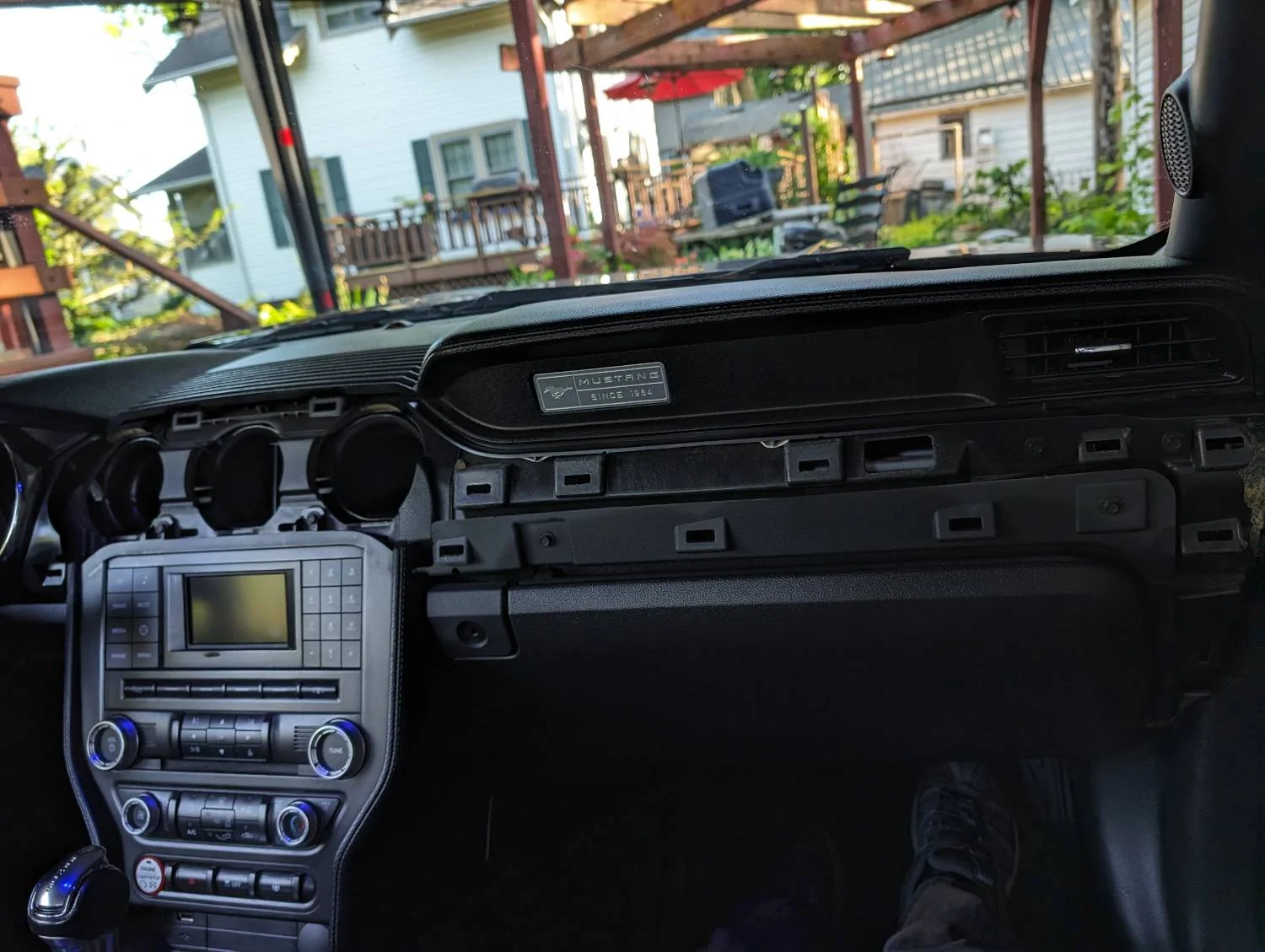

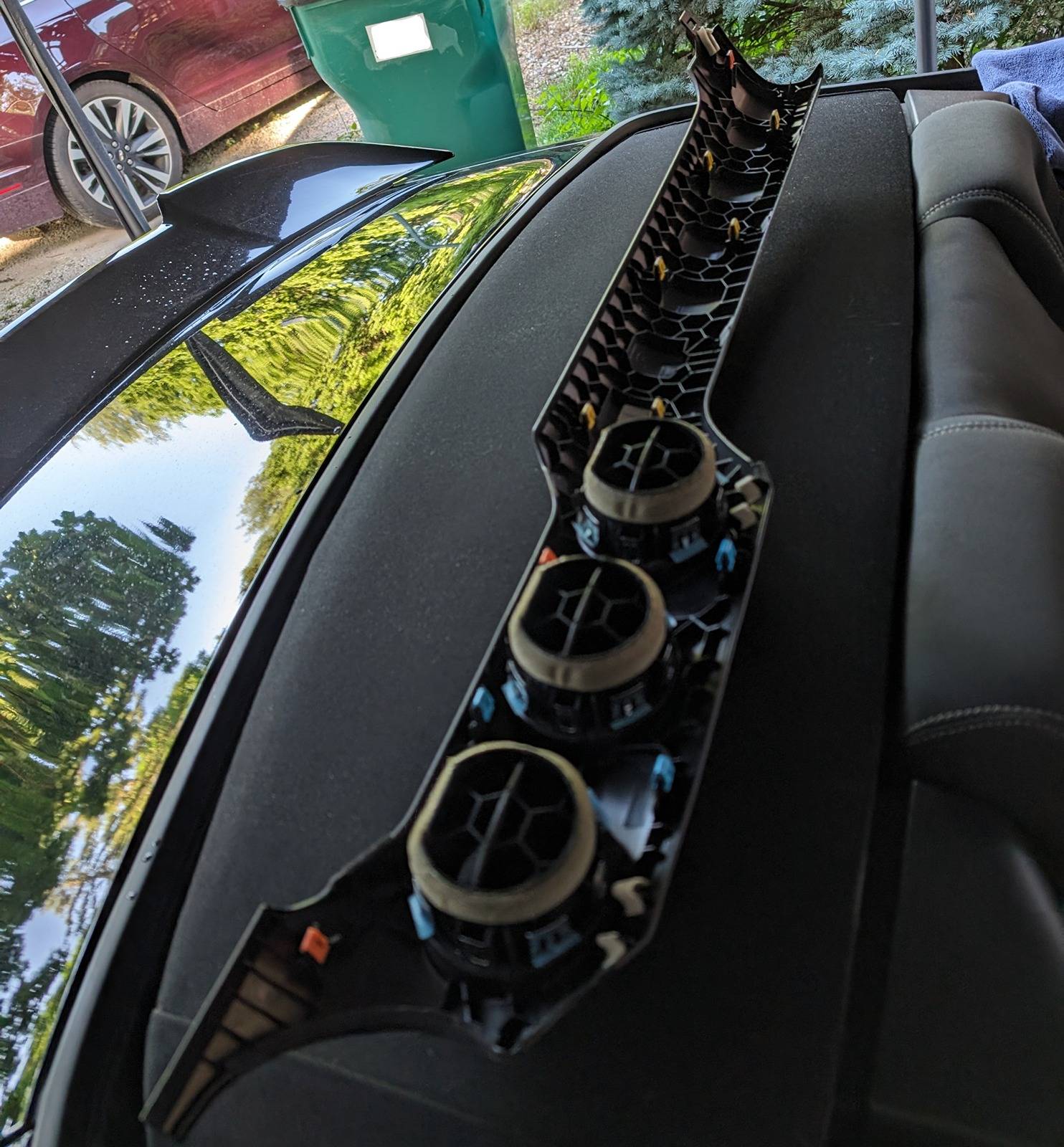

Using the same tool and fingers, I pried off the main dashboard panel.
m2016v6
Mar 13, 2024
206
77
AB
This is the dash panel in repose on the canvas top.

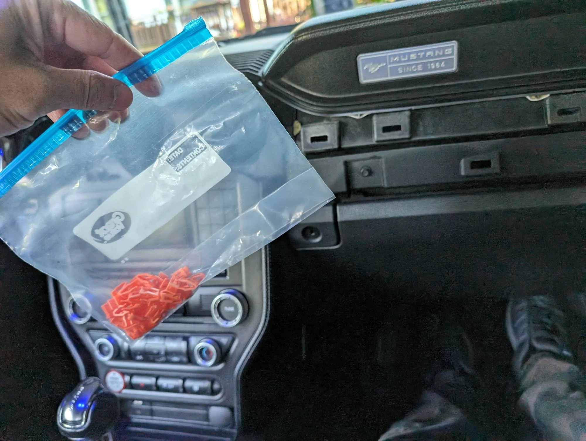

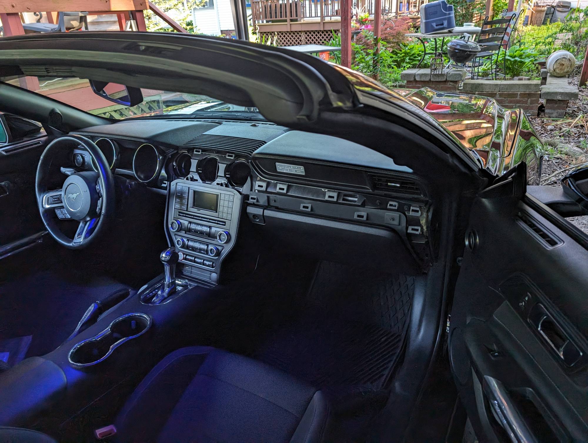

This is a bag of replacement clips for the interior plastic panels. I suggest getting some for projects like these.
m2016v6
Mar 13, 2024
206
77
AB
Step back, this is where we are. I recommend taking many small breaks to slow down. Taking apart automotive interiors is one of the worst things a person can do. It's how many less reputable countries torture dissidents.

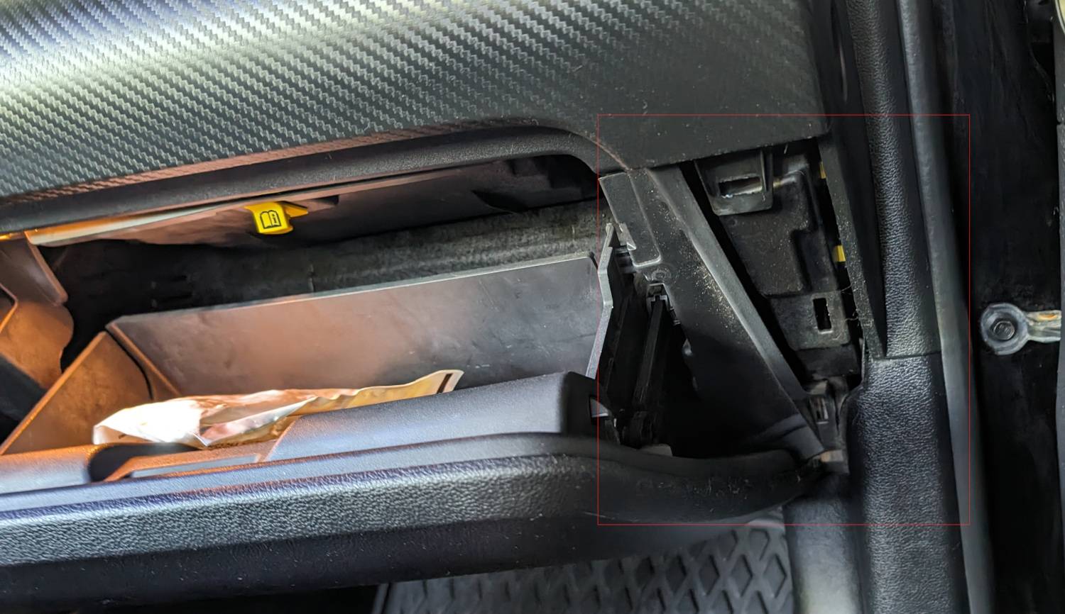

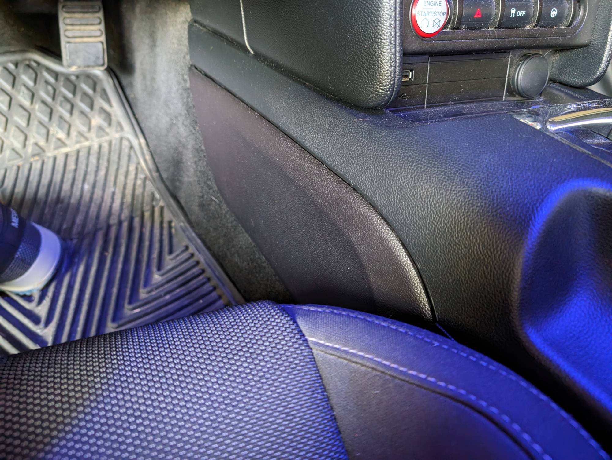

Now I am going to move the center console up and back, to make for bezel removal and to replace the USB hub in the console glove box. I will start by removing these panels (driver and passenger side; driver pictured. They are held in by clips and a magnet, I think. Using the pry tool, they both came off fairly easy.
