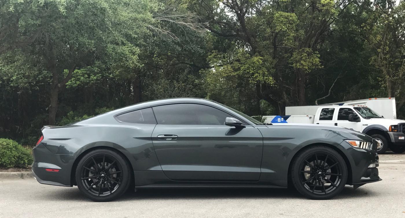

Totally unrelated to the thread but my dilemma has been tires. I'm fond of the Firehawk Indy 500 series and the MMR 350 wheels are asking for 305/30-19 I think and the Firehawks stop at 285/35 for 19's. I don't really want a 20" rim but that is a bit closer at 305/35R20.
I do like the rims. Those and some of the 5/6 spoke project 6's I think they are called. Tires always bust my rear :)
I am running 19x10 square with the Firehawk's in a 285/35-19, and highly recommend the setup. These tires are phenomenal for the $$
What rims, sorry if I missed it or didn't catch. Does it require you to run any spacers or different lug nuts? I'm on a GT/PP so have to clear the brembo's.
solodogg
Sep 13, 2016
442
167
Orlando
2015 Mustang Ecoboost
MRR M350 19x10. No spacers required all the way around, will clear the Brembo brakes just fine.
