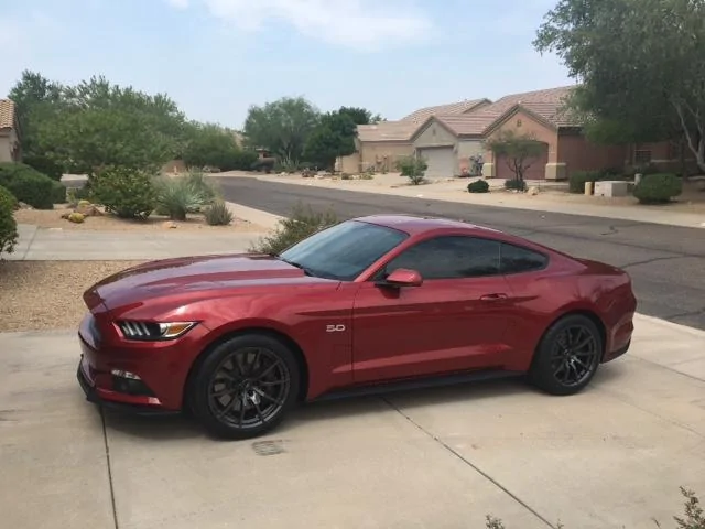

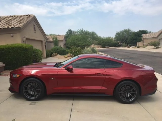

Stock 2017 Ruby Red PP with SVE GT350 19x10 gunmetal with 275/40 MPSS on all 4 corners

Not lowered yet. Only 2 weeks old. Week 1: Roush AB, Week 2: wheels/tires, Week 3: PP2, Week 4: springs and shocks/struts

Considering same wheels but with 285/35 tires. Can you post some more pics showing the front and rear tire alignment with fenders?
Curious if you needed spacers, also curious if there would be room for 285s with those wheels with or without spacers without some alignment tweaking?
