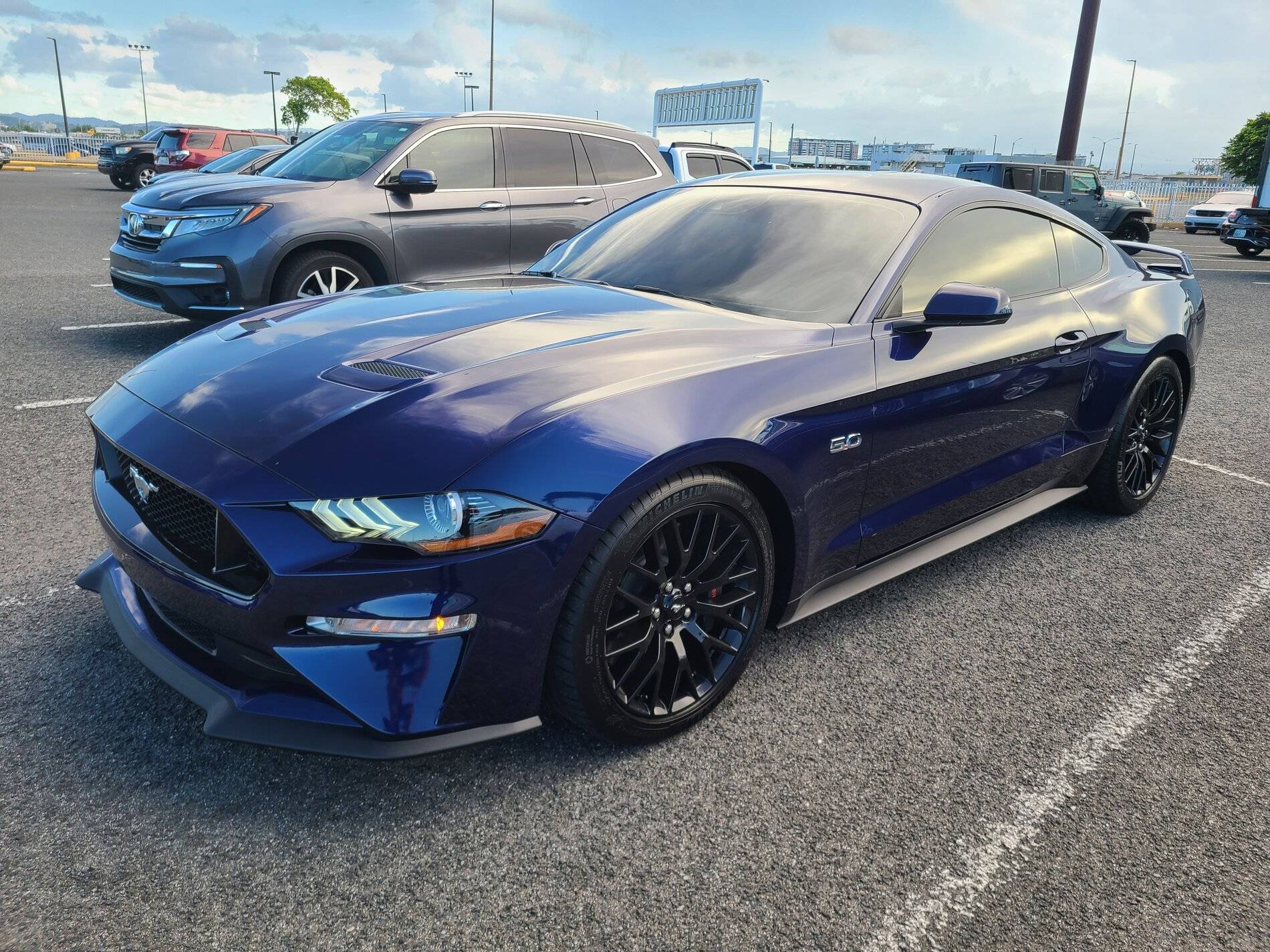

So I just pulled the trigger and my new wheels and tires have been ordered! It was literally a last minute curveball as I was about to purchase the Velgen VF5 Gold, but in the end my heart went back to my original favorites...the Project 6GR Tens in Satin Bronze! They are on backorder until next month so I have some time to get my suspension ordered and ready. My setup will be this...
20x10s; 285/35/20 +35mm.
20 x 11s; 315/35/20 +50 mm.
Wrapped in Michelin Pilot Sport 4s. Shouldn't need spacers hopefully.
My question is this...I am trying to decide whether or not to get the FRPP Track kit or go with just some springs and shocks for now and then add more parts down the road. I have been looking at the Steeda Pro Active Shocks, paired with the progressive springs dropping the car around 1.5" but, I don't know if that's going to be to much of a drop for my setup. I know the FRPP kit is about 1" all around.
The FRPP kit would give me almost everything I need but on the other hand, I am ok with shocks and springs for the aesthetic appearance and lowered look for now. I do plan to take her to the track in the future but for its just a spirited driven car.
