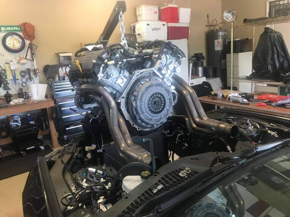

My 2016 with a Gen 2 2.9 Whipple gets track use. I have the over-sized heat exchange as well. I end up too tired to keep going before the car does. Now to be fair I did blow the stock short block up at the track on boost. Upgraded to an MPR racing short block and have had zero issues now.

What happened to the old block?
Spin bearing or a rod?
