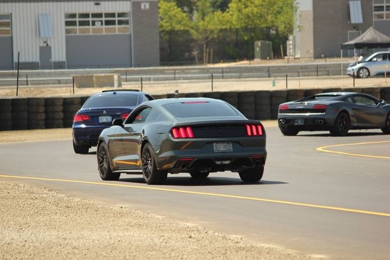

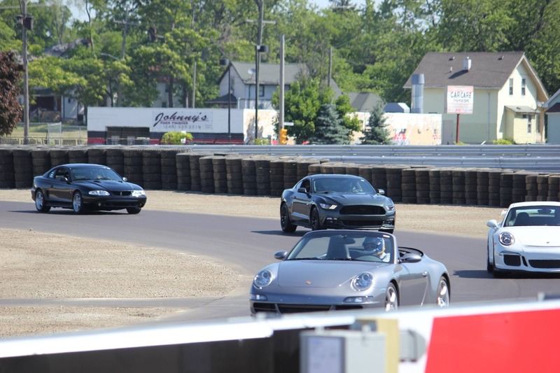

This past Monday I finally got the mustang on a track with the local VW club at Waterford hills. Small tight track that doesn't really favor heavy higher HP cars. My goal was just to take it easy and feel the car out and learn how it handles as it is a different beast than my modified 95 Subaru.
I was very happy with the results. Totally stock the car was running 2 seconds faster than My Subaru was last year.
About halfway into session two I got the axle over temp warning :mad: I ended up keeping sessions to about 10 minutes and allowing for a lot of cool down time in between to manage that issue.
Also running stock pirellis at almost full tread (2500 miles on them) around 38 PSI hot, really chewed through the front left tire. Outer edge is pretty feathered. It didn't feel like I was pushing it THAT hard. What are the factory camber specs?

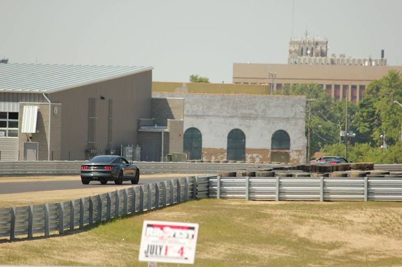

Second track day today. Totally new track. It was kind of cool to be the first ones on it.
Starting to get more comfortable with the car. Still stock for now. I just have to figure out a way to keep the rear axle cool. Couldn't finish a session without the warning coming on :mad:
