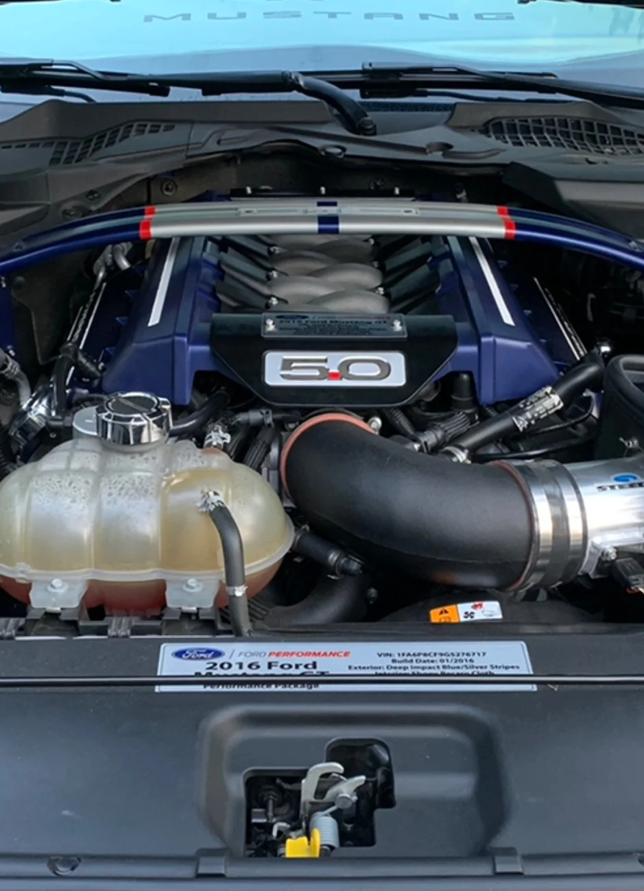

I painted mine to match my hood stripes.
