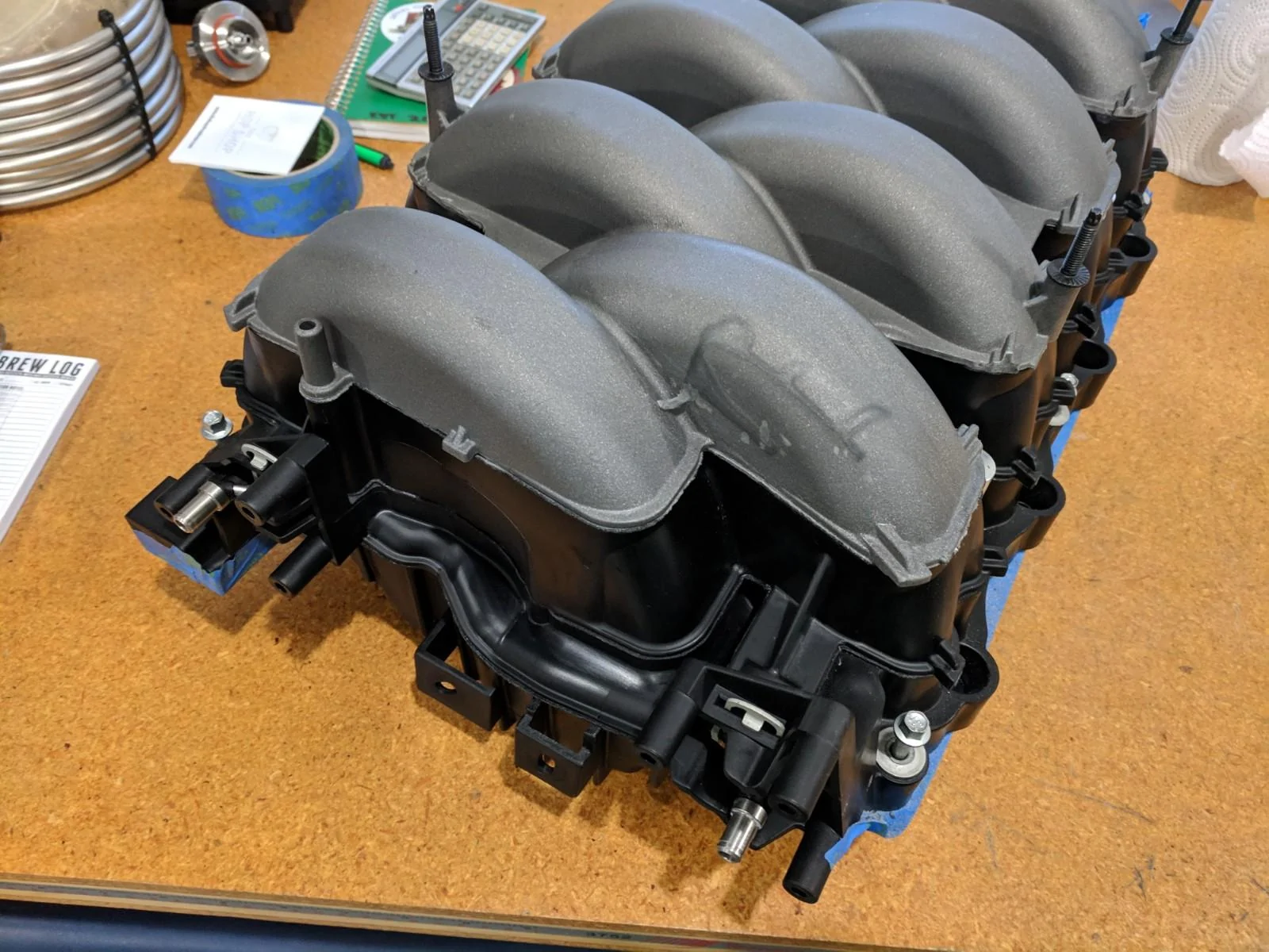

A little more careful grinding and some sanding, and that mounting boss is history. I plan to paint the upper portion of the intake to completely hide the deception and further beautify my engine bay, I’m just not sure what color at the moment. Maybe gloss black…maybe body color…or maybe red wrinkle finish. Decisions, decisions.

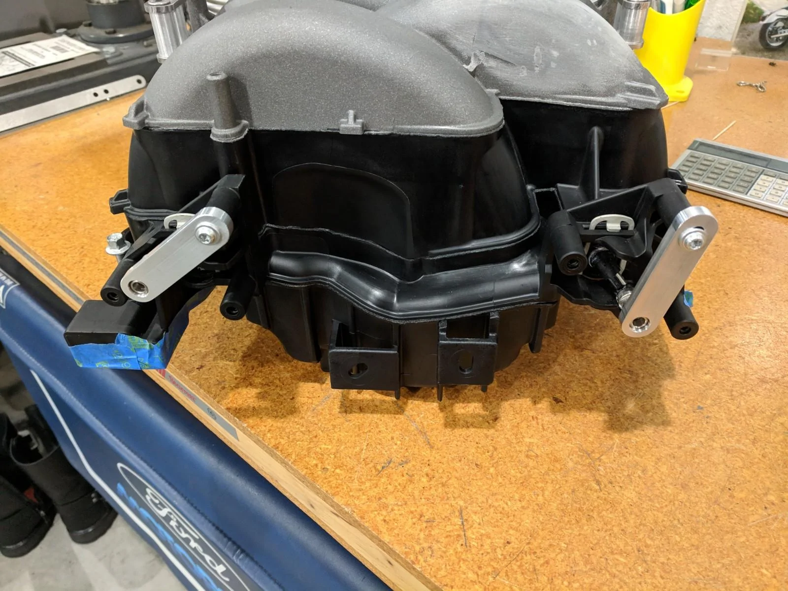

Homebrewed IMRC/CMCV lockouts. An engineer with access to machine tools pay $60 for these? I think not…

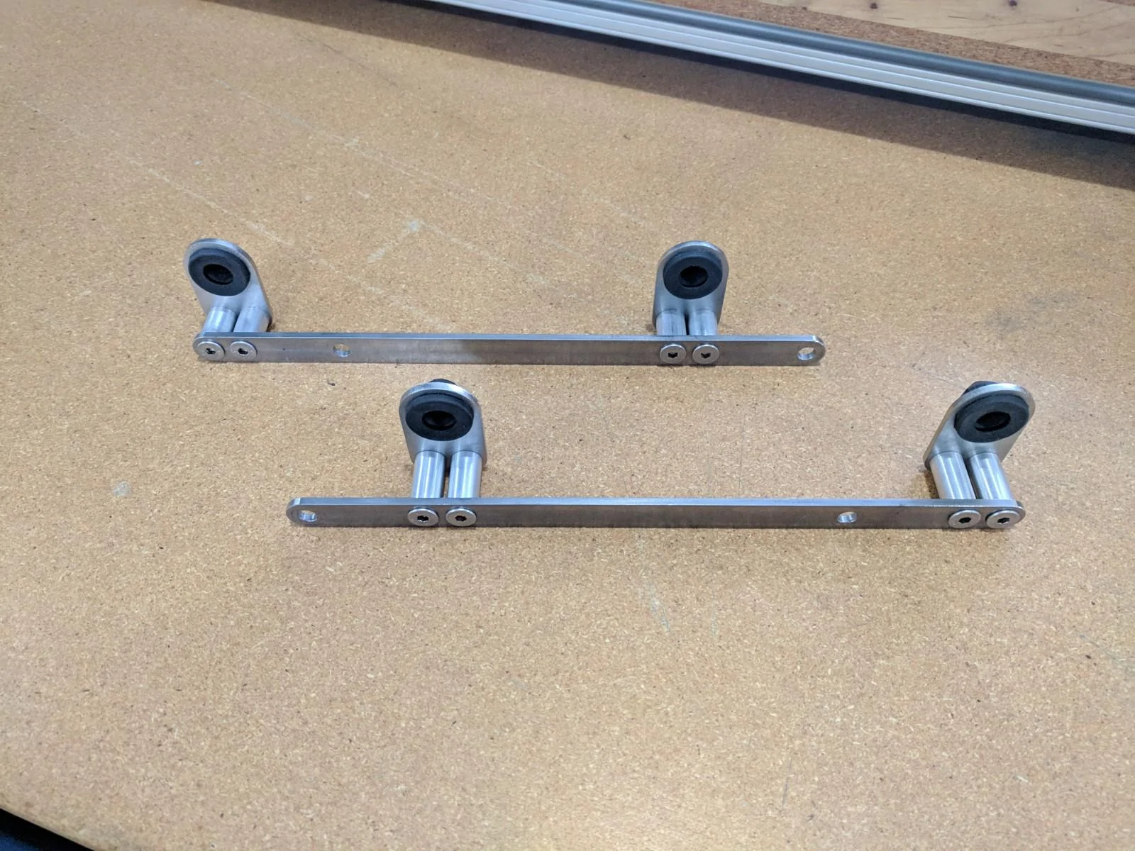

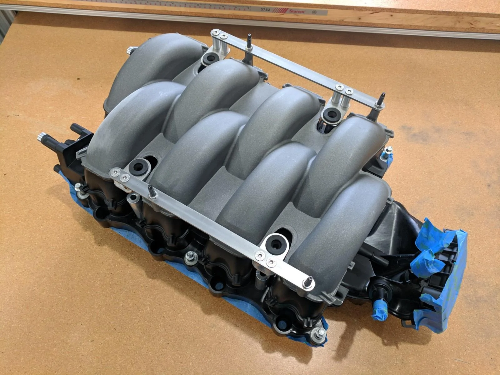

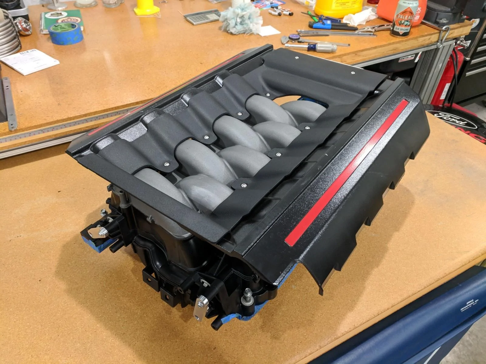

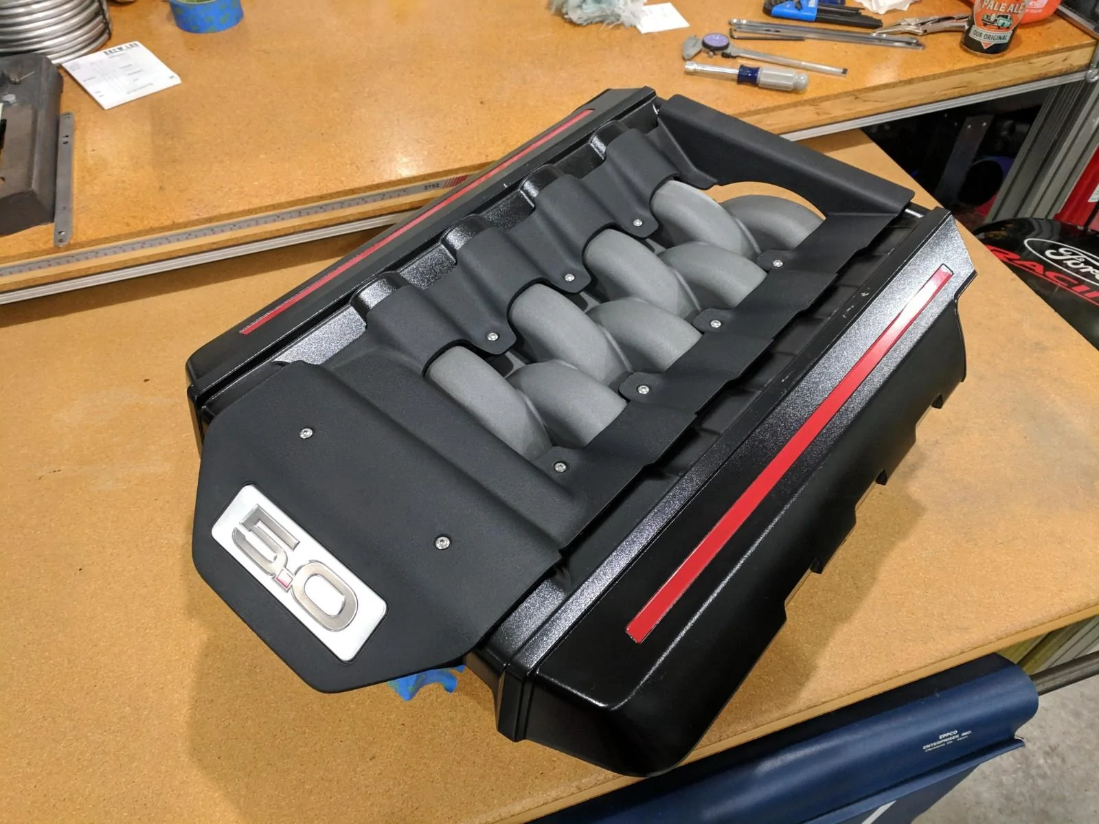

Time for some grommet relocation brackets. Long ago I had bought the setup that a member was selling to mount the intake cover to the GT350 manifold, thinking I might install that manifold someday if the price ever got appealing; then along came the 2018 intake. These consist of a bar that spans the studs on the top of the intake (these mount under everything else that uses these studs), with a grommet tab, and standoffs to space the grommet tab off the bar. The designer/maker of these was a little off on the grommet spacing relative to the stud holes on the mounting bars, so I made an educated guess based on the bore centers of the Coyote and made new ones; the grommet tabs were on the money at least. Bingo. The standoff lengths need to be different from side to side as the threaded stud bosses are different heights (longer on the driver side), and a little trial and error was needed to dial in the lengths to my satisfaction. Here’s the end product, with a very poorly painted intake cover confirming fit.

Fun car season is more or less over here in Minnesota as of this writing since we just got our first blast of snow, so I’ve got a few months to install this baby, along with some 47# injectors and an E85 tune. The wait to play is gonna kill me. And the best part is that nobody poking around under my hood at a cruise night next summer will be the wiser.

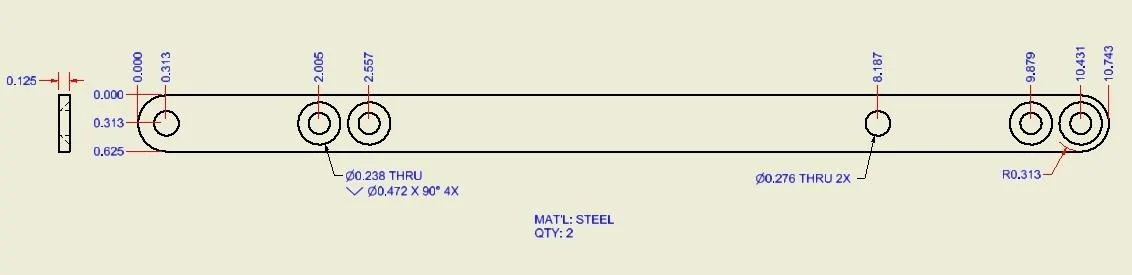

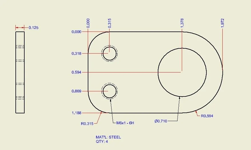

By the way, I have absolutely zero interest (possibly less) in producing these parts for sale, so don’t ask - the demand wouldn’t be high enough and nobody would want to pay what I would want to make it worthwhile. However, here are the drawings for the parts as seen here in my thread in case anybody wants to duplicate my madness. Cheers.
