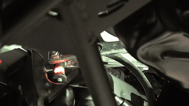

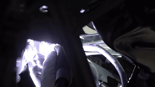

Been installing my Corsa headers today and I ran into a snag while removing my motor mounts. The bracket that's bolted to the block was easy to remove. However the motor mounts are brutal where they attach to the frame. I knew hitting them from the top was an option and I went for it after realizing that using all my force to turn the bolt a hair at a time from underneath was going nowhere.
I had the car on the lift and the engine propped up off the mounts so I didn't want to lower anything. I got up on a ladder and propped the hood up. I used my cordless impact to pop off two of the three remaining bolts. The third was giving the impact a hard time, I was expecting something to shatter. Instead the bolt head stripped and left me repeating every swear word in my vocabulary.
I was going to weld a nut on to it but there wasn't a ton of room. Instead I grabbed a crappy 13mm socket and tack welded it with my tig to the bolt. How fucking crazy is that? The weirdest part was that bolt had the least (almost none) amount of Loctite on it.
So what do you think guys, is this replacement hardware that exists at the dealer? Should I go to lowes tomorrow and try to find a new bolt? I kinda wanna replace three or maybe all four. Three of them took a hell of a beating from the impact gun. I guess I could be funny and weld a nut properly to the factory bolt on a vice hahaha. Ghetto!
Another part of me wants aftermarket motor mounts now...
EDIT: Found motor mount bolts at dealer, part # W713078-S439 and picked them up.
