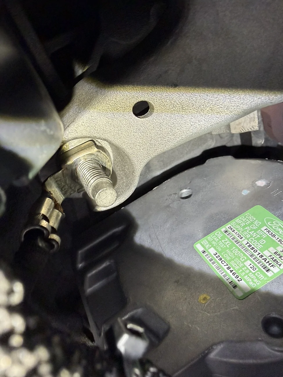

For anyone who has done long tubes or removed the motor mount brackets, has anyone encountered issues with removing the ground wire on the passenger side motor mount bracket? It seems the diameter of the wire attachment is the same as the diameter of the stud and is nearly impossible to remove. I’ve been struggling with it for an hour and it just seems there’s no way to get it off and I’m super frustrated. This is not the part that’s supposed to be difficult.

I'm stuck on this right now! Many curse words and strained arms have been had - namely at the "engineers" at ford. The ground wire hole is the same diameter as the stud and will not come off! I've raised the motor and left it level and still no luck...

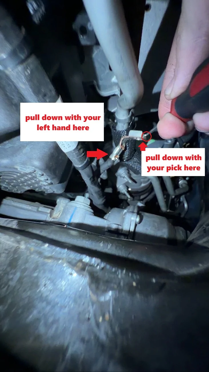

**Update** I finally got it off, spent over an hour trying to wiggle it free with no luck. It almost seemed like there wasn't enough slack in the wire to evenly pull it off of the stud; with that in mind, I went ahead and jacked up the motor, followed the wire to the main loom, and found a bracket with a 10mm bolting it to the frame. I unbolted it and voila, I had more wire to work with! After doing this, I went back and used a 90 degree angled pick to pull down at the front of the eyelet and had my left hand pulling down the actual wire. I basically had to walk it off each thread -- hope this helps anyone in the future dealing with this PITA.
