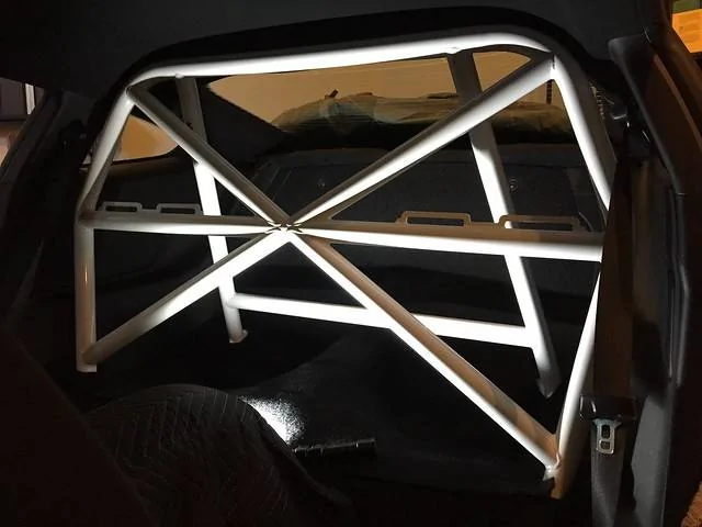

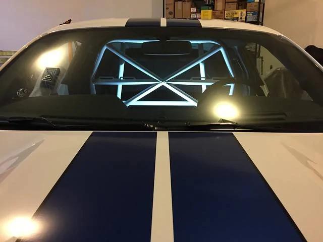

The members on this forum have provided so much valuable information that has helped me so I wanted to contribute for those currently considering a roll bar. I installed a CMS roll bar in my GT350. Quality of the roll bar is very good and aside from variation of the threaded hole location in the chassis for the kickers, install was very straight forward. Patience is definitely needed when drilling the holes into the high strength steel for the main hoop

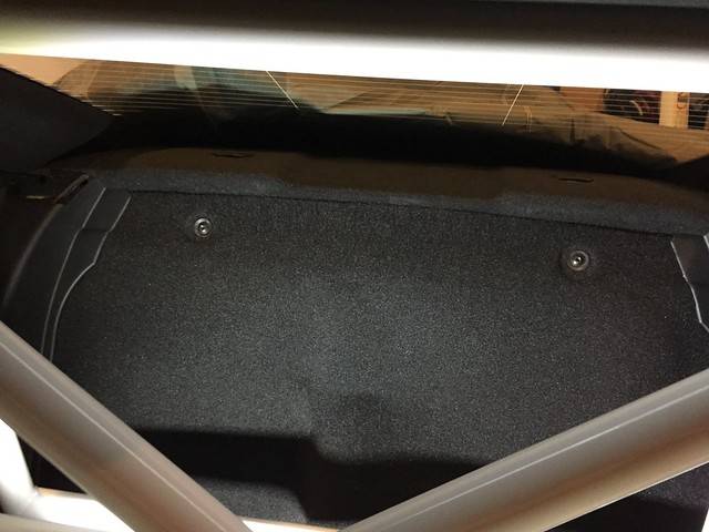

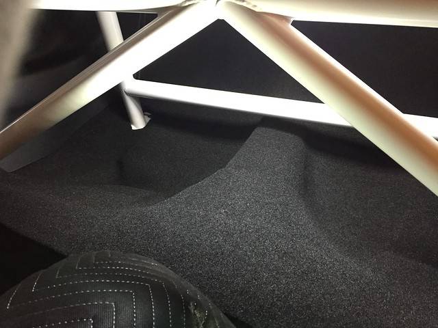

I also installed a rear seat delete. I liked the look of the GT350R seat delete compared the flat panel kits. The reinforced kit mentioned above is no longer available so I used the kit in the below link. Instead of putting the carpet over the plastic side panels, I put it under, which I thinks looks good and holds it in place much better. In the kit, one sided velcro strips are included but it didn't seem like they would hold the carpet in place so I used regular two sided velcro and it worked well.
