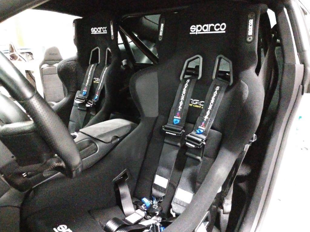

CMS rollbar in shadow black. Using split collars instead of a loop. It wasn’t the best installation ever, but no complaints on the streetability. With Sparco ergo 2 seats, it’s about 4-6” between bar and seat and a slight upward angle. I can’t say the seats dont impair rear vision, but the bar is invisible.

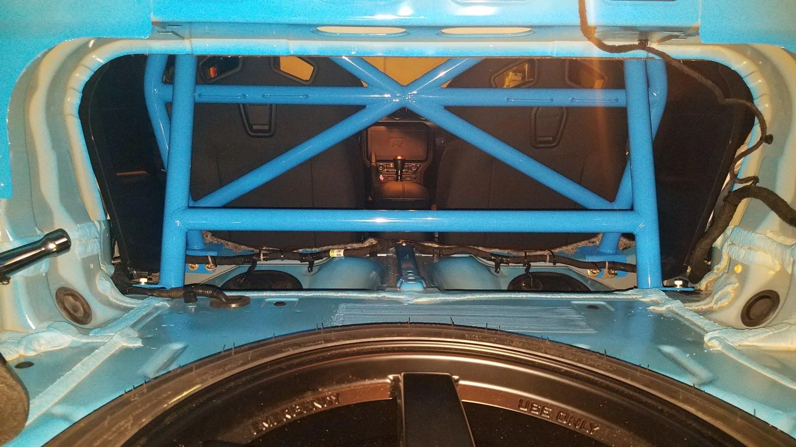

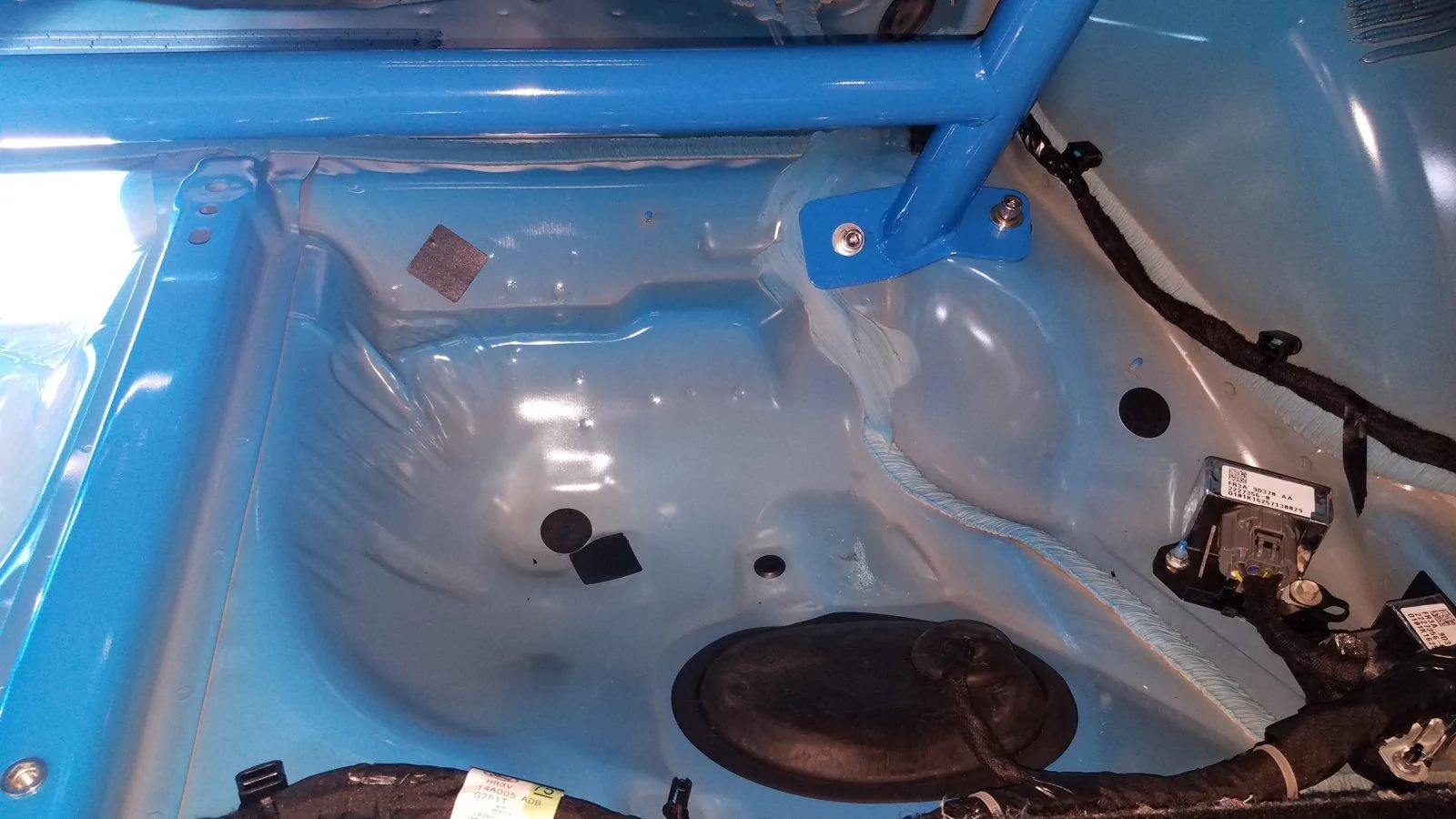

Any closer pics of where the rears bolt up?

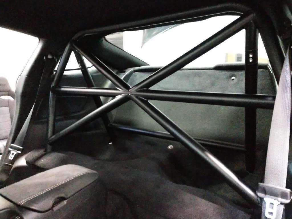

I have a Watson in my car. I install/remove before/after each track day. It's not too big a deal in my opinion to do that. I definitely drive as little as possible on the street with the roll bar in there. The seats don't go back/recline to my normal driving position with the Watson roll bar installed. It's fine on track because then I have the seat more upright and farther forward, but I don't find that driving position to be comfortable for normal street driving.

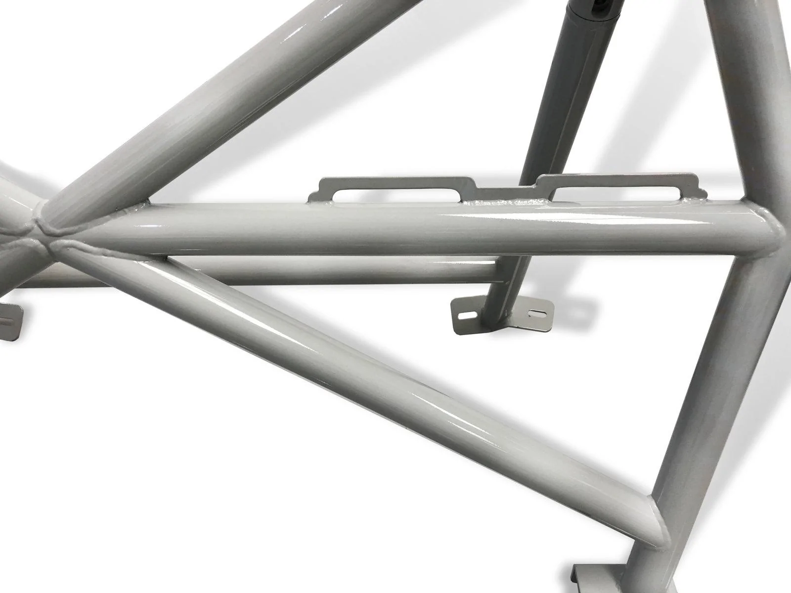

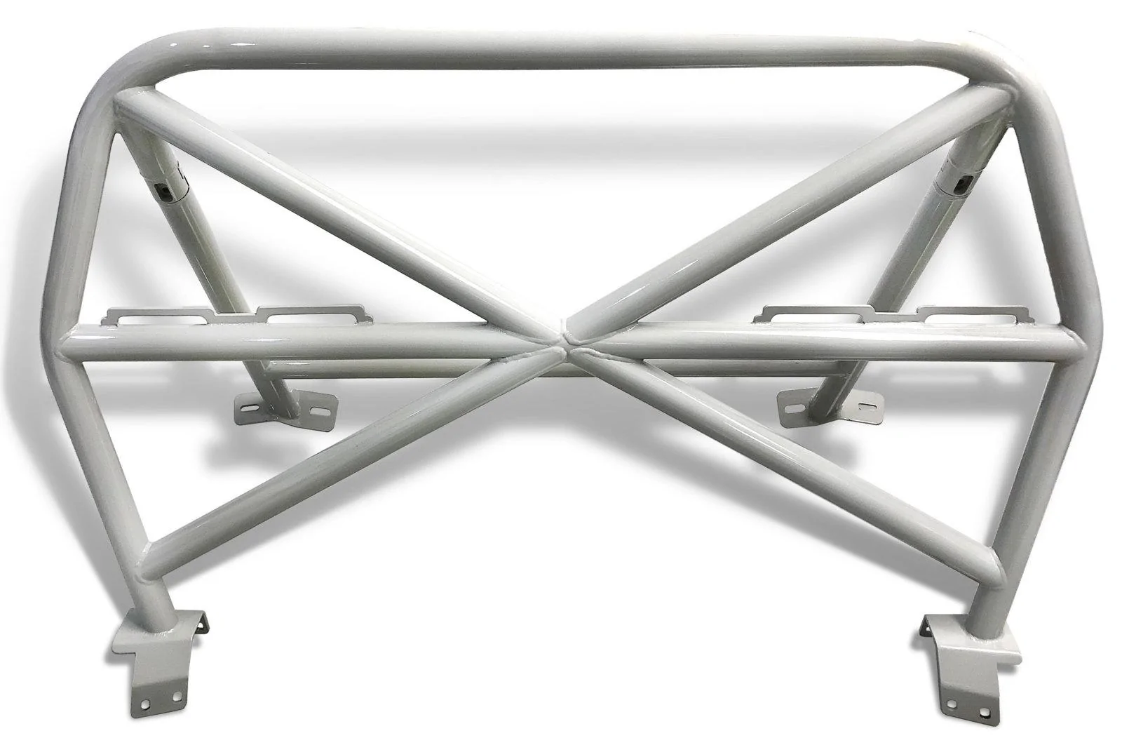

I went back and forth between Watson and CMS. Choose CMS based on there design, color options and install.
Mine has there previous harness loops (more of a round bar style) compared to there new style as shown below in gray.
I will be installing another CMS bar in a buddies 350 this summer which will determine any manufacturing tolerances between them.
CMS fit and finish was great, no issues with seat travel with the stock Recaros.
That looks really nice. Are you running a rear seat delete with that, or left it bare?
Whoa nelly. How long does it take to go back and forth like that?
