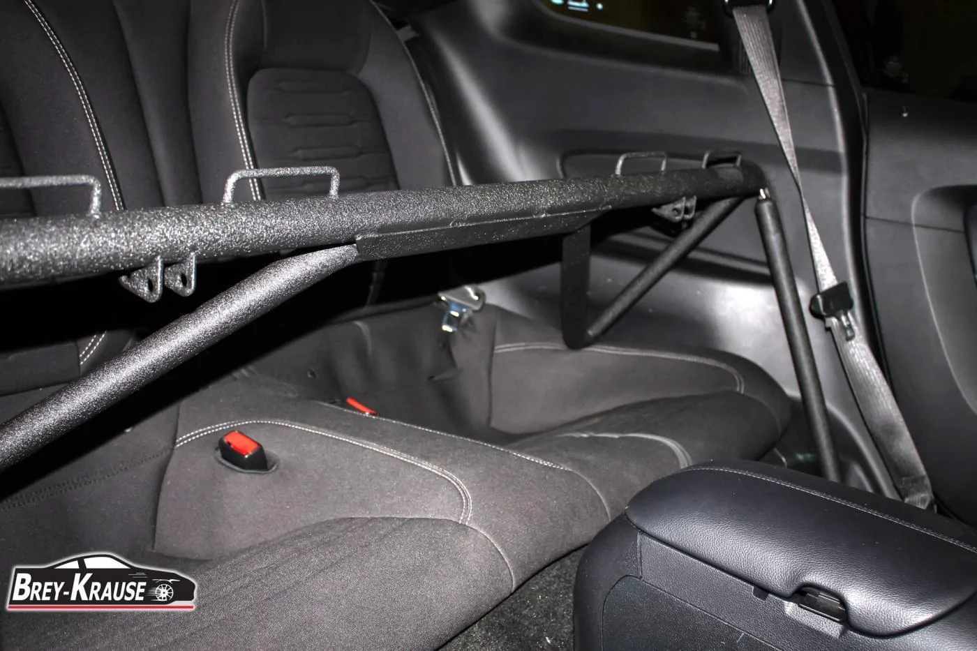

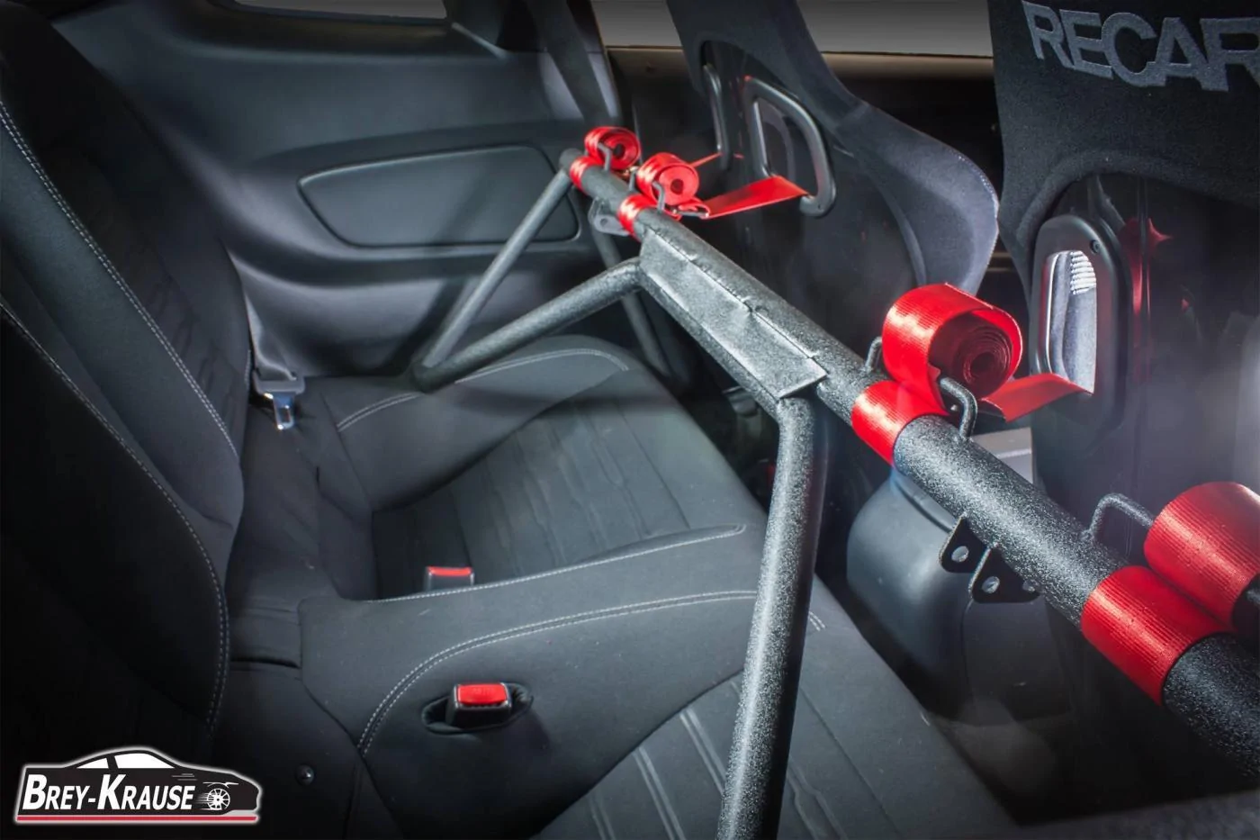

I'm mostly curious on the Cool Tech install of the upright bars.

Can you elaborate on the proper routing of the 6-point V quote above? When you say "around", you mean the legs of the V go on the OUTSIDE of the seat hinge points - the same as the lap belts?
Yes.
Regarding the differences between the two roll bar kits. Most taller drivers are likel to have the seat reclined a notch or two more than they might for the street in order to get headliner clearance with a helmet on. This is the primary reason that we believe that kicking the harness bar back is a good idea - otherwise there could be a serious fitment issues. The fact that we kick this harness bar back and that our kit allows the rear seat to remain in place (or not - owner's choice) are the two main differences between the kits.

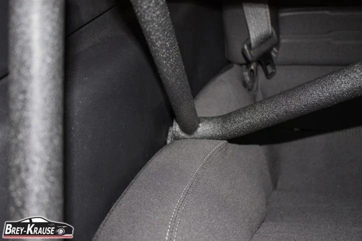

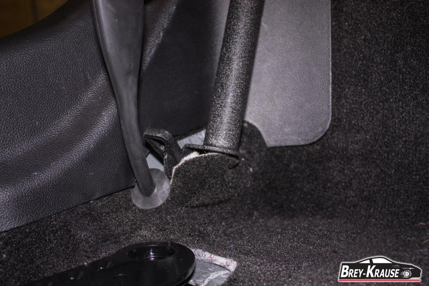

Hey CoolTech,
I'm leaning toward your roller bar but want to see how the front bottom legs are mounted. I won't be able to use them but i'd still like to keep the rear seats in the car.
couple of photos would help. Thanks
