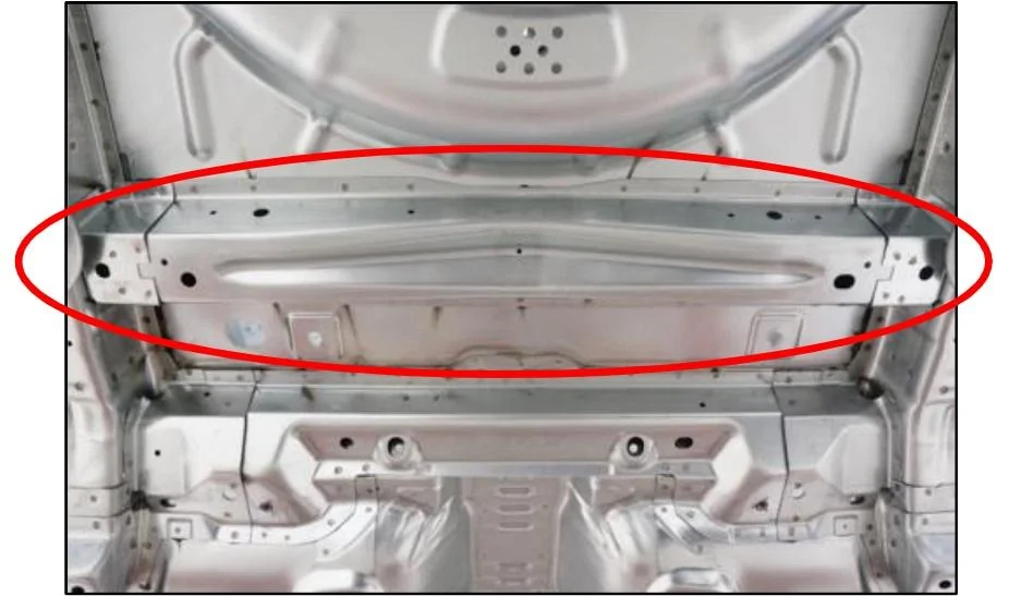

There are a few differences between our roll bar solution and the one from Watson.
1. Main Hoop Attachment: Watson has opted to secure the main hoop laterally to existing bolts in the vertical structure behind the door opening. In our design, we have custom 3/16" steel base plates that bolt to the lateral beam across the car. This beam is almost literally un-drillable because it is high-strength steel but we leverage existing (un-used) holes and some nut-sticks to attach our base plates to the beam. We prefer this attachment mechanism for strength and as the base plates are separate from the bar itself, more serious racers may opt to weld in these plates and this would not effect the powdercoating of the main bar pieces. We think most customers will opt for straight bolt-in but it is nice to know that if the car becomes more of a dedicated track weapon, then these plates can be welded.
2. Perhaps one of the main obvious differences is that our bar will work equally well with our without rear seats in place. Now, we would NEVER advocate having rear seat passengers with a roll bar installed, but we did not want to REQUIRE a rear seat delete kit for GT/GT350 owners. While the OEM offers a very nice rear seat delete kit, it IS pricey and essentially adds to the overall cost of adding in a roll bar. For any of you who have removed a rear seat, you know that there’s not much of a weight penalty – especially over a quality seat-delete kit. We wanted to leave the seat-delete decision up to the car owner.
3. Down tubes. The Watson down tubes go to the floor of the car. Our down tubes bolt into the corner of an OEM box-structure where the vertical component of this structure is for the placement of the shoulder seat belt retract mechanism. This is a strong reinforced area of the car.
4. Harness Bar. Borrowing from the design of our very popular S197 roll bar kits, we kick the harness bar back ~6” to provide room for seat travel and normal seat-back angles. You simply can’t cause the thick Recaro seats to interfere with our bar and, further, you will always have room for your wrap-around shoulder straps. The roll bar is admittedly harder and more costly to construct in this manner, but we believe that ergonomics are important.

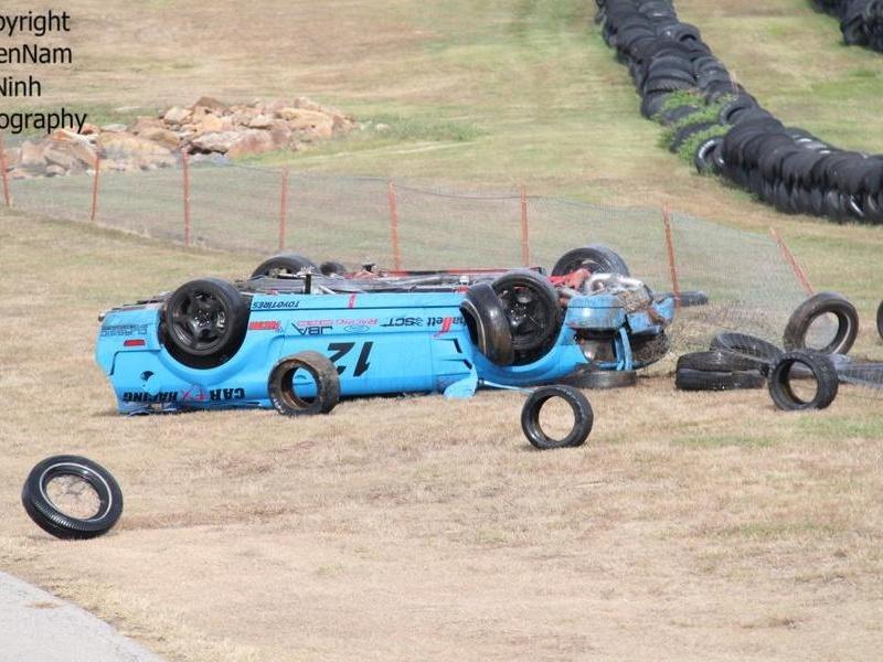

I have no skin in this game, as I don't intend to install a roll hoop of any kind in my car, BUT if I did, this would be the deciding factor for me. Do a quick Google search on "Mustang roll bar through floor" and you'll see why. :eyebulge:
Edit to add the photo and the photo credit, since it's cut off in the photo: ThienNam Ninh Photography

I also don't have either of these bars, but from looking at the Watson install instructions, the rear down tubes do go to the floor of the car directly above a reinforced beam that runs from left to right. This looks pretty good to me...
Watson knows what they are doing. The bad idea is the harness bar.

I remember that picture of the flipped Mustang pretty well. Watson Racing has a LOT of experience and I don't think that they have compromised their mounting location. I wasn't trying to make the comparison that our downtube placement was any stronger than Watson - only that our placement allows the rear seat to stay in place. Both our CoolTech solution and the Watson solution place the main hoop on the structural lateral beam and so the potential for punch-through (as shown in the pic) is practically impossible.
