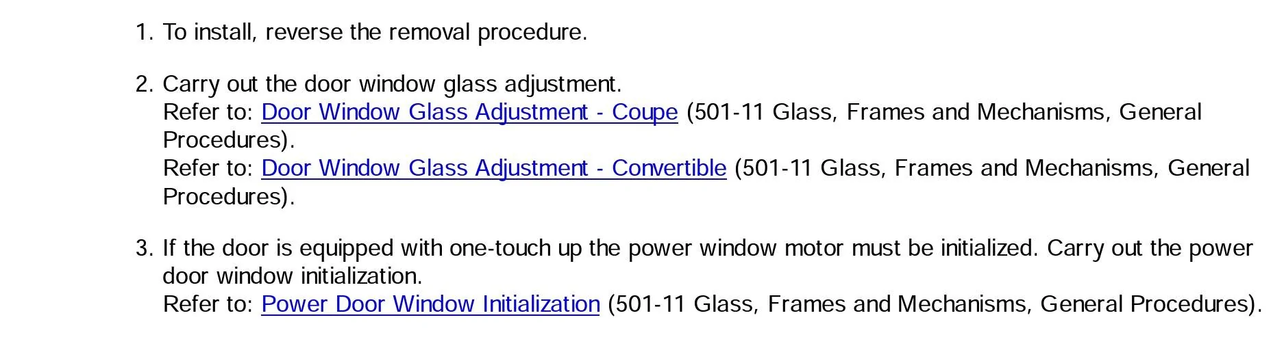

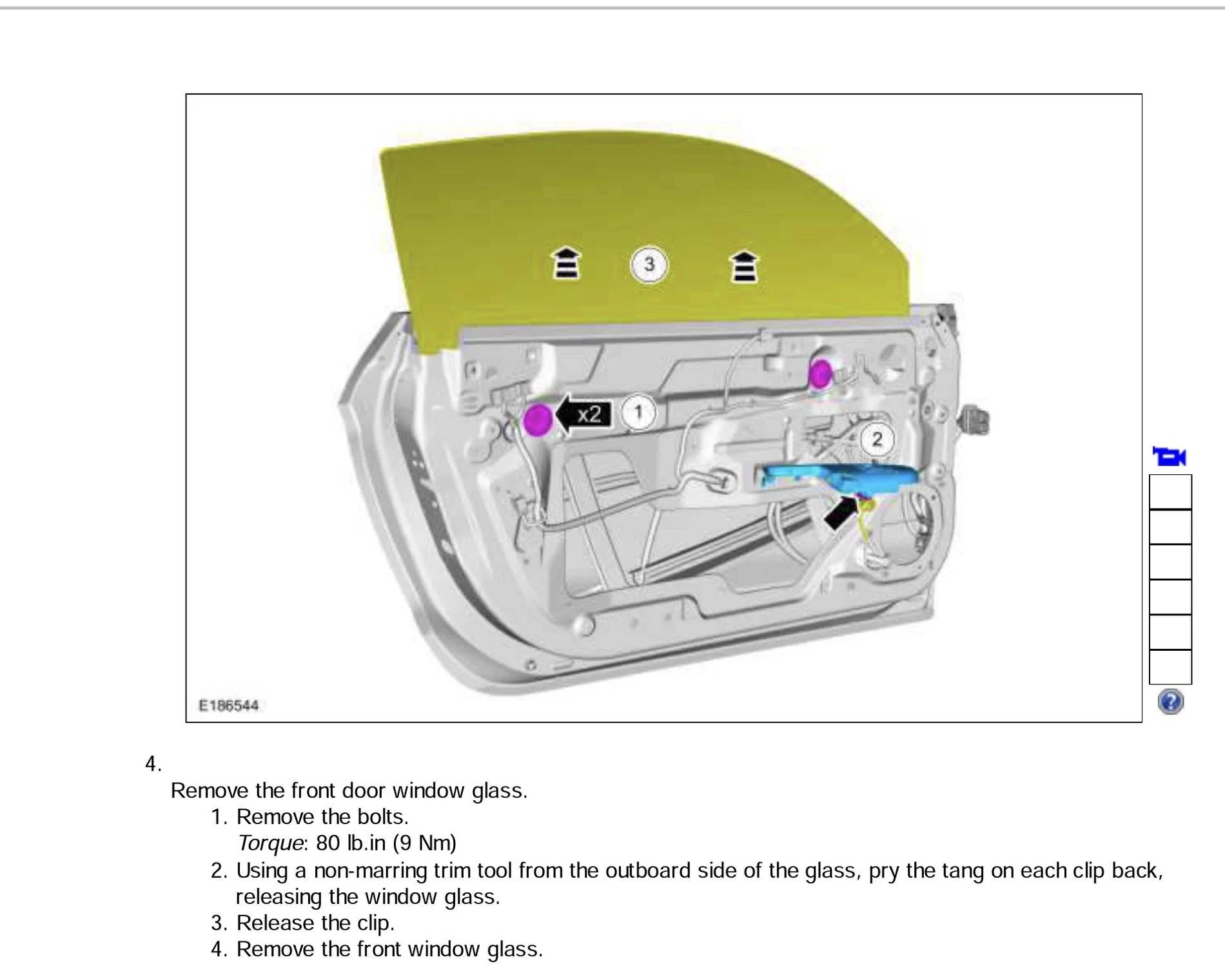

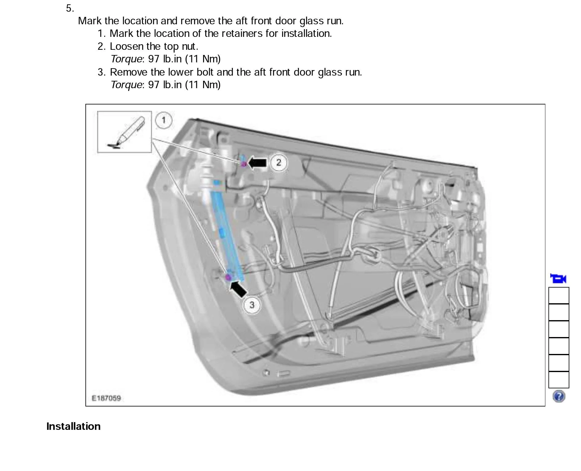

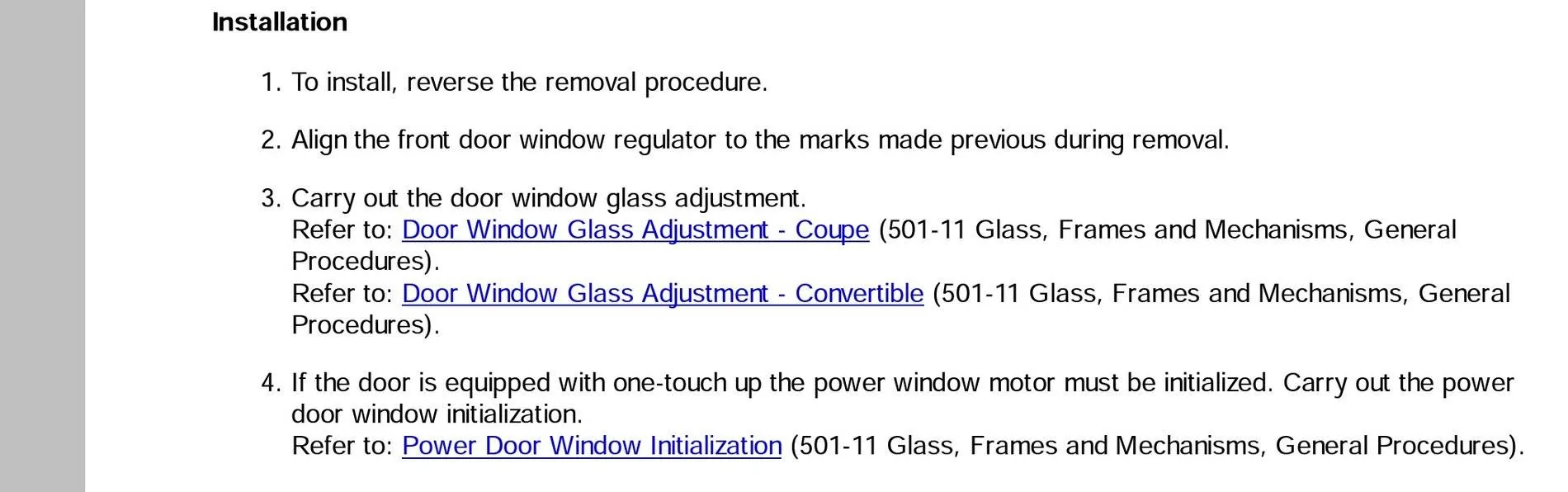

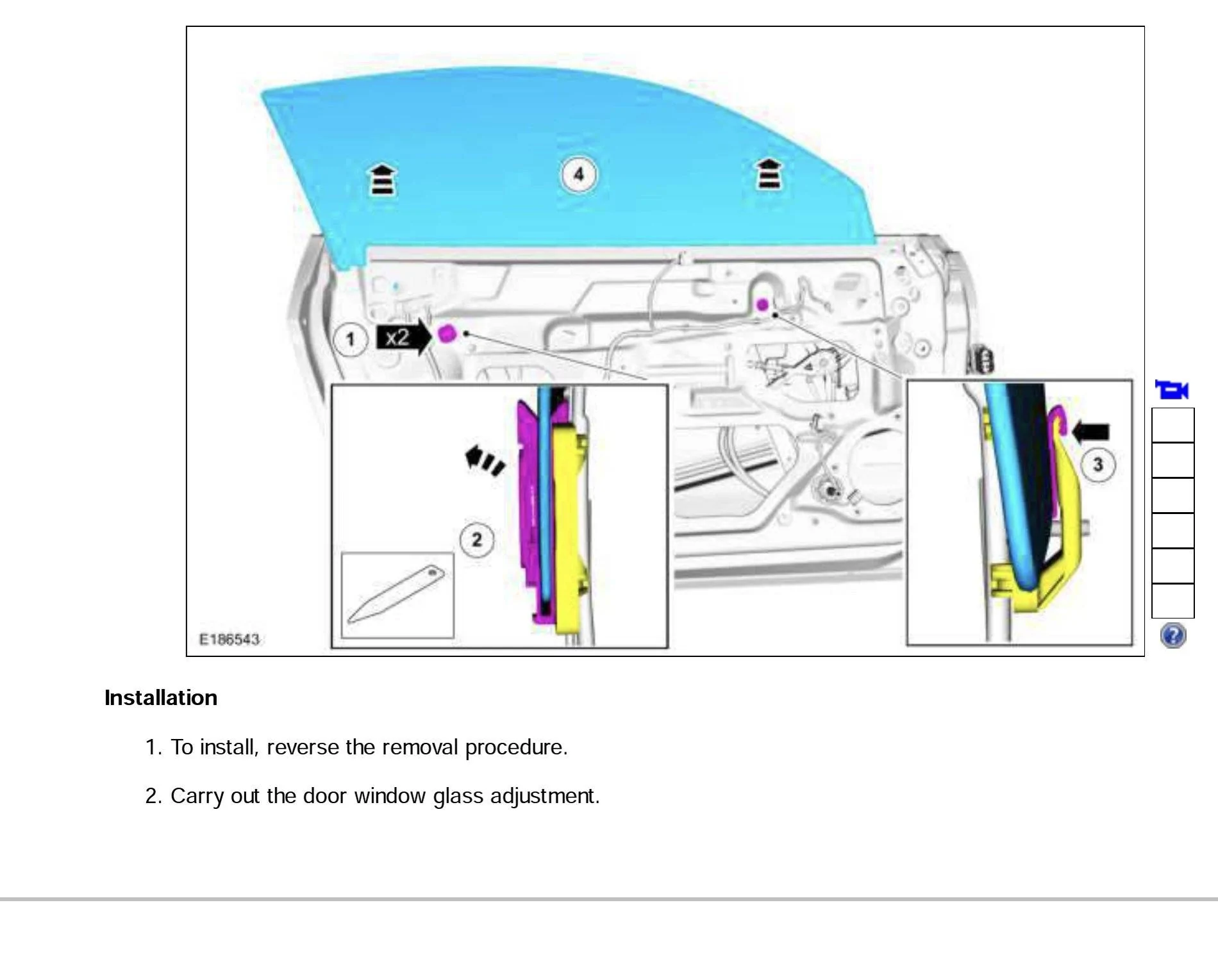

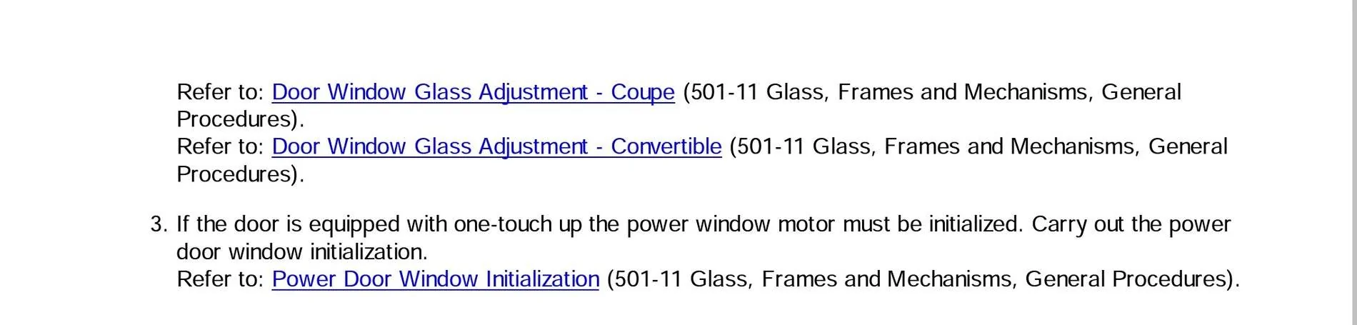

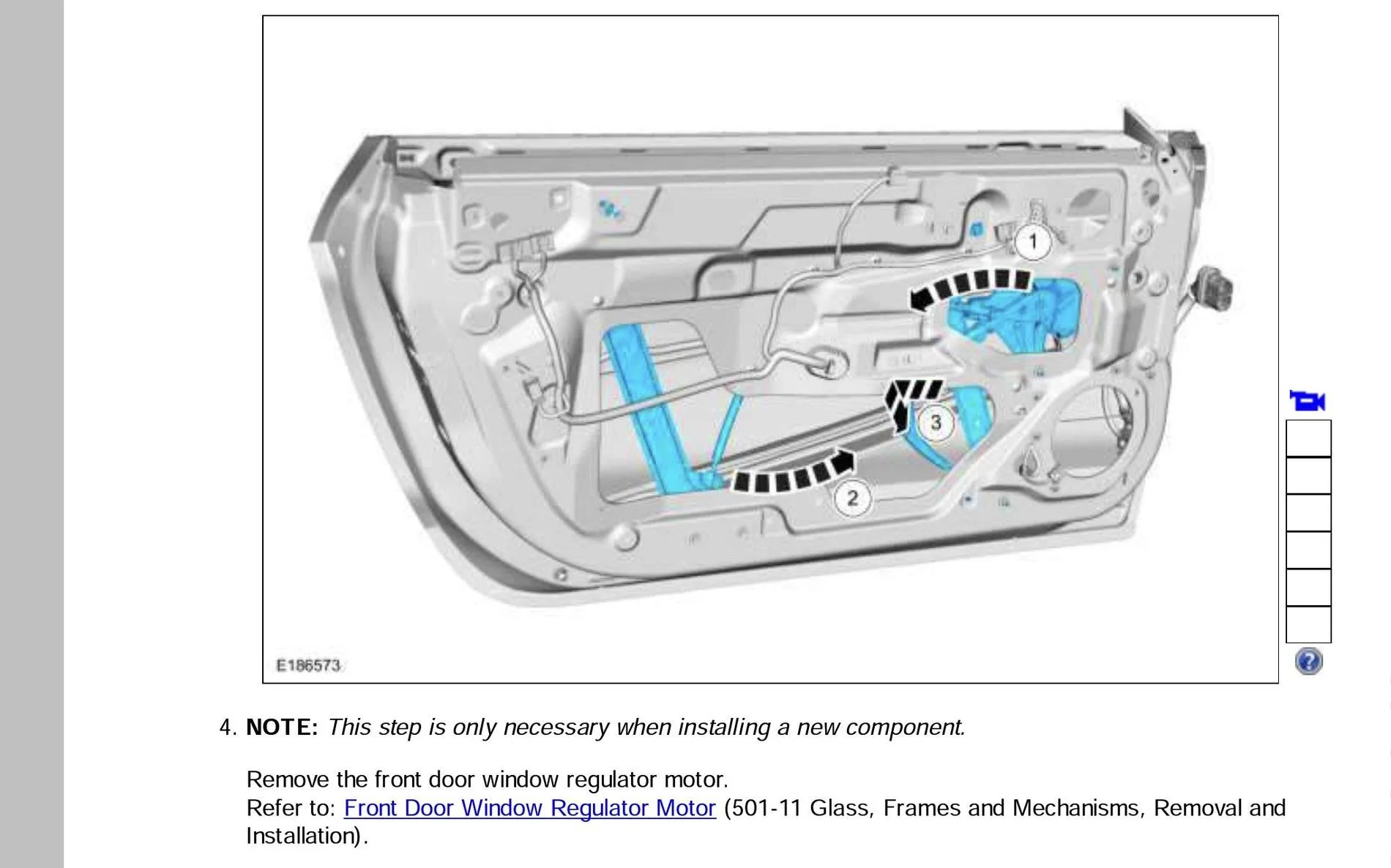

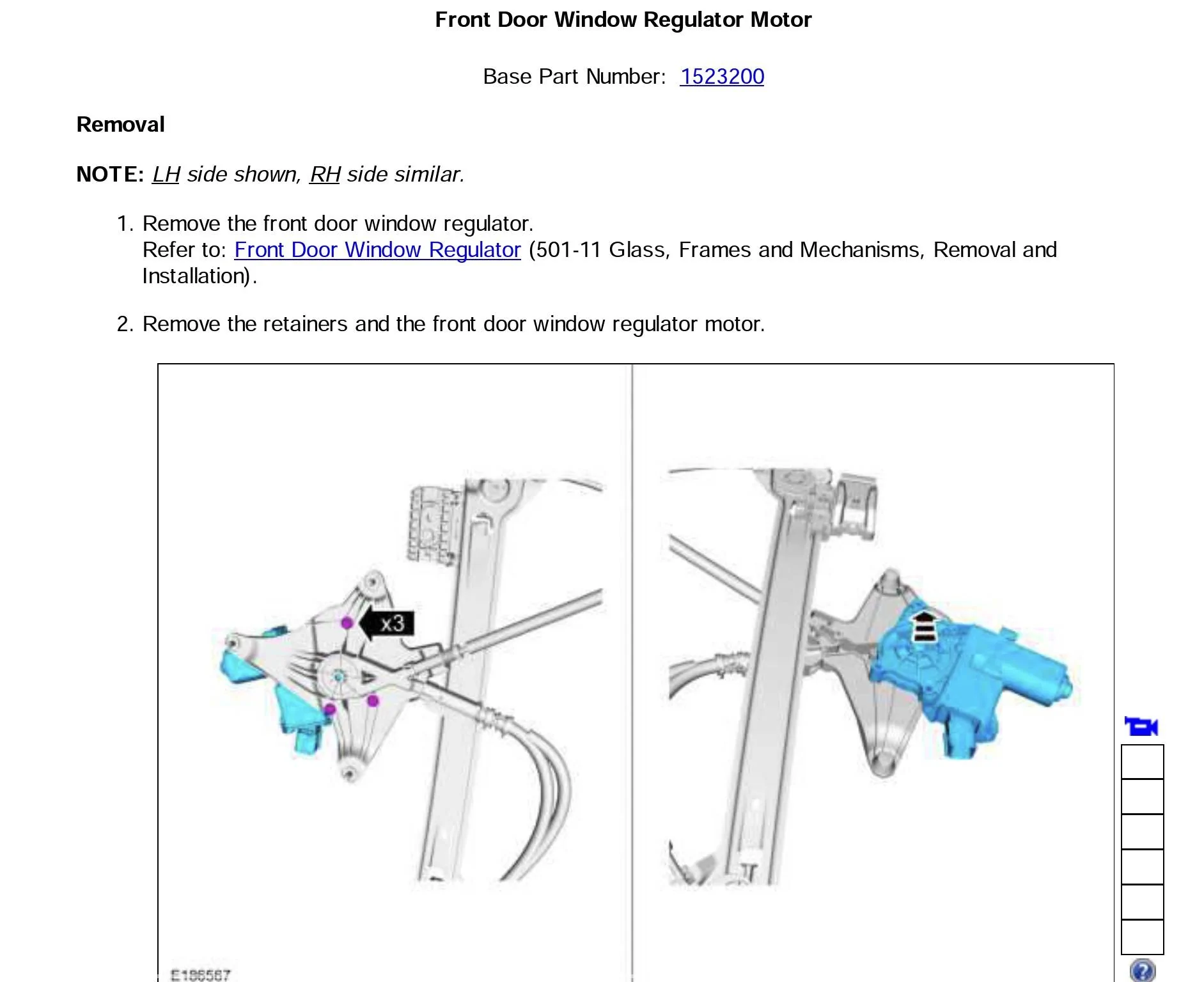

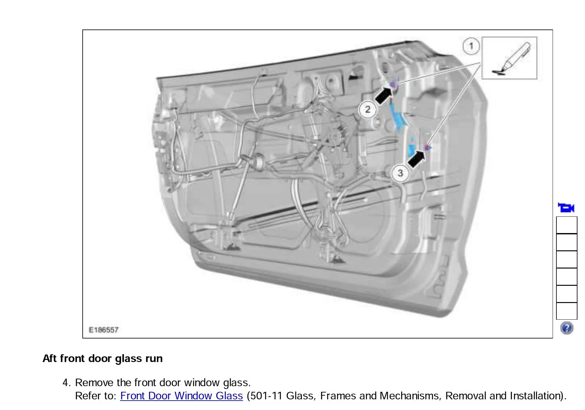

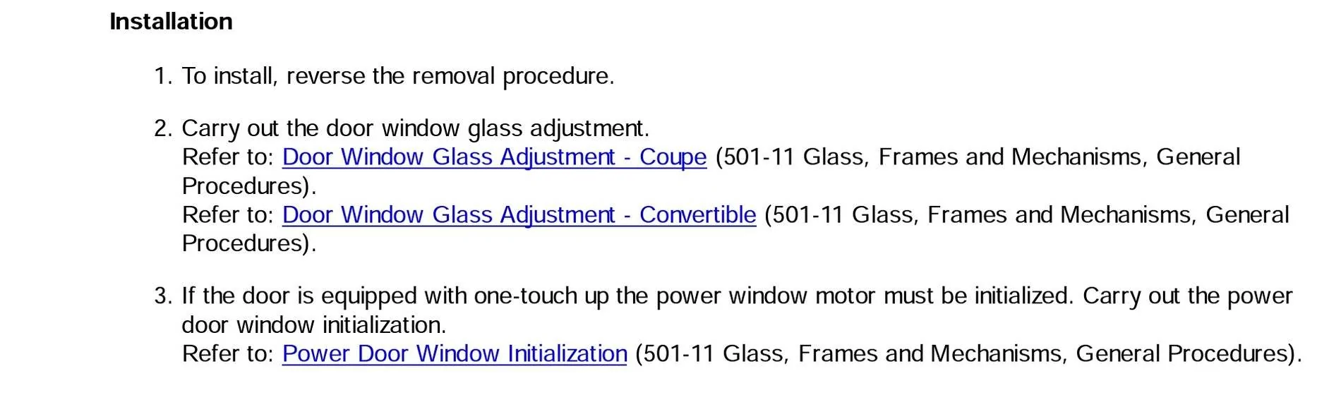

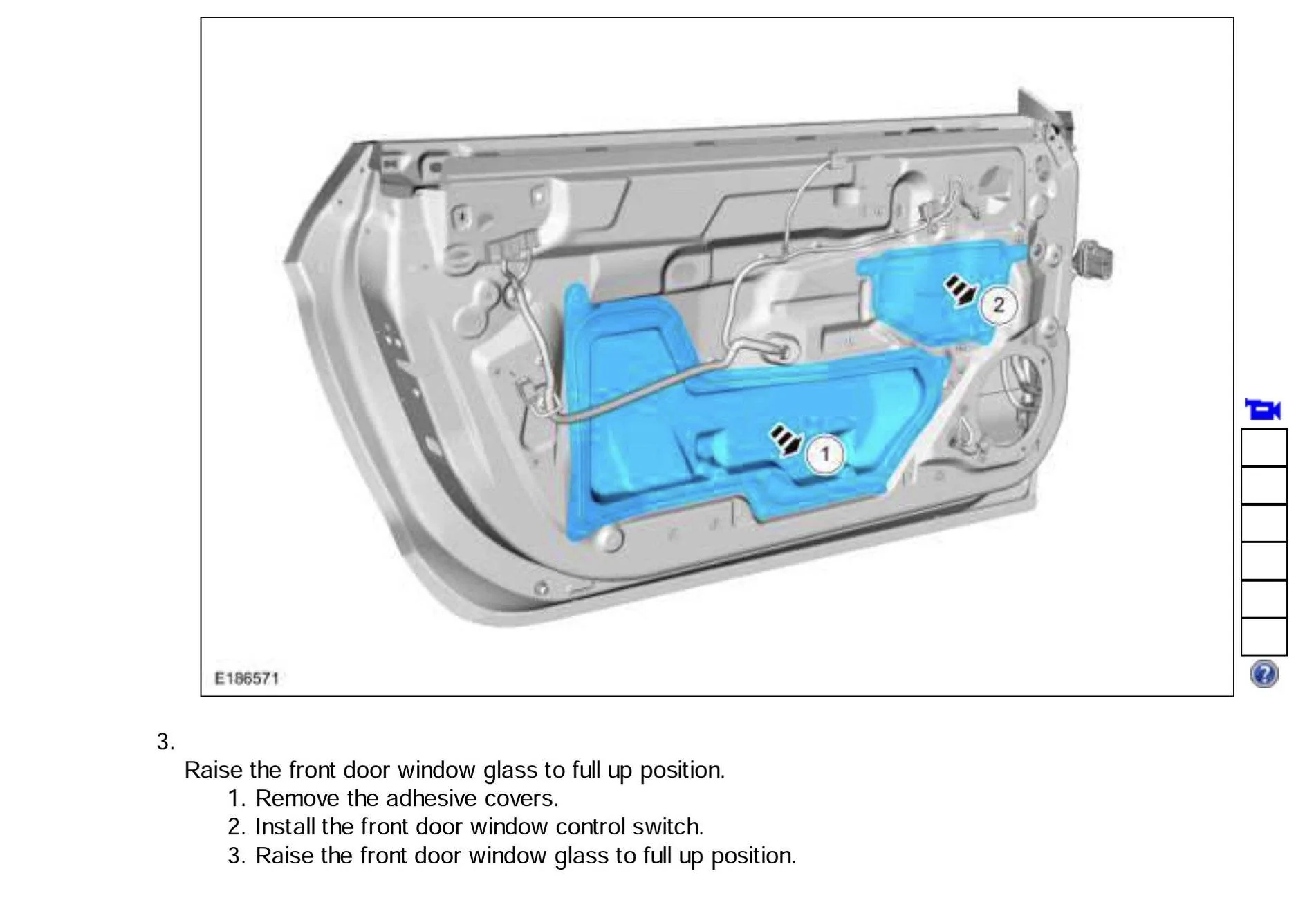

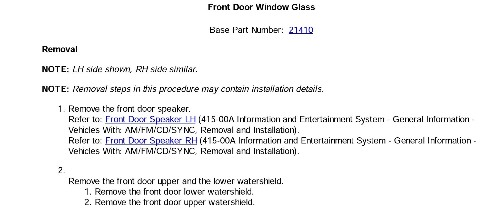

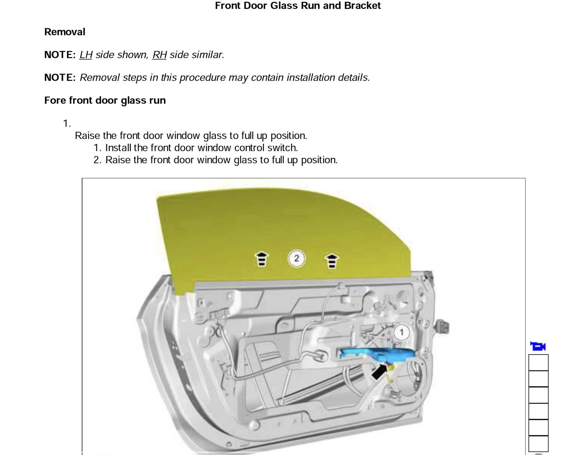

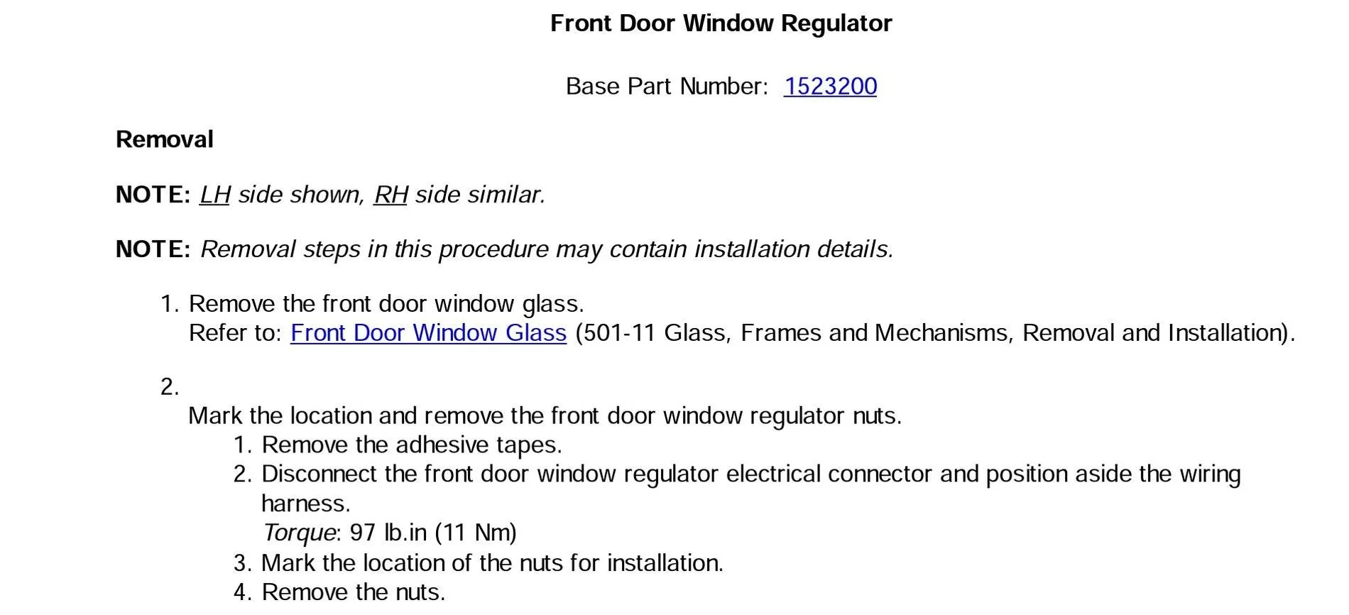

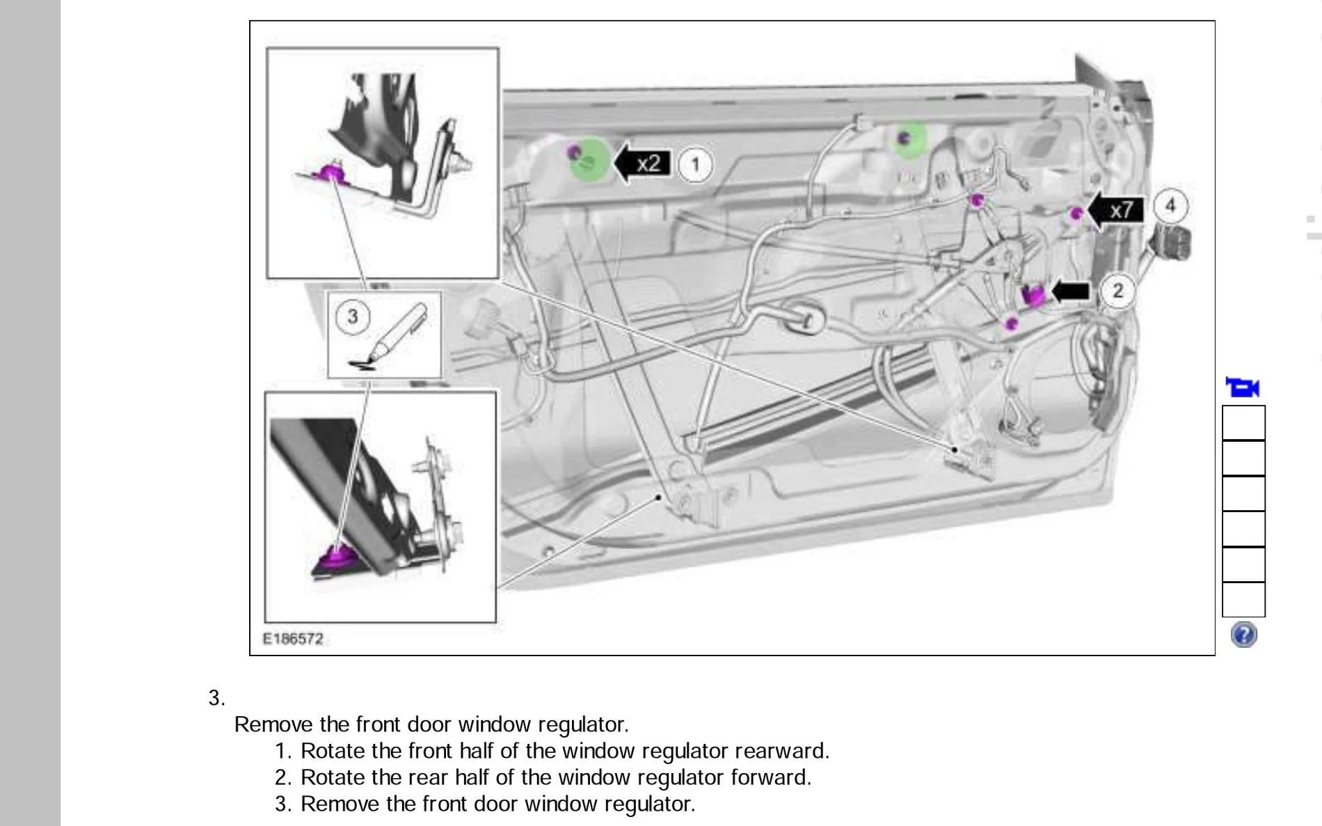

Here’s all the info for the door internals IF you want to try and diagnose by yourself:
If one tries to adjust or fix any of the above components in the aforementioned sections above (EXCLUDING just the window motor), it’s quite possible the door glass could then be misaligned - which is an entirely whole other tedious procedure to realign (ie: many steps).
Window motor R&R won’t affect glass alignment.
