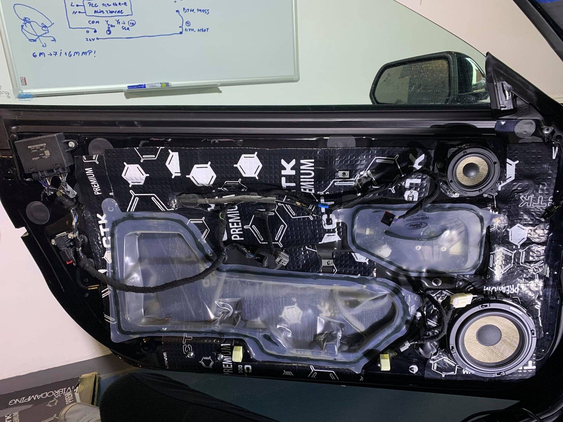

Thanks for your input. I was trying to avoid the realignment because looks really complicated. I'm also hoping that vertical alignment and the rattle are two different issues. I also added (perhaps exaggerated) with sound deadening, covering most of the holes...
I'll let you know how it goes.
