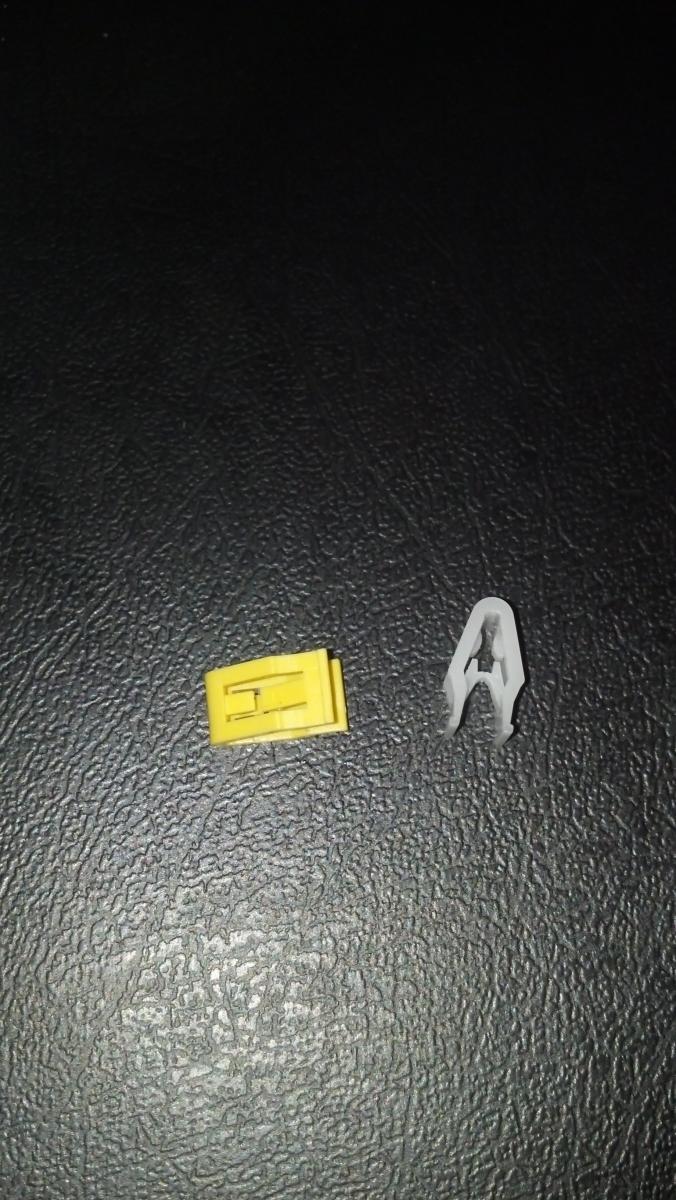

There is probably a dozen clips on the aluminum dash piece and 6-8 on the console. There are anywhere from 2-5 on every plastic panel in the car that you have to remove. There are many different color clips but they are all physically the same, only a different color. PN is W717661-S300
http://www.mustang6g.com/forums/attachment.php?attachmentid=19738&d=1422923429

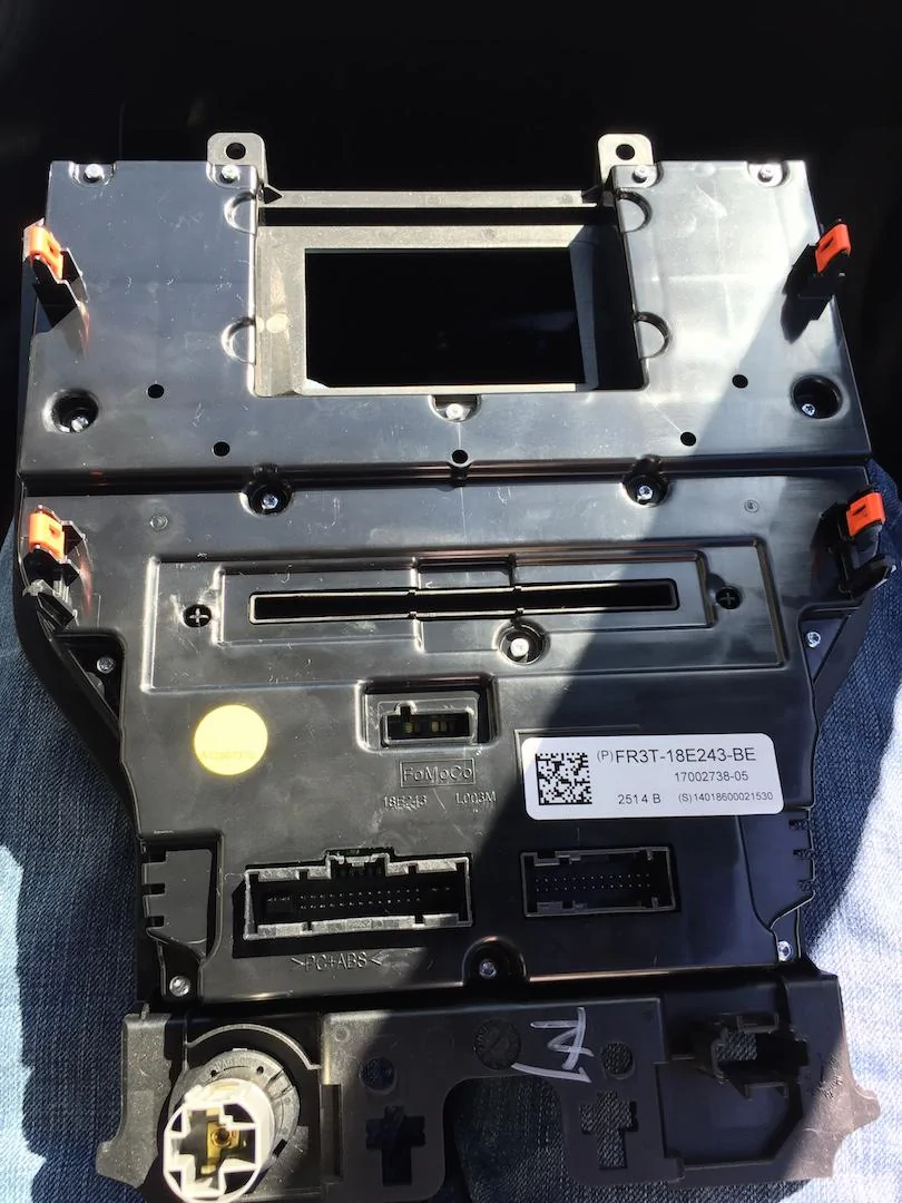

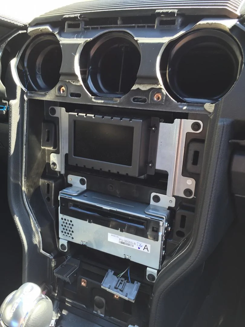

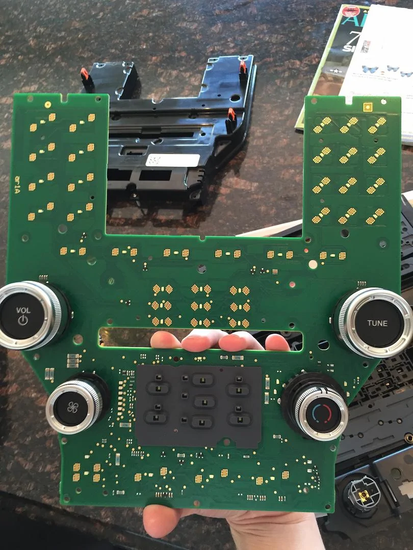

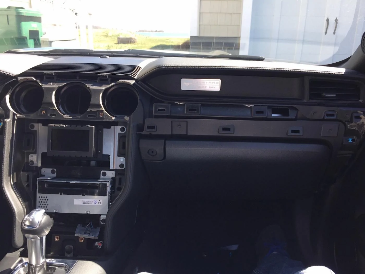

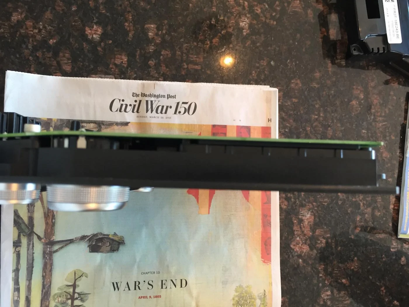

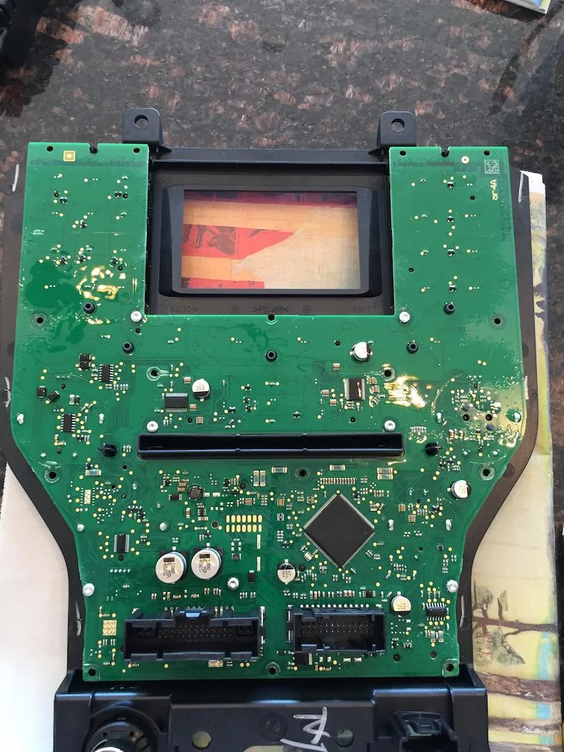

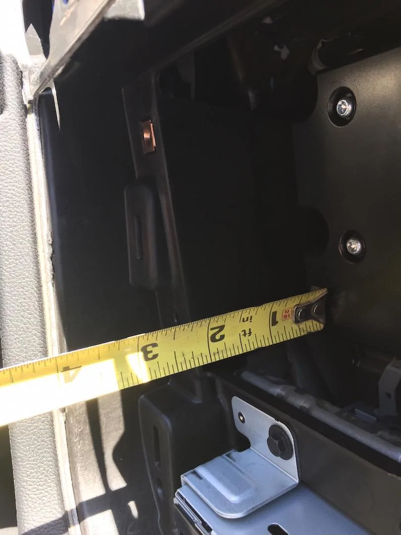

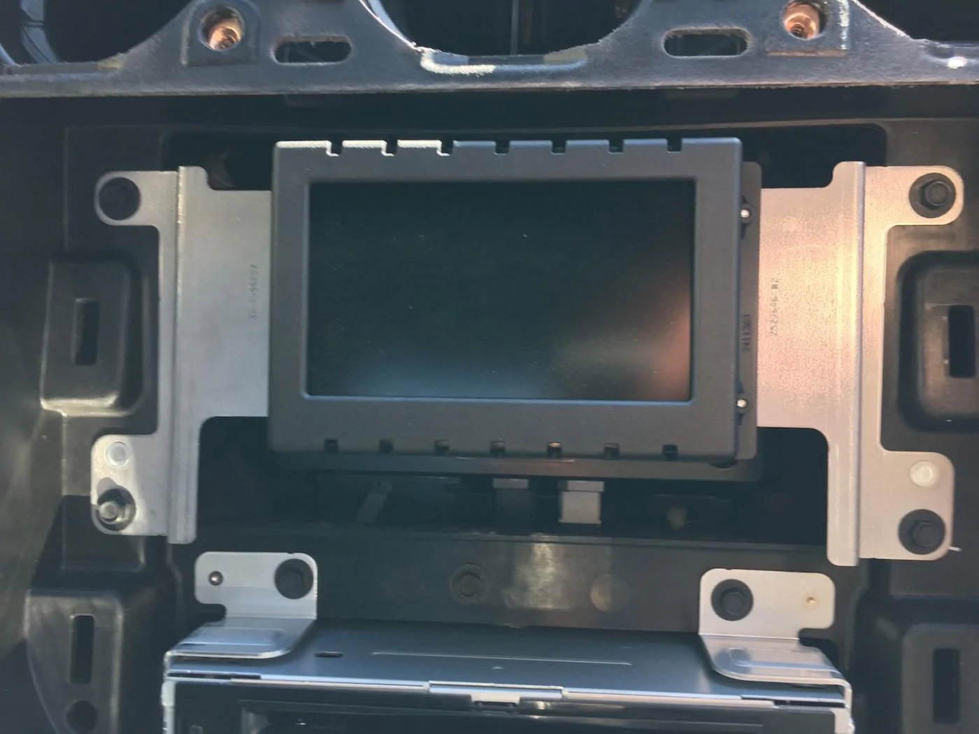

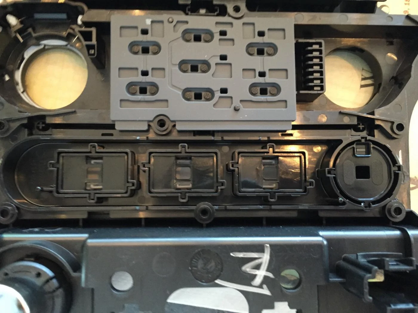

So you guys wanted to see more of the base model center stack? :D
Unfortunately it is all one board so aftermarket companies will need to have climate controls on top of the push button start. The nice surprise though is that the base model buttons are not attached to the board! There MIGHT be a way to get the toggle switches on the base model!
Cutting the board might not be the best option... There really isn't a nice partition of electronics like I was hoping there would be.. I think it would be possible though to fit an lcd screen in front of the board by removing the buttons and mounts. There is about .75" of space between the board and the face of the bezel.

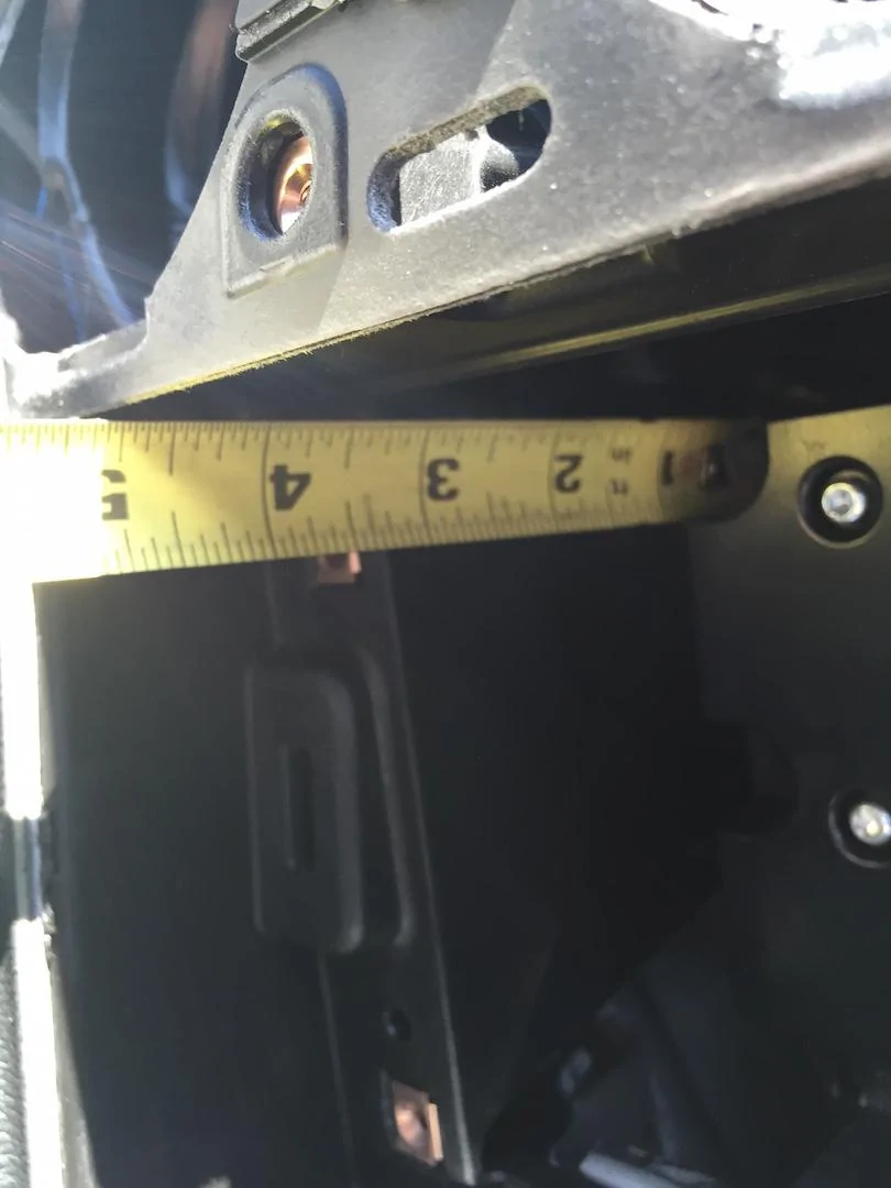

Now onto dimensions for a 2 din unit... In order to have a 2 din unit in place of the screen you will need to relocate the sync module. There is only about 3.75" between the module and the panel. With the module relocated you will have 5". You will need a shallow 2 din unit.
