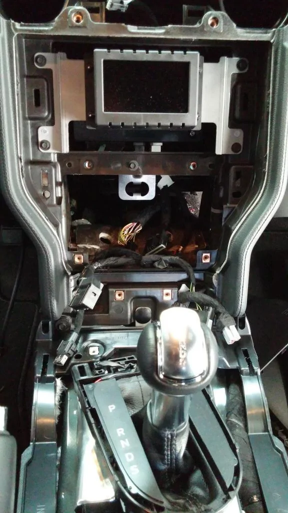

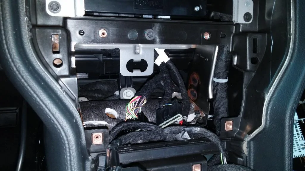

Zack, do you think there is room for a big box just smaller than it's 7" diag. screen to slide into the space 'right' above the knobs and going maybe 6" back?

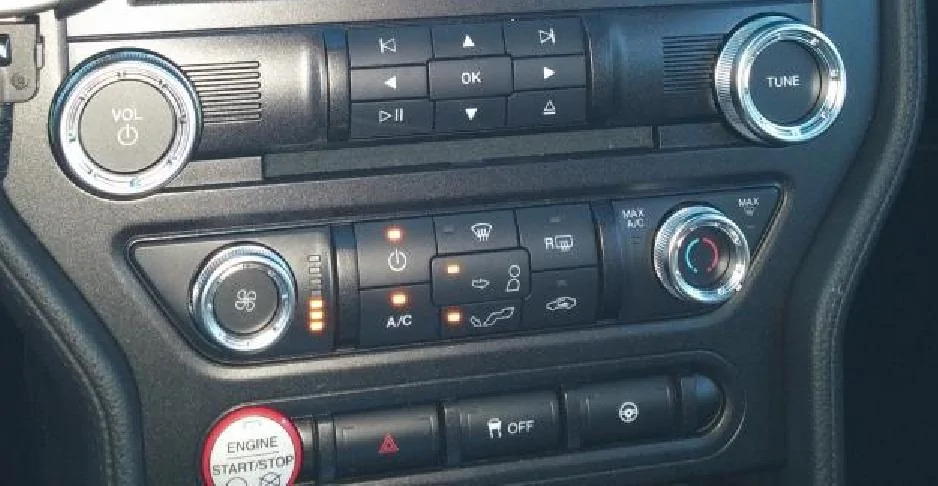

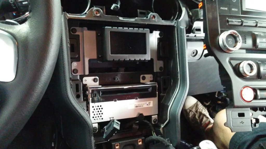

Even with open center stack pics (from ecosnake), I am confused what would/could be deleted with a new 7" touchscreen installation (like an 8001). When I spoke with a tech at Scosche, they said they have to figure out how to incorporate an adapter that included climate controls. So that implies that the 7" screen would be in the area where the Vol & Tune knobs are as well as the climate controls below that. Does the 4.3" display need to stay? If so what would it do differently than stock??

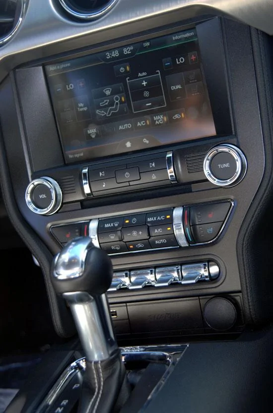

The last picture is of the OEM MyTouch 7" screen. "IT" gets to be in place of the 4.3" screen. Why wouldn't an aftermarket unit go in the same place? I know I am missing something here. :headbonk:

Well remember a circuit board is just a collection of electrical circuits connected by "wire" if you will. Depending on how the control board is designed it might be possible to modify the stock center stack to accept a 2 din unit. If the electronics are partitioned like the buttons then it should theoretically be possible to cut the control board just above the volume/tuner knobs. From here all you would need to do is make a mount for your 2 din unit to slide into. The mount could screw into where the stock 4.3 display is mounted.
Like I said before, if the control board is partitioned nicely then everything south of your cut line should function as usual. The buttons work as resistors... Every button has a different resistance value that the computer reads as a specific command. The only real power going through this board is used to drive the backlighting. So cutting the board shouldn't be much of an issue at all.
I would buy a replacement board from Ford parts and then attempt to modify one. You can plug it in and test out its functionality before proceeding and if it doesn't work you still have a fully functional board to replace it with.

There is certainly room to place a 2 din unit where the factory 4.3" screen is mounted. The issue would come in the fact that on the back of the 4.3 screen bracket the sync module is mounted. You would need to relocated the sync module if you were keeping it. That shouldn't be much of an issue at all though. The center stack bezel is the major issue at hand.

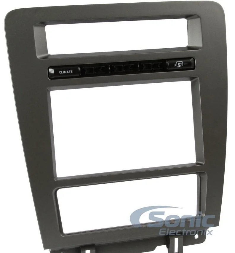

I have no idea what an aftermarket center stack bezel would look like for a 2015. Here is one for a 2014. I think one of the two (top?) smaller areas was made to just be a storage pocket, IIRC.

The top one was for the original screen. I had to be kept for for some reason can't remember if it was sync or something else. The middle one was for the head unit, and the last one was for climate controls if I remember correctly. I'm sure about the first two just not the last one.

Just looked it up the last one in most cases was just extra storage
