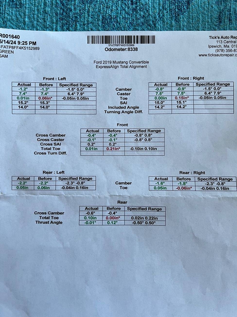

I’ve recently bought a 2019 Mustang GT premium, manual transmission, absolutely love the car! Originally the car ca, with the 19” wheels and tires and the po removed them for the optional 20” wheels and tires. Ive noticed darting at highway speeds and kind of wandering at lower speeds. I had a 2015 Corvette with Z51 option, and that car would track a bit, following the crowns in the road at times but nothing like this.
The car has only 8,000 miles on it and the newer tires and wheels about 4,000 miles.
So I had the car aligned, but it still does it. A little Improvement but still not right. A friend said the factory settings might have to be adjusted and more “toe in” would fix it. Any help? Ideas?
Thanks !

I would not add more toe, these cars eat front tires and more toe is only gonna make that worse.
Let’s start by seeing the paper the alignment shop gave you, that will help us debug

I would be fine asking for very slight toe in (like 0.05" per side in the front). It will help the dartiness. Ideally you don't need to do that (0 toe should be ok), but its a sports car, and if you think its too darty, without micromananging your tire choice, some slight toe in is fine.
You could use a little more toe in in the rear (0.1 per side)
And your rear camber is too much on that right side. Get it down <2.0.

I agree with nightmaremoon.
.05 toe in in front both sides equal for a total of .1
Rear .1 on both sides for a total of .2
Rear camber <2 equal on both sides. Yes it is adjustable.
