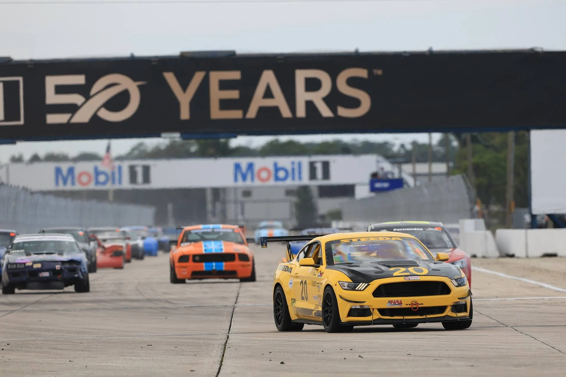

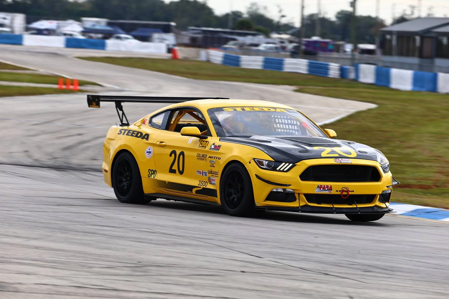

What a great Weekend! Won both races. The New Steeda Suspension Components held up well.
Special Thanks to Team Steeda!!
