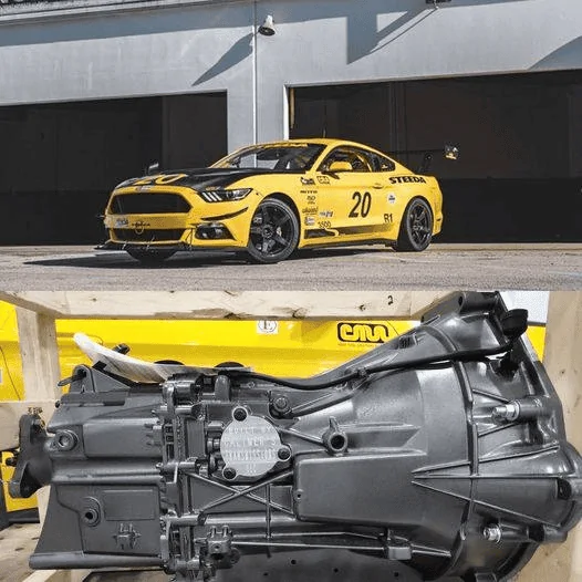

Our team just posted this on Facebook for those that are following along:
New Calimer Gear Box for the #20car!

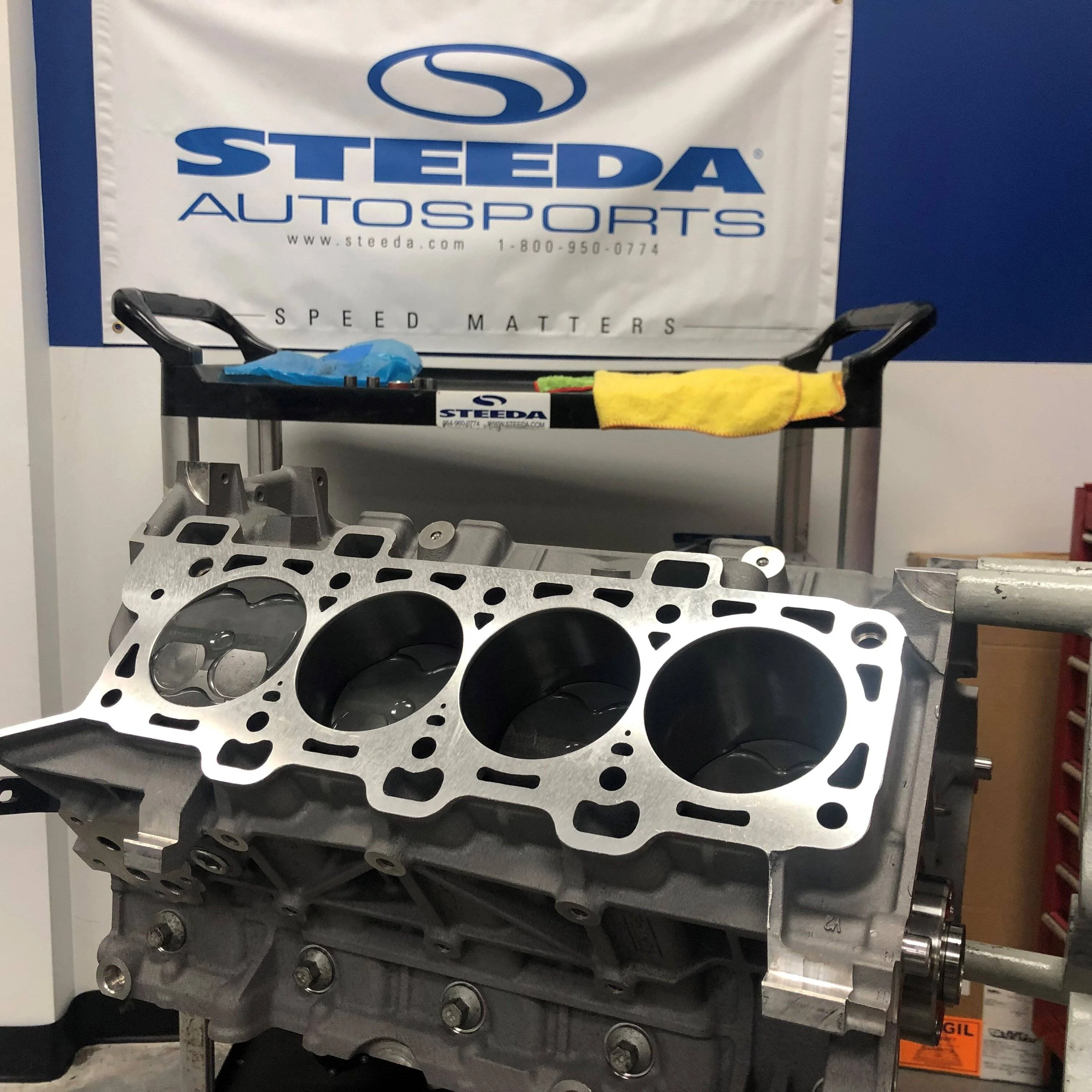

New Coyote Engine for 2023 !
