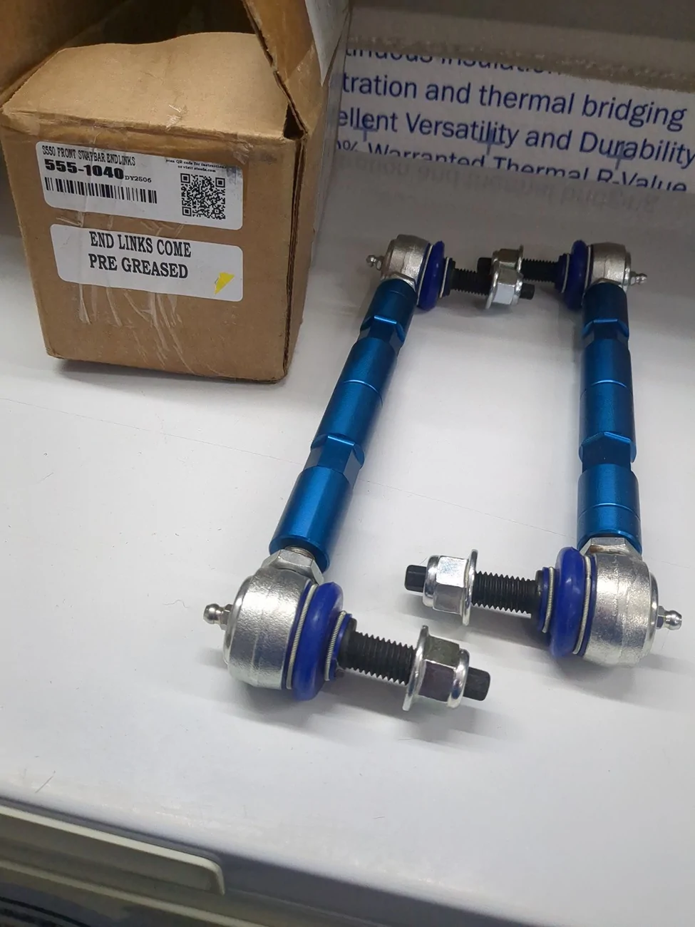

Good Day Steeda Tech , I keep up to date on your components and the likings of all here on the 5star reviews. I currently have a 21 Mach1 I'm keeping Stock , but a friend gave me brand new front sway bar links , I've had for a few months. I figured better on the car than on the shelf in the original box they came in . Should I install them , will they change the alignment, will they advirsely effect the suspension, is this a straight forward installation , or should I sell on eBay. Thank you .

I’d install them. The fact that they have grease zerk fittings makes them an improvement over the factory links.

Hi, endlinks won't change your alignment. Here is a copy of the install instructions: 555-1040-installation-instructions-v2.pdf

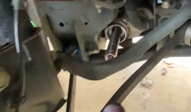

I reviewed Steeda’s instructions for these and they only show the driver’s side (smooth side of steering shaft), being installed. The instructions fail to mention and/or show that the passenger side portion of the steering rack shaft is a ball screw design. Installing these limiters on the passenger side would mean they have to clip into the valleys of the screw shaft, which would make them floating and there would be space between each clip because of the peaks in the screw shaft which would seem ineffective. Will you please post pics of the passenger side being installed? Thanks

I reviewed Steeda’s instructions for these and they only show the driver’s side (smooth side of steering shaft), being installed. The instructions fail to mention and/or show that the passenger side portion of the steering rack shaft is a ball screw design. Installing these limiters on the passenger side would mean they have to clip into the valleys of the screw shaft, which would make them floating and there would be space between each clip because of the peaks in the screw shaft which would seem in effective. Will you please post pics of the passenger side being installed? Thanks

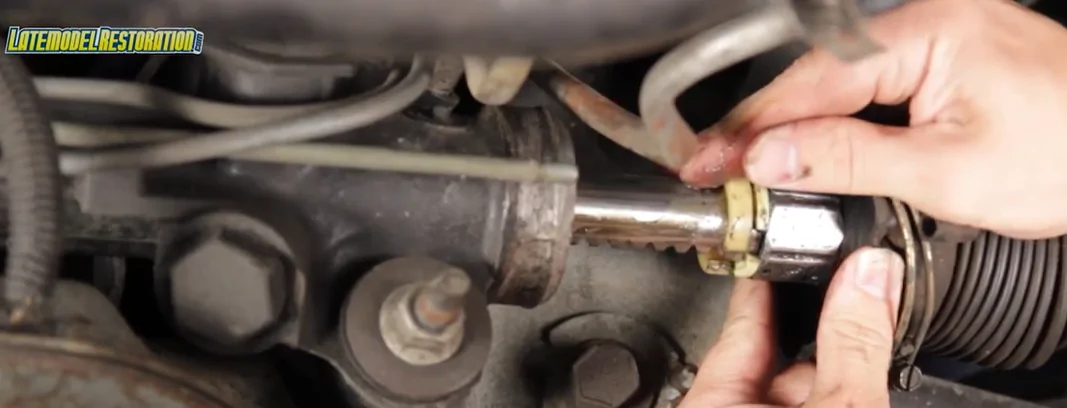

The spacer should not be sliding around back and forth on the rack. If it is clipped on and pushed to the end of the rack, it should stay there so there would not be any wear on it.
The only time it will be touched is at the new full-lock, which will just push it against the end/base of the tie rod end. That is the same like Fox/SN95, you clip them at the outside end of the steering rack shaft.

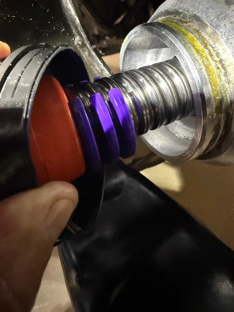

Thanks for the pics and explanation TJ, but I still don’t think these will work on the passenger side. Imagine the ball screw shaft design with spiraling threads. The clips can’t butt up flat against the factory stop because they are following the threads and that creates a gap between each clip. When they hit the inside of the steering rack, they will likely pop off one by one, which can lead to other issues. Take a look here for reference.
They will work very well on the driver’s side, but the passenger side needs to be readdressed IMO.
