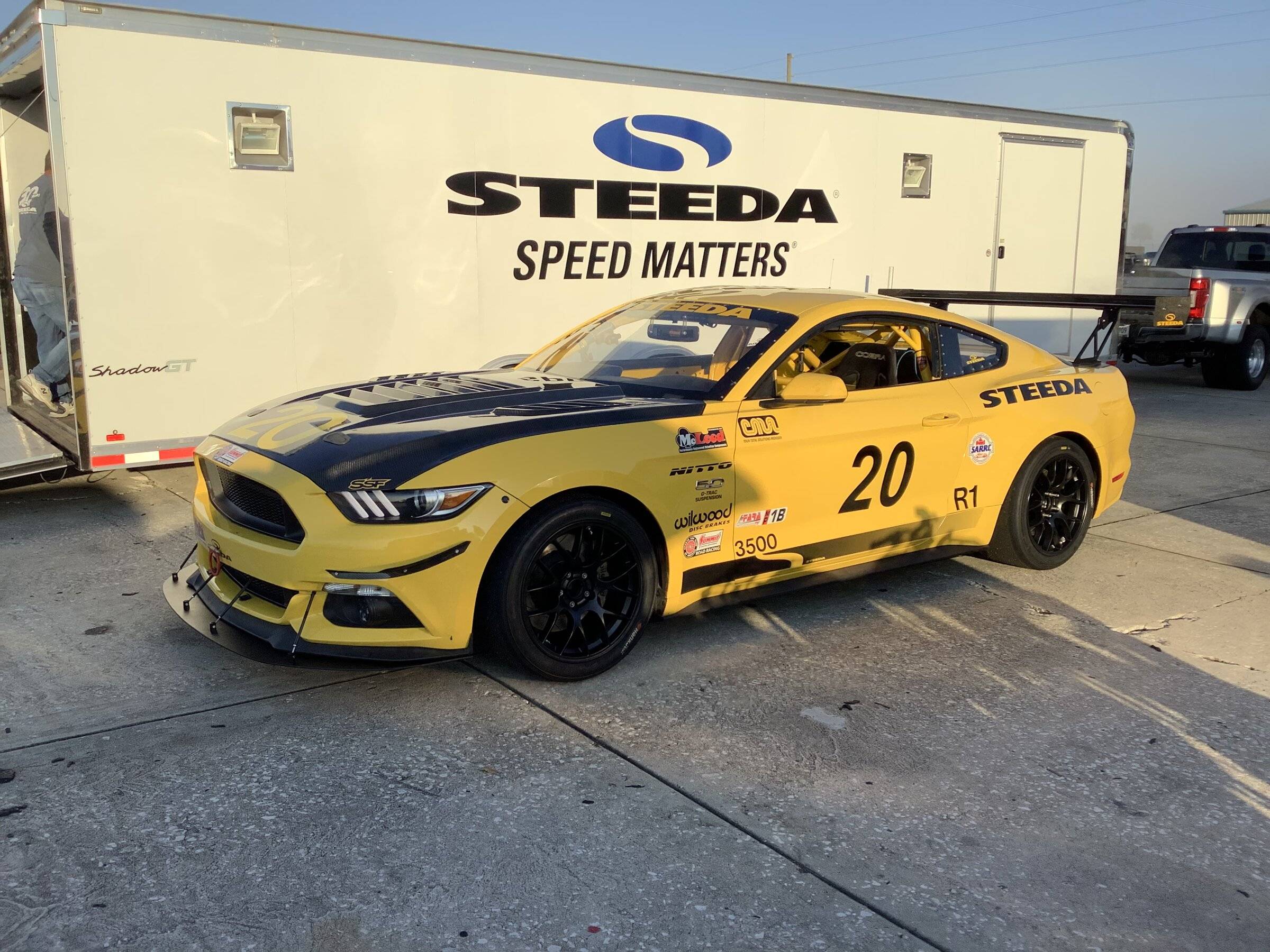

I will have to let SteedaTech provide his technical feedback, but here are some great shots of the #20 at the track:
