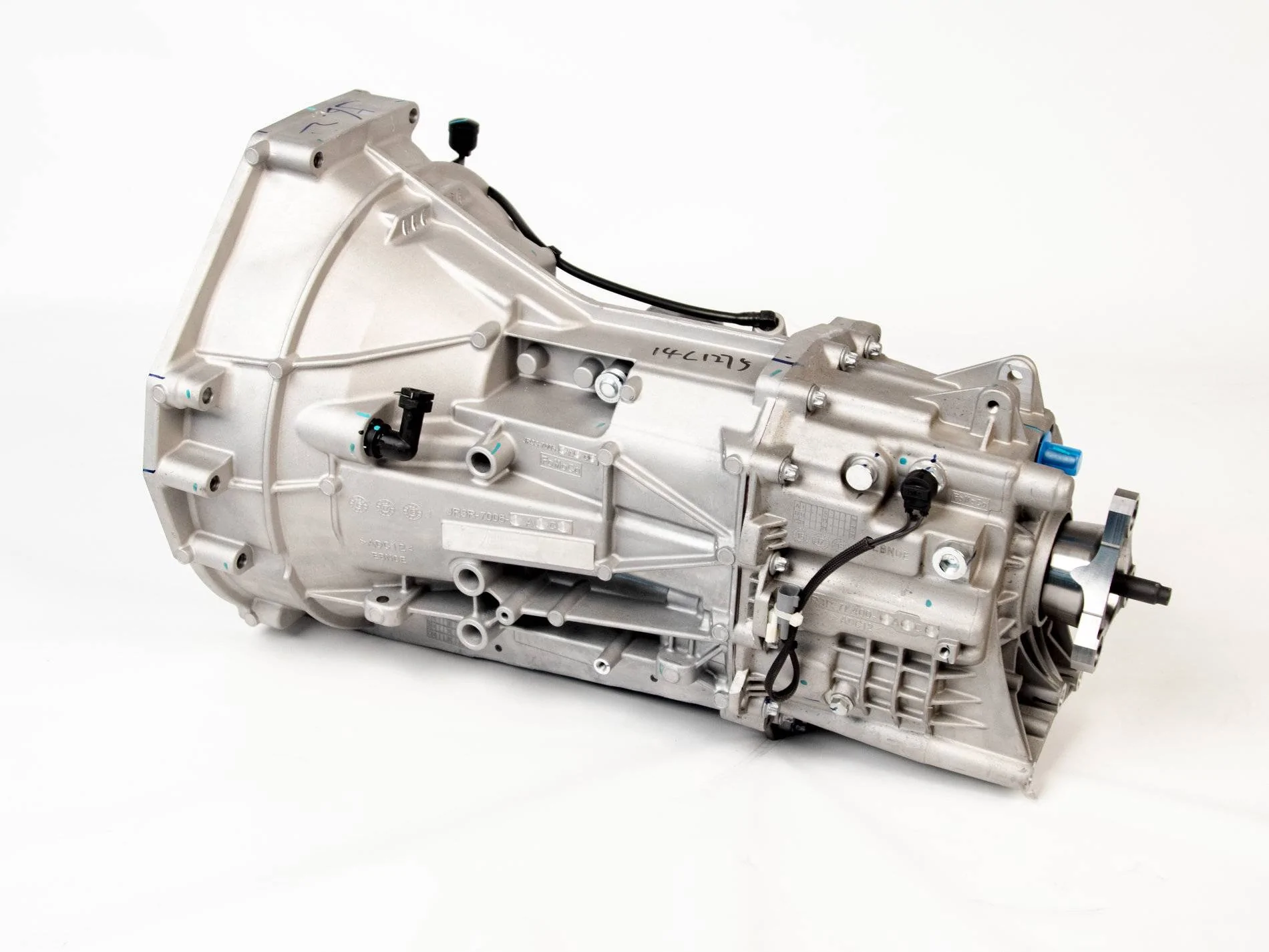

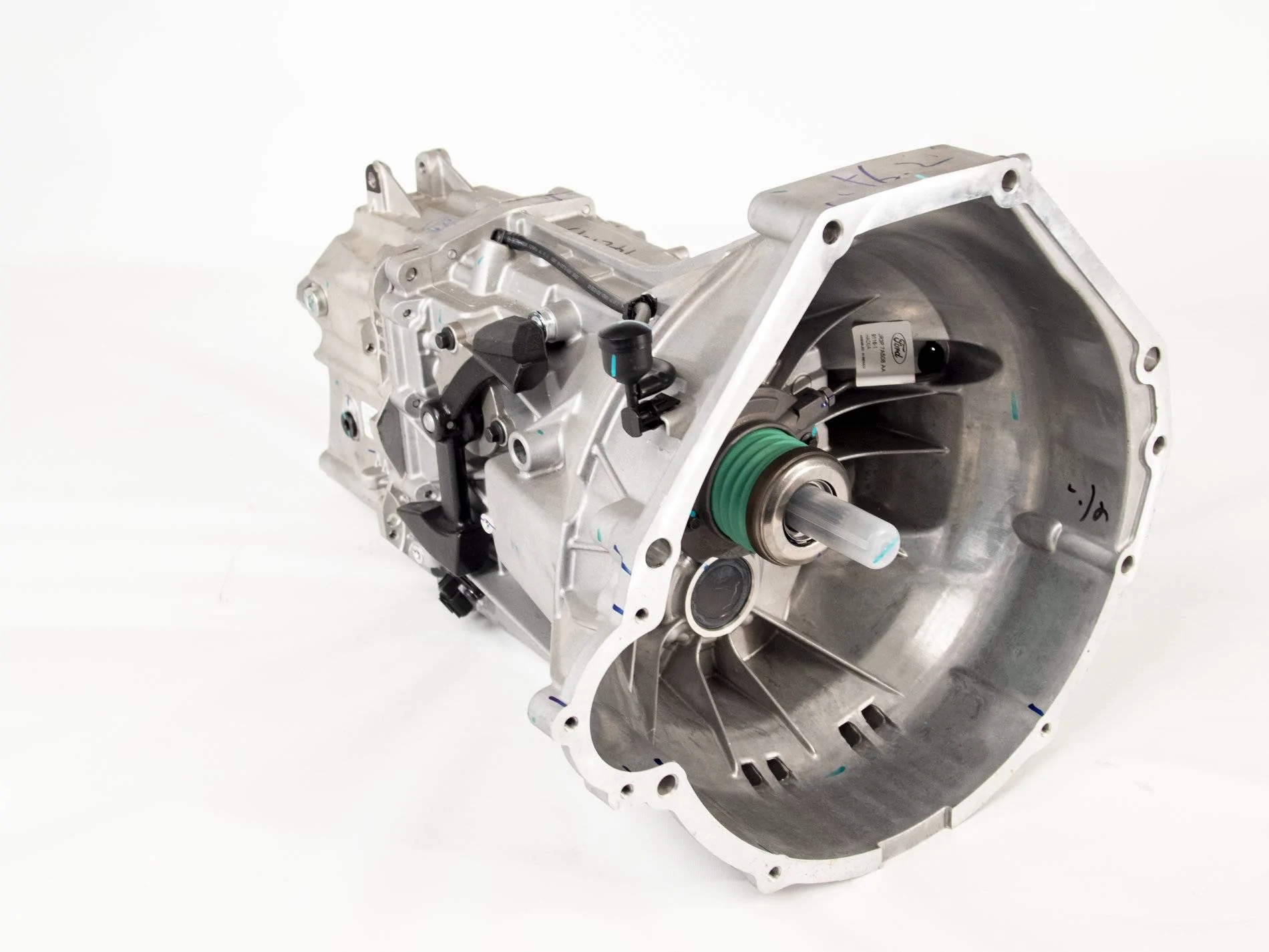

New transmission for the 20 car. We will being doing a upgrade to 2018 plus video.

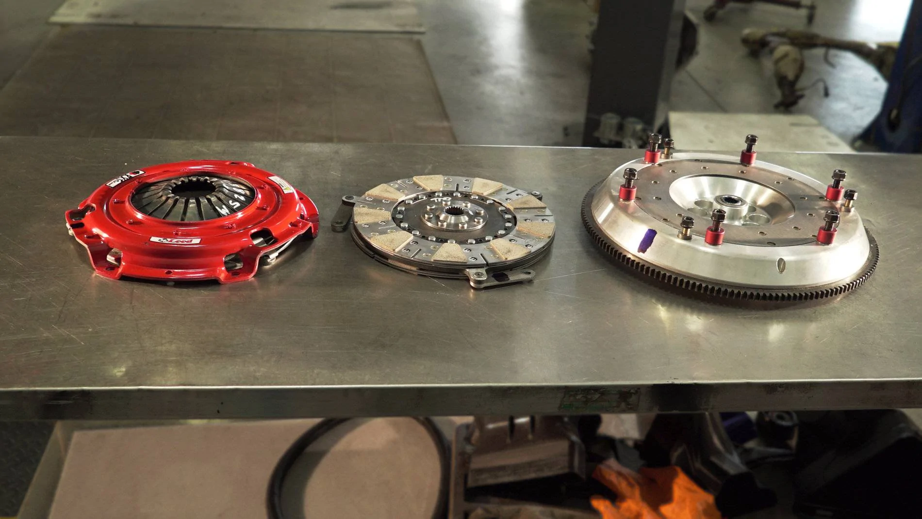

Special thanks, goes to McLeod Clutch for support of the 20 car. We are excited to try this new clutch and flywheel out?

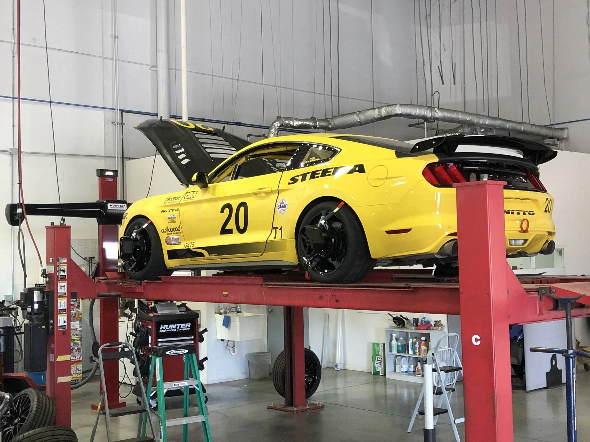

The number 20 car on our new state of the art Alignment machine! Just test drove with the new Mcleod clutch feels great, grabs a little closer to the fire wall .
What are the specs on this clutch? Which one would you recommend for an 18+ that sees track day / HPDE use?

We will be testing the Mcleod in a few weeks on track and report back. We have used the production clutch on our 2018 HPDE for two years no problem.

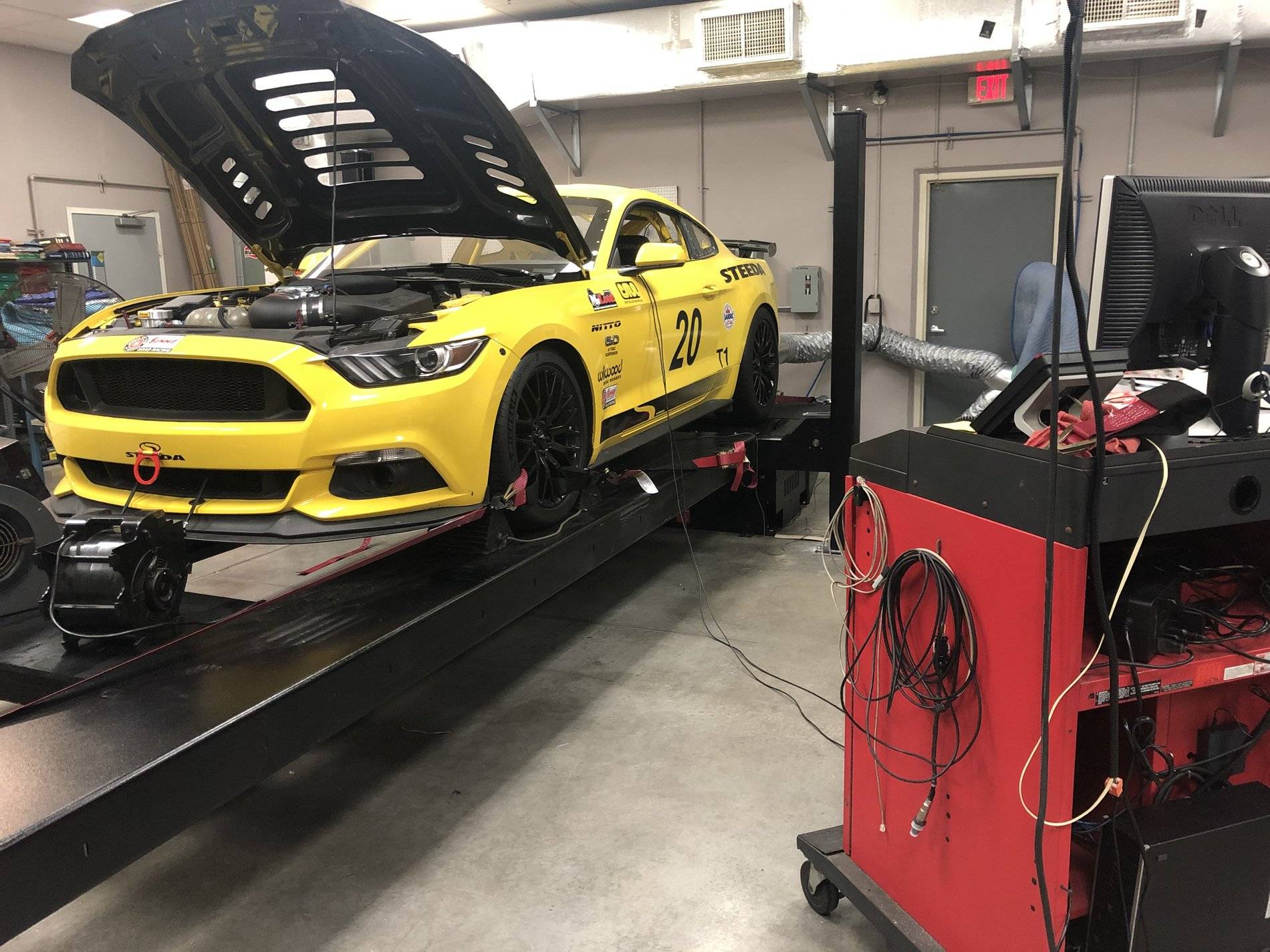

Steeda's new dyno lab. Getting ready for Sebring in a few weeks.
