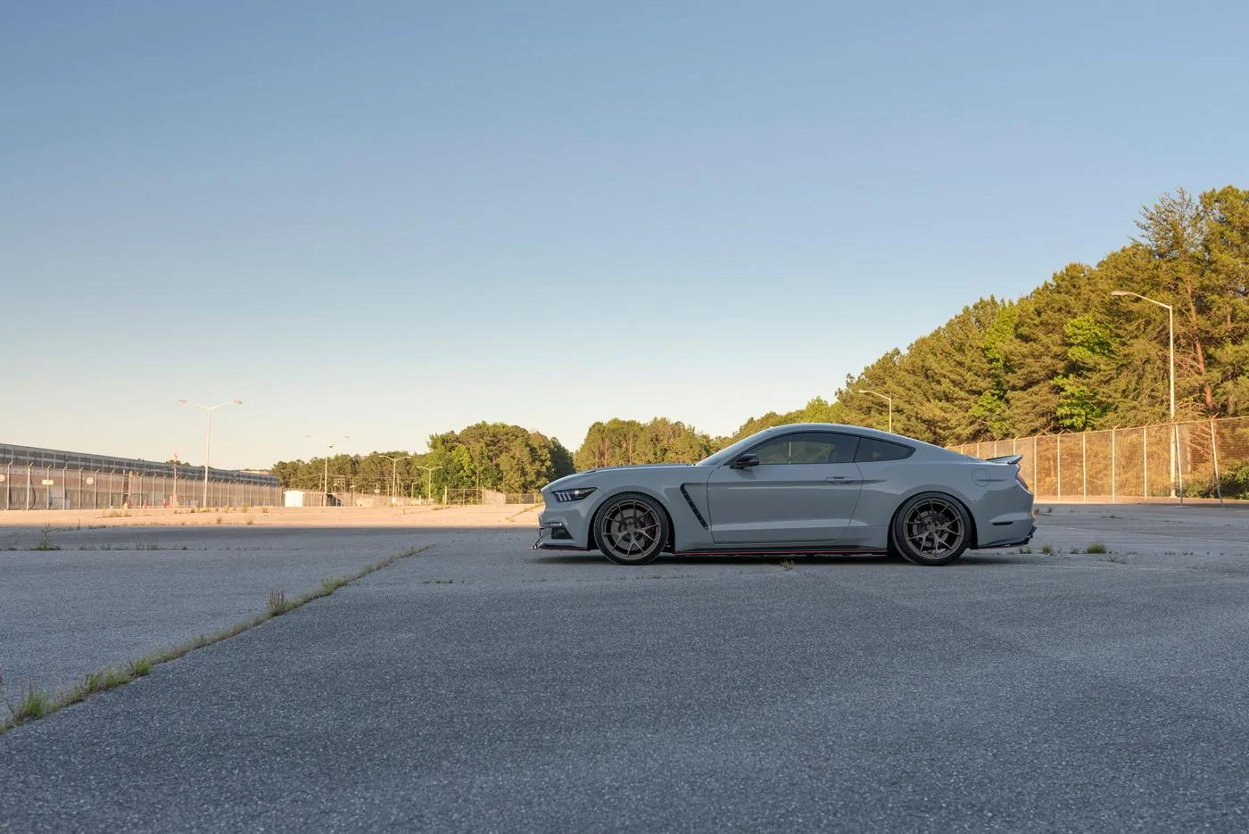

Tried to read through the whole post and not sure if it was answered, but i installed front camber plates on my car recently and it seem to raise the front just a hair. I have the steeda adjustable shocks Steeda Ultralites Linears from early 2016 i believe they've been revised as my rears sit lower than 1" (i like how that is)
So it seems it's possible to get a front coilover that matches the "conventional setup spec" but then allow height adjustment. I'm wanting to even out the look of my drop to match but still perform well. Didn't know this was an option till now as i was happy sticking to what i had.
[MENTION=25806]SteedaTech[/MENTION] [MENTION=7748]tj@steeda[/MENTION]
So all that to say is it possible to order a front coilover without the camber plates, just bought those (if not im pretty sure i could sell them locally). And what rate would match the Ultralite Linears rate, i'm assuming 200 or 250. My car is a street/daily first with a few track/autox events throughout the year. Also i'm assuming this would allow for a larger tire upfront clearance wise then that of the oem or adjustable shock
Pic for example of why i would like to drop the front every so slightly
