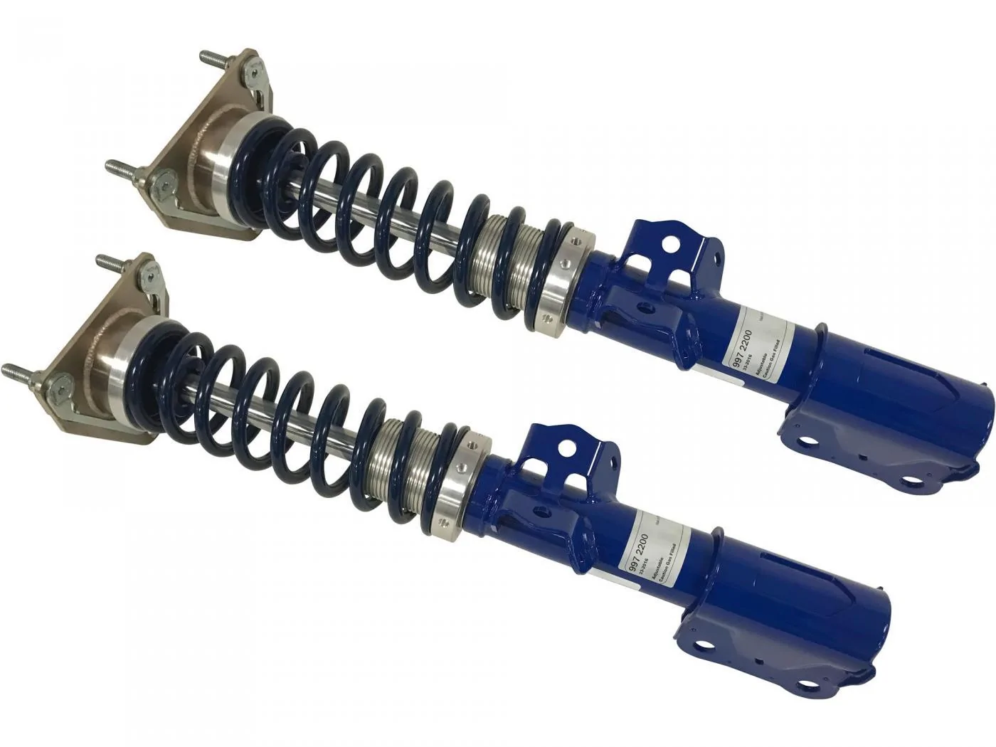

Each coil over set up as shown weighs in at 15.5 pounds

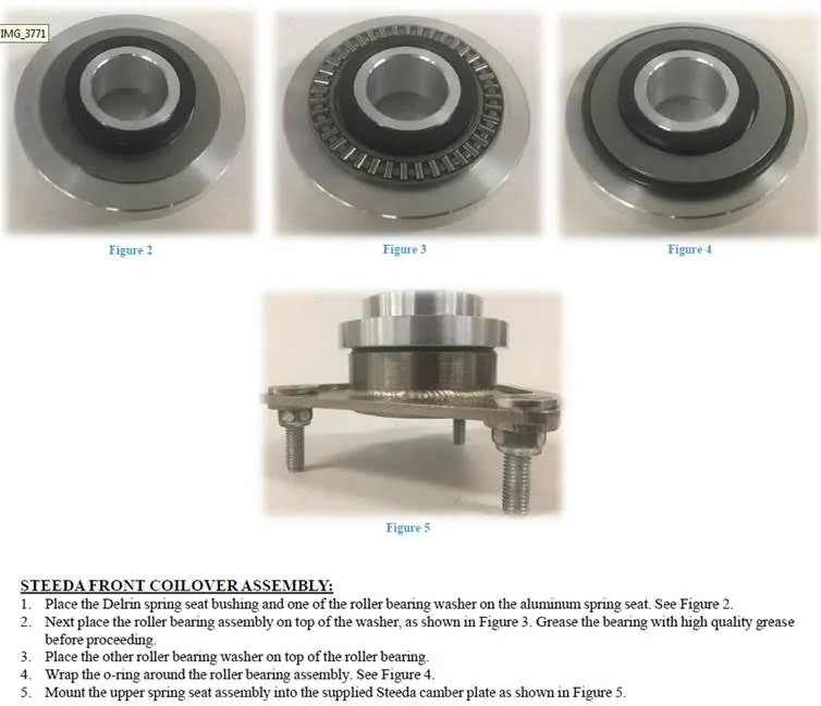

@Steeda, the kit is great but the instructions could use some fine tuning :). There were a few components with no reference in the instructions, like the rubber O rings, the large nylock nuts, etc. I took an educated guess on them and nothing has exploded or fallen apart yet.

Hello,
I had a chance to review the instructions with manufacturing this morning & wanted to confirm a few items.
Customer satisfaction is our top priority here at Steeda among making high-quality parts & accessories so we appreciate the feedback.
In the instructions, on page 2 - here is what is referenced in Step 4 and Figure 4:
6 nuts are provided, and there are 6 studs protruding for the nuts - see instructions below.
Also, the O-rings are mentioned on page 2:
We just want to make sure these were the instructions you received.
Please let me know.
TJ

I'll echo that statement. I'm in the middle of the install myself. The large nylock nuts are for the stock struts when using the camber plates. They don't fit the Pro Action Adjustable strut. The orings (smaller beefy ones, not the ones that go in the strut bearing), I have no idea (pretty sure they were in the box with the rear shocks and springs). I put them under the bump stop on the rear shock.
A range for the setting the front coilover ride height would be great too. That is provided for the rear springs, but not the coilovers.
