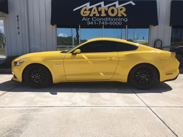

Just installed Ultralite's and Steeda sways yesterday. Initial drive today I was happy with the ride. I'll have it at Sebring in a couple of weeks. I'll be able to talk about handling after that. Can't really get it to the limits on the street.

Great looking set-up ... you should be very happy!

Looks great, are you running spacers?

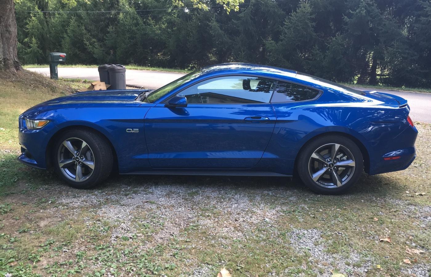

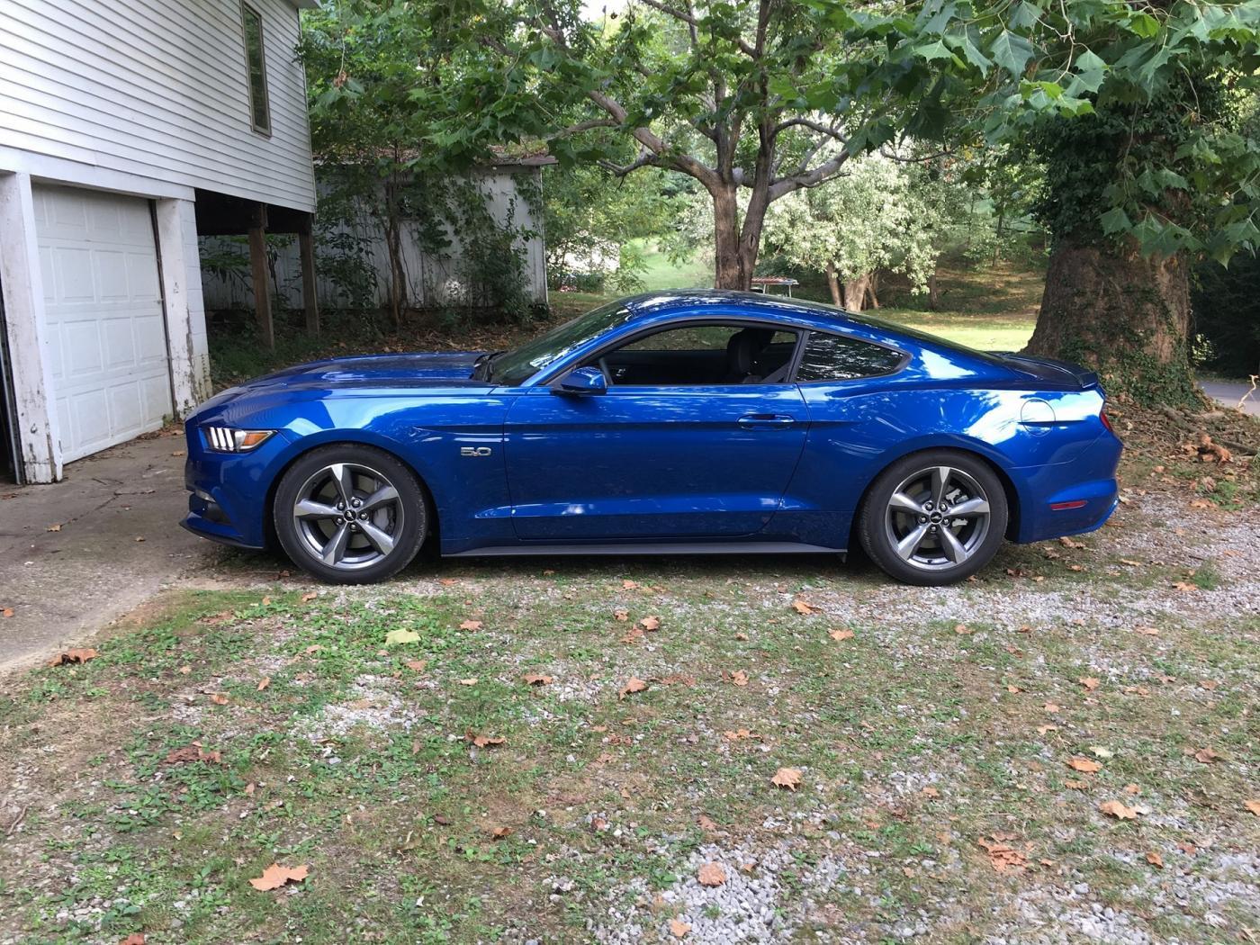

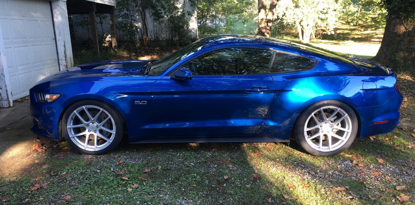

Installed a week ago and then aligned. Initially the drop was a lot more than I expected (may have been the old design, ordered through AM) but I was perfectly okay with it. After a week everything is settled out and I've added rear camber arms (thanks again Steeda!) and I'm getting my rear camber re-adjusted today.
Overall with the Ultralight Linears and stock Base dampeners I've got no complaints. I will say your alignment seems to have the biggest impact on ride quality once it's dropped. With the factory camber arms and ~ -1.9 and -2.2 on the rear wheels it rode fine and there was very little bounce. I installed the rear camber arms, and it added a little bounce but the rear toe and camber is out a good bit.
As far as stance goes I'm happy with it. Overall the car is more level, though the wheel gap is bigger at the front with 305/35/20 in back and 265/35/20 in the front it doesn't bother me at all. I swear sight down the hood is better now as well.
As far as performance goes I can't say anything yet as I wanted to get an alignment before I push the car, but I haven't noticed any traction issues or rubbing even having hit a few pot holes.
Pictures in order are full factory, just the ultralites installed, then ultralites, camber arms, and new wheels.
