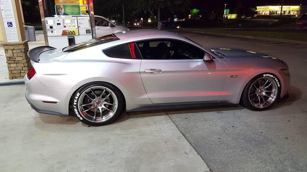

Can you guys post pics? I only worried bc i want a level even look and im running 305 35 20 tire in rear
Here are pictures of my car on the ultralite linears with 285/35/20 up front and 305/35/20 out back.

Damn. Looks sick. I dont notice much gap difference

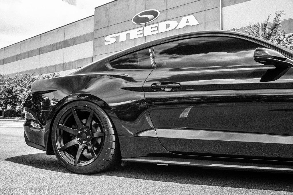

>> The photo linked to above shows the car with the back lifted up with new spring. I know this is on a downward incline, but it looks largely the same on level ground. They strapped down my car some by this point and it pulled down the rear suspension a little, replicating level ground. More or less before you couldn't see the top of my tire tread, now I can with also a wee bit of gap.
https://www.instagram.com/p/BHajKjlASP1/?taken-by=sirboom_photography
>> This shot and the one attached in B&W is prior, with the original rear drop. You can see with the 20" rims the tire tread sort of gets hidden by the fender. This is not the case anymore. A lot of people actually liked this look, often asking if I had coilovers.
If I had a million dollars, I'd get coilovers and have zero worries about wheel gap, instead adjusting as necessary. And, for handing situations, I'd adjust right where my updated Ultralites site because it seems to balance the car nicely.

Without at least PP dampers, it probably would be bouncy - stiff rear spring. At least bouncier than I'm willing to deal with. If you get any of Steeda's dampers or Konis, you'll have a very compliant ride.
Ass doesn't look like it's dragging, especially now. It's really hard (if not impossible, really) to legitimately "level" this car without having uneven wheel gap - the car has rake built into it and the wheel gaps are situated as such.
