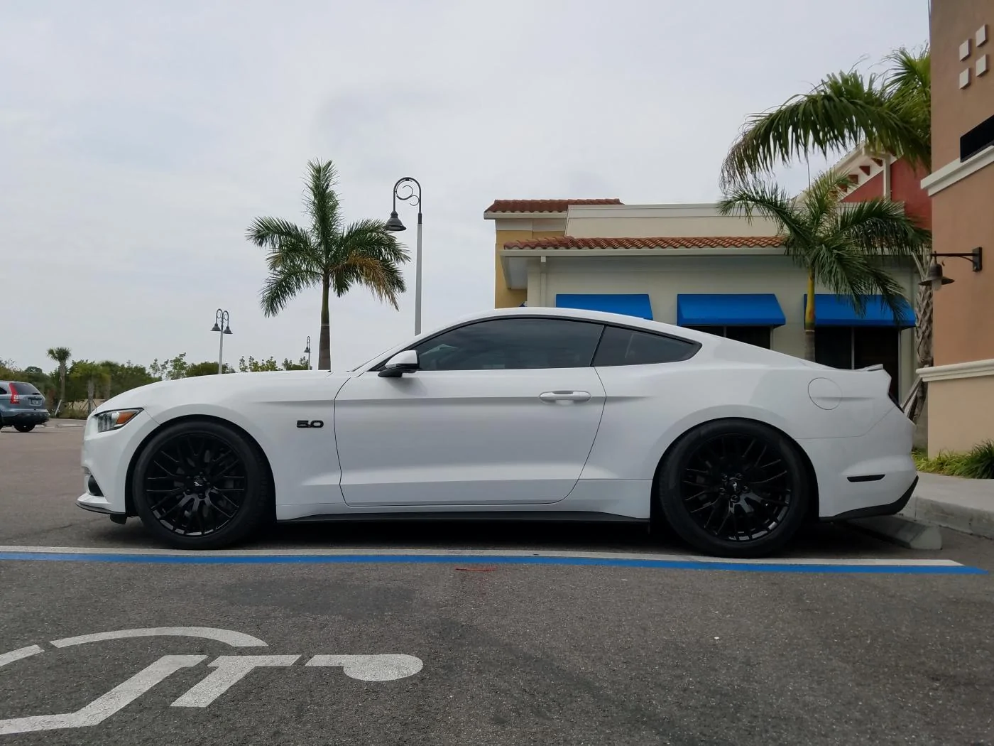

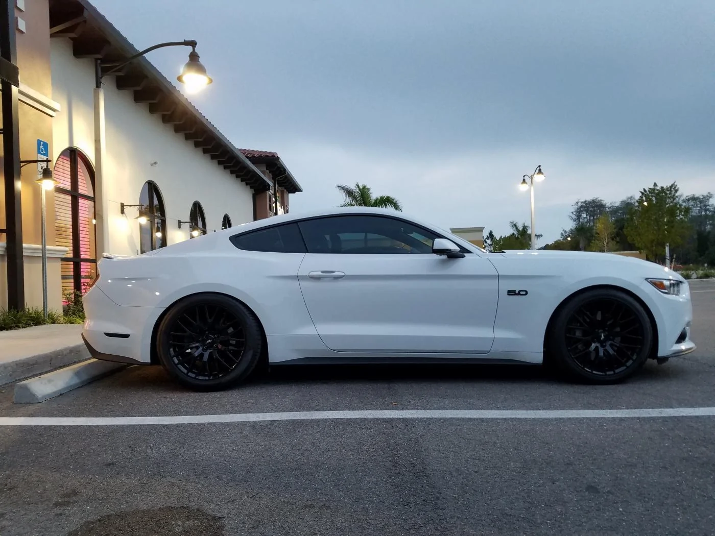

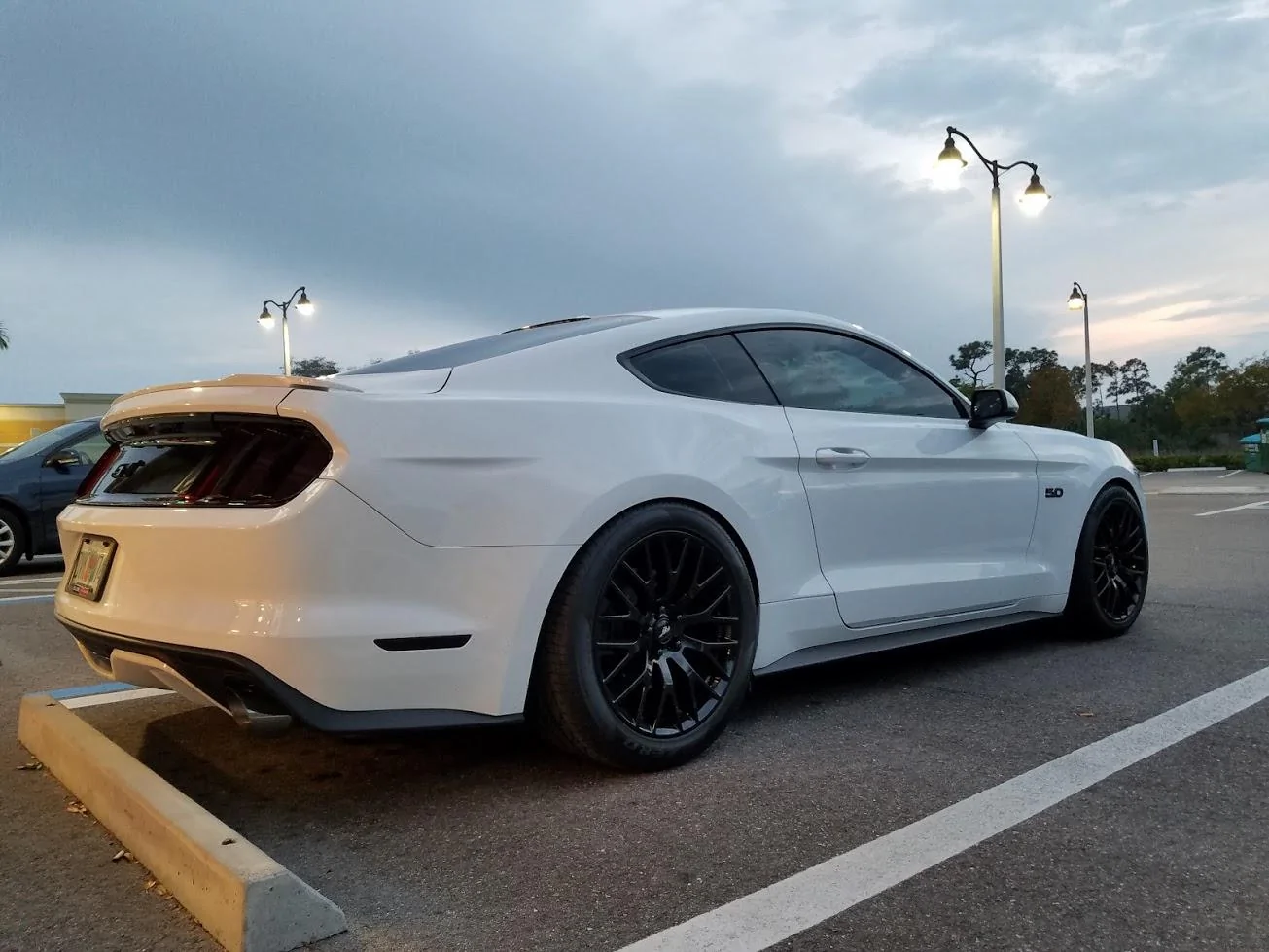

I really didn't want an uneven drop but had already bought these. I ended up installing them and am very happy I did. I think they sit great. If you think you won't be happy is suggest the BMR springs. They look great too.
Here's a pic of min with the ultralites and BMR cb005 lockouts

Steeda Ultralites sit lower in the rear by design, for more rear weight transfer for road course handling. You can raise the rear by stopping the spring one inch from the stop on the lower control arm. Just jack up the car with the suspension unloaded and you can turn the spring away from the stop by hand. Takes just a few minutes.
