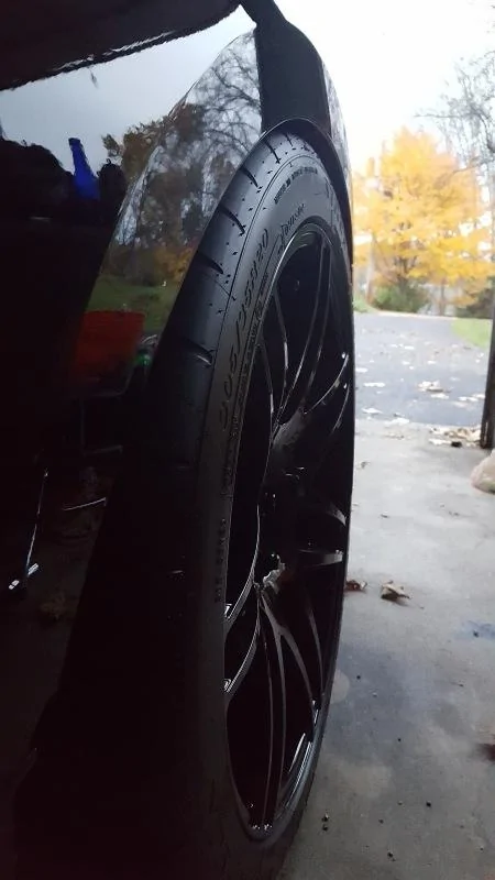

Think i gotta get the 3/8" i have the 1/4" installed now but not much difference
