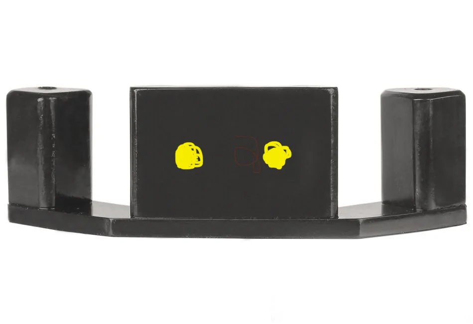

Thinking of having steeda install this since they are local... can you guys show me a photo of the holes you're drilling?

Don’t have one of what it looked like but I doodled on this picture so you can see what I did. Two 3/8” holes.

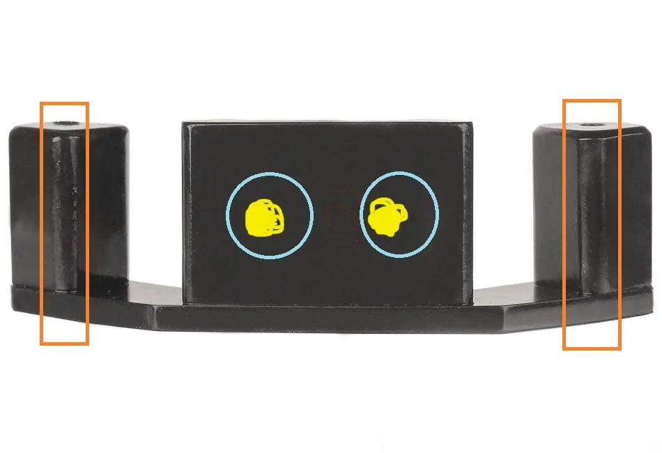

basically they are swiss-cheesing the insert longitudinally - drilling long holes down the length (orange), not drilling them thru the short/flat dimension (blue). Now if you want to drill (blue) I'd go bigger on the holes or do a triangle or diamond pattern of 3 or 4.
I have 2 cars with this Steeda trans bushing in unmolested state. The GT makes a righteous amount of trans gear growl when properly caning it, but under normal conditions you get an undercurrent which is not objectionable. But most of the other cabin noise is coming from the the IRS thanks to the BMR CB005+762 setup. I get various thuds when preloading the drive-line but none of the howl/singing of the diff you get with diff lockout kits which use 'pucks'. I have the Whiteline diff bushing replacement kit.
Now the EB has the same insert and mods but is very nearly silent (relative to factory) even when caning it. The big difference between them (aside from EB vibration is different from V8) is the EB has the Whiteline IRS bushing replacement. Which to me is the FAR better solution if a right royal pain to install. Because it's so quiet, I can hear the 'click/clack' of the drive-line being load/unloaded with each shift and also a bit less of the 'thud'.

You could be right in that I drilled it vertically, honestly can't remember. All I know is that I don't have any increase in NHV and it firmed things up nicely. I too don't find the MT-82 to be terrible or anything, I just like to tinker around. The only other manual I have ever driven was my dad's PT Cruiser 12 years ago, so ya not really a great comparison for me to go off of :cwl:
