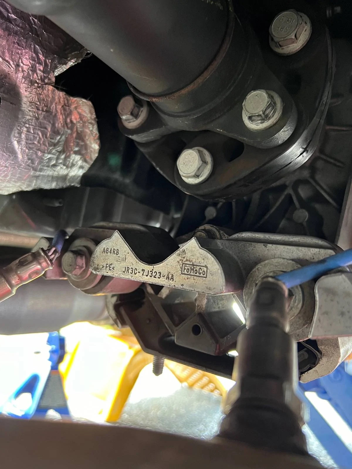

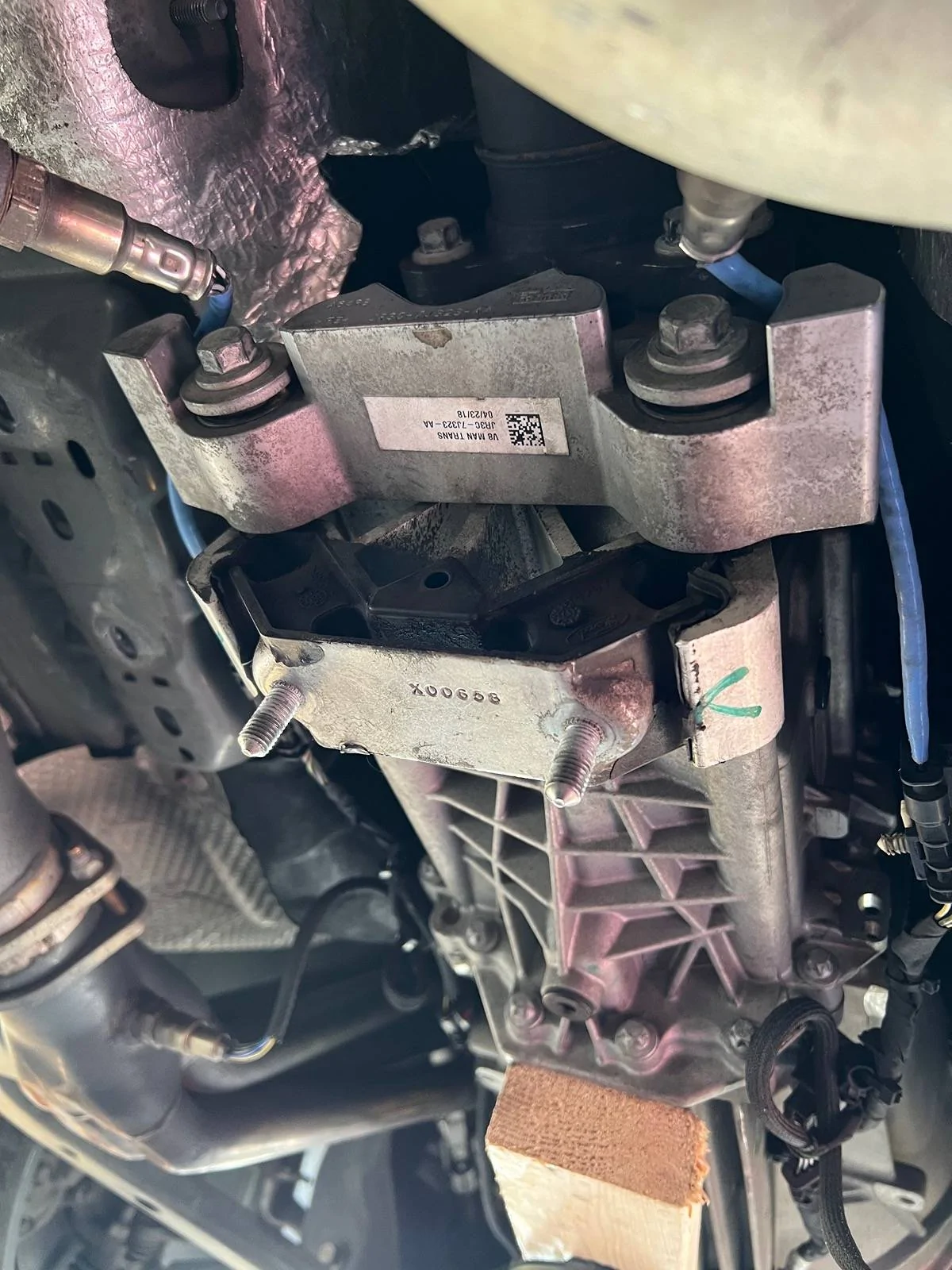

The install was pretty simple honestly. Maybe I might have to remove this gear box “weight.” Nobody else seems to have it installed. Not even the videos I’ve watched. Idk why it’s on my car. (Before install photos)
My theory is that the bushing is pressing against that metal pointy thing and making it vibrate? I definitely wasn’t expecting this launch noise.
My other theory is that maybe my trans isn’t aligned at the proper height? But then again under 2k rpm it’s perfectly fine 🤷‍♂️. I torqued everything to spec. I hope I didn’t bend anything when I lowered the suspension to make room for the install.

Weights are used to change harmonic frequencies. I'm pretty sure mine doesn't have that giant weight either.
Did you unbolt anything around the trans? Like the tail support?
Just because a fastener appears tight doesn't mean parts are properly aligned or buttressed against their supports etc.

I had that weight on mine. Tossed it out. It does help with nvh though on the stock setup.

Pull it, pop in an mgw. Still nvh because it's completely trans mounted but it's not bad at all. Definitely more vibration than stock but not much with noise or harshness. Unless it's something in your interior. Did you dynamat everything?
What is a trans tail support if you don’t mind explaining it. Which bolt would that be?

I installed that insert probably 6 years ago in my 2017 GT. The trans noise was horrible after installing it, just a constant whine. Can't say I noticed any vibration, but I only left in for about 50 miles and then pulled it out and in the trash it went, made driving the car miserable.
I now have a 2020 GT and I had the same weight you have. (My 2017 didn't have it.) I think that was added in 2018 maybe, just helps with vibration I assume. I installed a Barton shifter in my 2020 a few weeks ago and had to remove it since I wanted to trans mount the shifter. Yes, noise increased some, but I am sure that was mostly due to the shifter, I doubt the removal of the weight had much to do with it. Still no where near as bad as that damn insert!
My guess is you will notice no difference if you remove that weight, the insert is the problem, at least it was in my experience.
