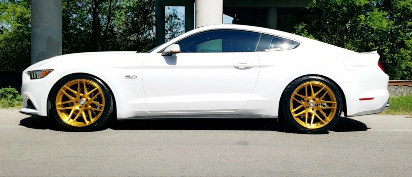

Installed mine last night. No noises (fingers crossed) drove about 50 miles already and they feel great. Exact drop I was looking for, gets rid of wheel gap, stiffens it up, and isn't too low to where I have to be scared driving it daily.

That's a great idea. That way you get the great characteristics of the Steeda progressive spring and can dial in the height you want.

Great shot and color combo.
