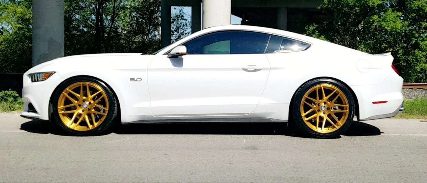

Quick pic with the new wheels and steeda springs.
It has been several days since the install ... how is the ride quality - would love to hear your feedback.
Great pic!
