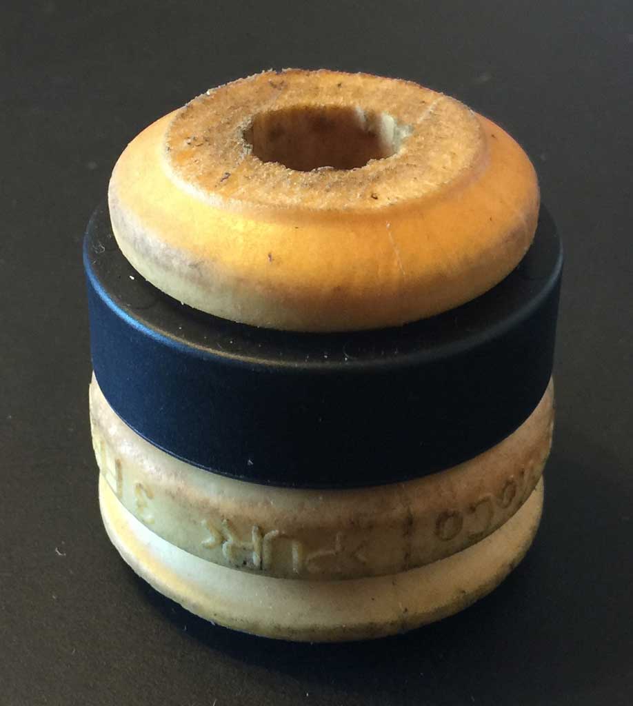

I have the Steeda progressive springs and Koni adjustables. Initially I didn't trim the factory bump stops at all. Trimming them down to the first indentation above the black ring made a definite improvement. I've only modified the rear, never touched the front. Then I got the Steeda adjustable bump stops and put the short stop in the rear. Again a significant improvement over the trimmed factory stop.
The short Steeda stop for the rear is a little shorter than where I trimmed the factory stop. The problem with trimming the factory stop I think is the fact that it gets pretty hard where you need to trim it to and that black plastic ring is very hard. The Steeda stops being a little shorter and urethane I guess it is work much better!

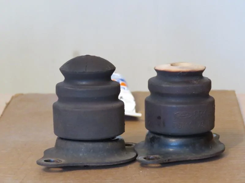

You should be able to drill a tapered hole down into the end of the cut-down stock stop and soften it a little that way.
Not an S550 bump stop, but I think it illustrates the idea clearly enough.
Norm
Norm,
While that might be a good suggestion for bump stops that are all rubber, it won't work for the Ford factory bump stops. See the black in the picture? That is a very solid material like plastic. drilling this won't help.

I'm sure that the hole that's already there could be opened up a little, and that there may be a couple other possible approaches as well. Is that black plastic a full layer or only a ring constricting outward distortion of the yellow stuff?

It's the later. I'm sure you're probably thinking you could just cut the black plastic ring off right? While that is possible, for $60, I like the Steeda solution.

Actually not what I was thinking of (that was more along the lines of making the yellow stuff a bit 'squishier' inside where it is constrained, or making the black stuff a little more willing to 'give' a little).
Guess I've got way too much DIY'er DNA in me.

Why not just cut the remaining portion of the yellow and pull out the black ring?

Haha! Yeah but I like the way you think. Unfortunately the black stuff isn't going to soften, it's very hard. It's also a bit thick, I'd worry that if I cut it off, the yellow squishy part (rubber?) wouldn't have enough structure.
