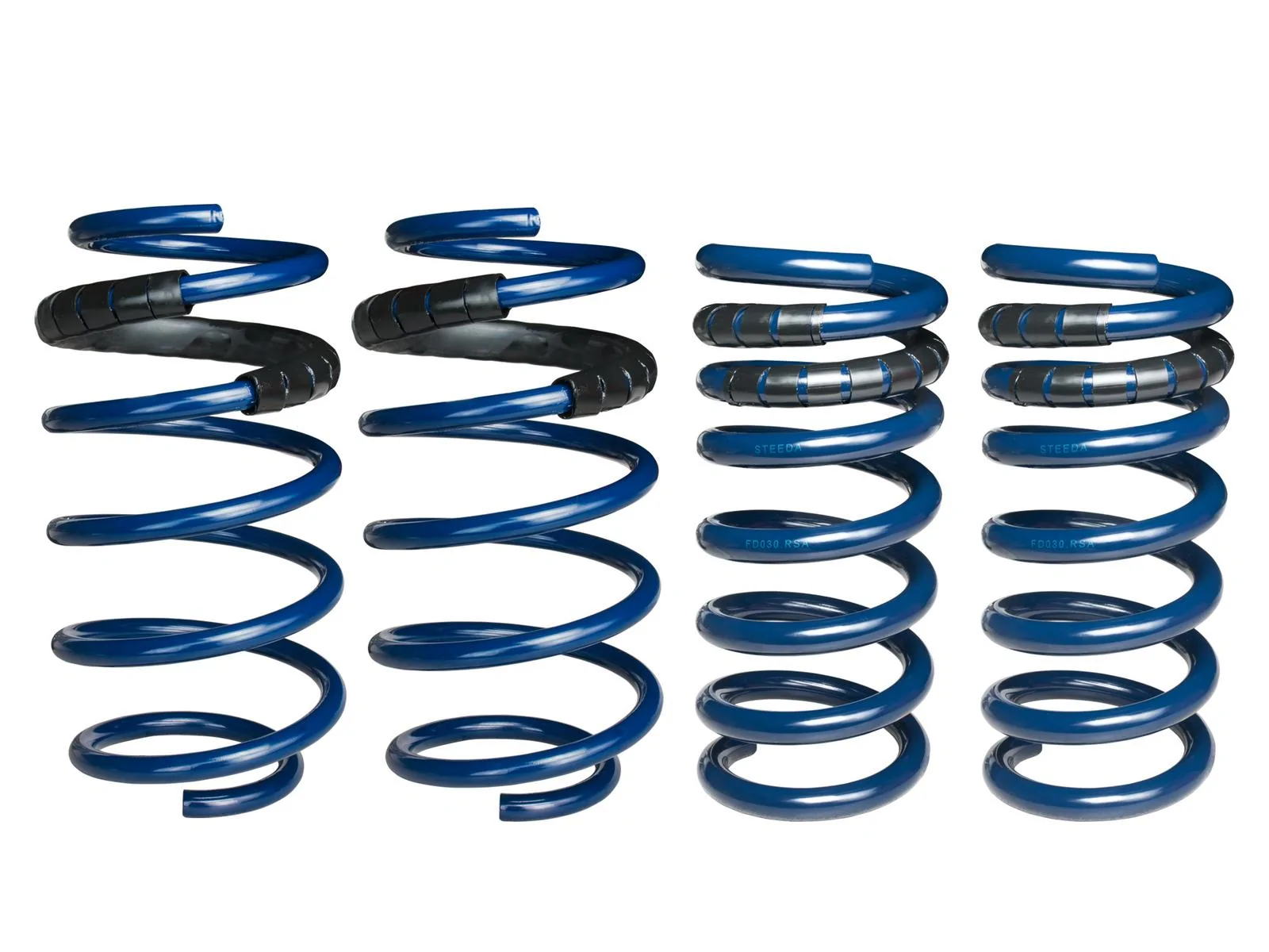

For the noise in the front left, it's hard to tell without a good description of what kind of noise. Your springs should have come with isolators on them (black slip on sleeves). They should be on the coils that are closer together and should be oriented to the top. If not, you could be getting a little noise when the lighter load coils come together. Mine don't even have the isolators and I don't get any noise at all but Steeda added them because a couple people did. Most likely something was left loose. My first guess would be the strut nut wasn't tightened all the way (76 lb ft) or the tie rod at 85 lb ft but i would talk to Steeda for sure, very helpful!

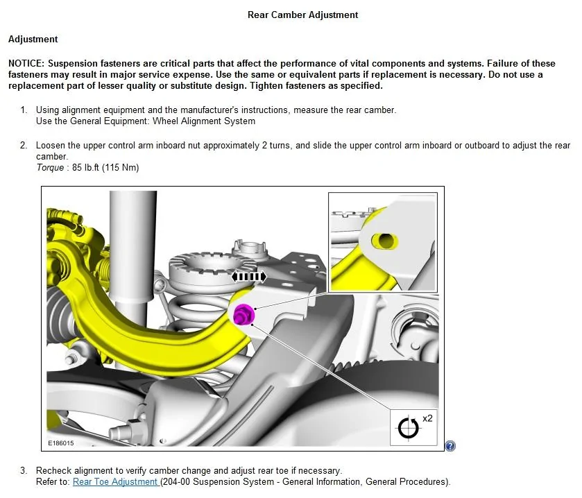

As for the alignment, what I do is hand them the instructions on how to adjust the rear camber. There is plenty of adjustment from the factory to get it within spec although it's not easy and if I remember right, the driver's side is a bit of a pain to get to the nut to loosen/tighten it for adjustment. The front is a different story. Lowered 1.125" in the front brought my camber out to about -2.0 -2.1. Then I got camber bolts which is the cheap route but got what I paid for. Every time I got an alignment after the from camber moved, the hardware is a lot smaller than the stock strut bolts (it replaces the top strut bolt). I replaced that with Steeda camber plates and life is good again.

More than likely, it is the upper strut nut not torqued to spec. Also, check to make sure the spring isolators are positioned properly. They can be repositioned very easily once the car is jacked up.

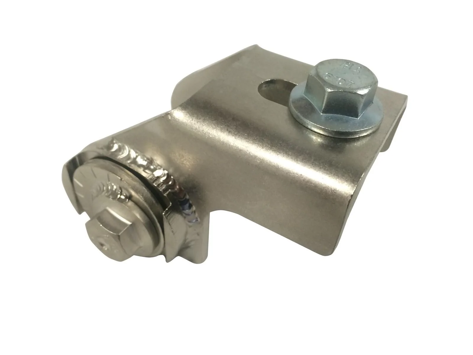

FYI Steeda has these brackets that go onto the stock mounting points to allow more solid and precious adjustments if you don't feel like investing in adjustable arms.
https://www.steeda.com/rear-camber-adjustment-kit.html
