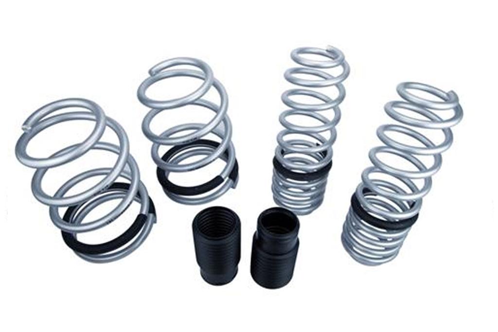

Hi everyone, just to preface this we’ve sold over a thousand of these progressive springs so far. There are only a handful of people experiencing a noise coming from the front of the car, and we were able to rectify a few of those instances by having the customer torque down the sway bar end link nut using red loctite as we found they were still coming loose after a couple weeks even when torqued to spec. A noise can also arise if the spring isn’t seated properly.
As a few have mentioned, it is common for progressive spring coils to touch when under load.
The best way for Steeda to diagnose an instance of springs making noise is to physically have the car in our possession. We actually had one customer who claimed his springs were making noise send us the springs so we could put them in our Vortech S550 - and after thorough testing on and off the track, we couldn’t get those springs to make noise.
For those experiencing noise, the frequency in the shock and other OE factors could be different, the way the car was manufactured could have a slight variation, too.
What we are going to do is send out a pair of silencer rubbers to customers who are experiencing noise from the front springs after their due diligence has been completed. As a few have mentioned, this is a simple few minute install and can be applied to the springs while they’re still on the car - you may not have to take the wheel off if you jack the car up.
Also, if you’re local to Valdosta, GA or Pompano Beach, FL and are experiencing a noise, please pm me and we can coordinate you stopping by so we can see what’s going on first-hand.

Again this is very common, this is a ford racing lowering spring and an eibach spring. This is how progressives are designed. The spring isolators are an industry standard not a cheap fix

If the spring is making noise the plastic isolator is a common solution. Again, if you understand progressive springs the first coils will touch under compression they are made that way. That is not coil bind.
On another note, If you remove the bump stop or trim it to much it may cause the same issue. Only trim the bump stop 1/2 inch
Again, make sure the spring is seated properly on the lower strut seat and the tail of the spring is at the end of the stop. If it is not it will cause noise.
The spring pictured in Reds 197 shows that one spring had more contact than the other which could indicate the spring was not seated properly on the lower spring seat or a bump stop issue.

We took the endlinks completely off the car. Then secured the sway bar out of the way. Still had the noise. This is after pulling both strut assemblies back off the car and ensuring the springs seated correctly. They are in the correct way, which happened to be text/writing facing down. Everything is torqued to spec and has been checked multiple times.
