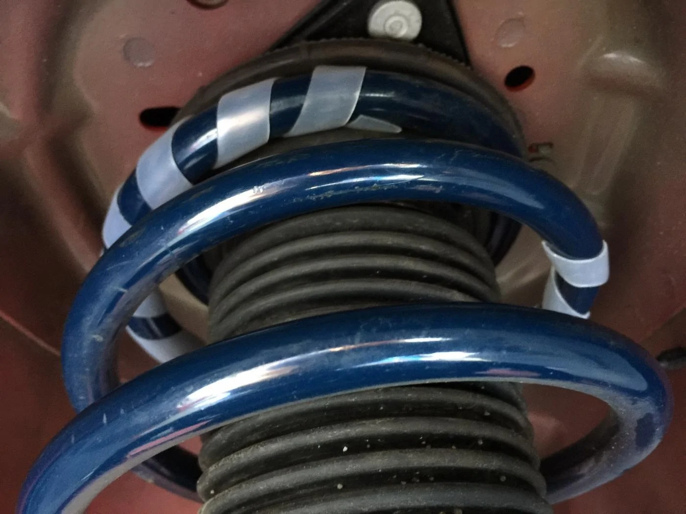

I pulled my Progressives out today,the clunking noise was coil bind it appears to be ?
I have a pic of one of the springs and you can see the sharp wear mark
its on both springs in 2 places on each spring, .I guess it was not an install issue after all .....David
Let me know what you think

Here is my fix for this problem. I have seen Whiteline has the same thing. Went to Home Depot in the wiring section and picked some wire loom. We will see how this holds up. It was only $3.00

They deffinitely rub. The question now is, is that bad? Does that impact handling or anything else on the car negatively?
Its slight,but coil bind should never happen with any spring for any
application . Now I need to search out why I chose progressive over
linear in the first place . :frusty:
