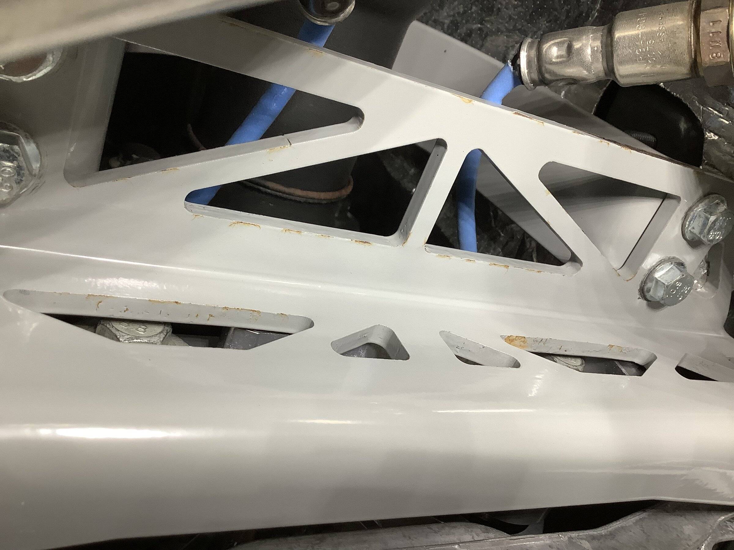

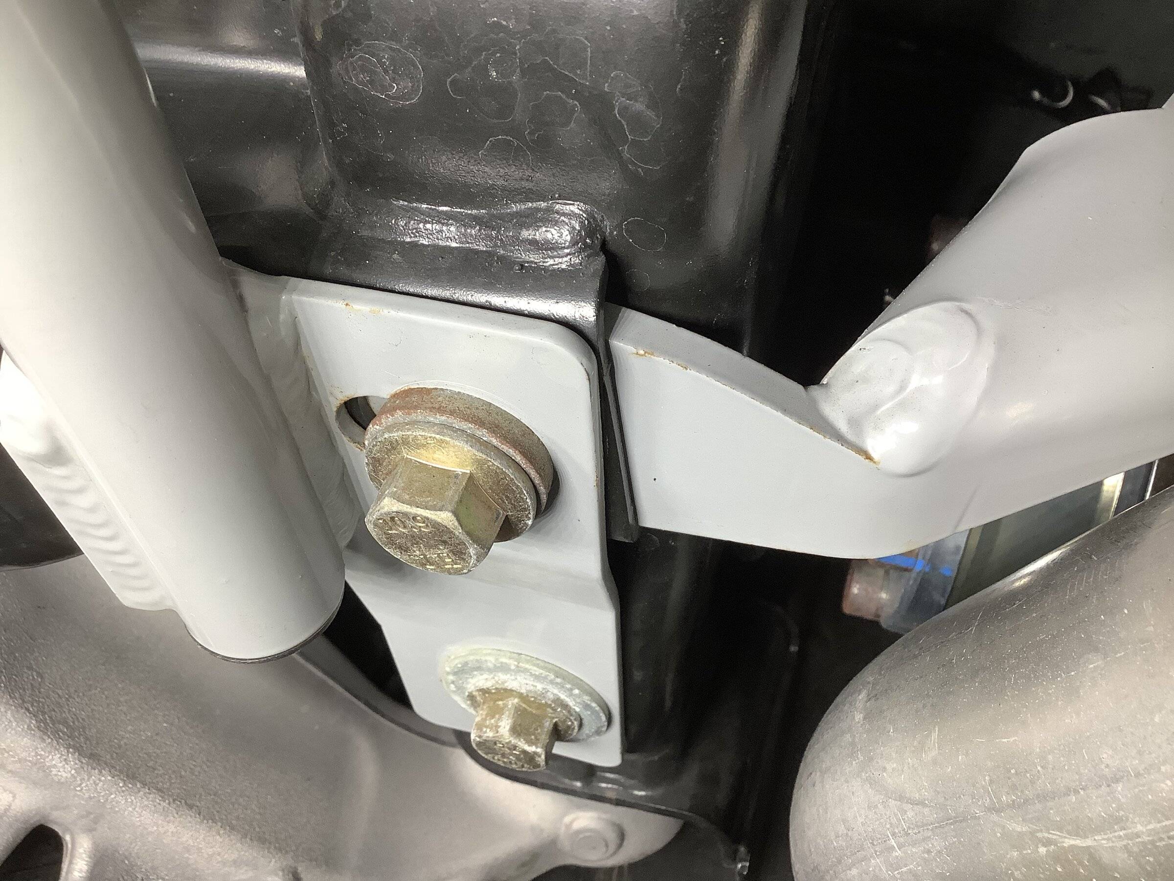

Okay guys, here is what my parts look like with 5700 miles on the car. I I stalled all parts at 471 miles on the odometer. What you’re looking at are the driveshaft safety loop, subframe support braces (rear mounting points) and the hardcore differential bracket. Having said that, I do believe the parts are made well and they are serving me well too, but the powder coating game could be tightened up a bit for long lasting durability.

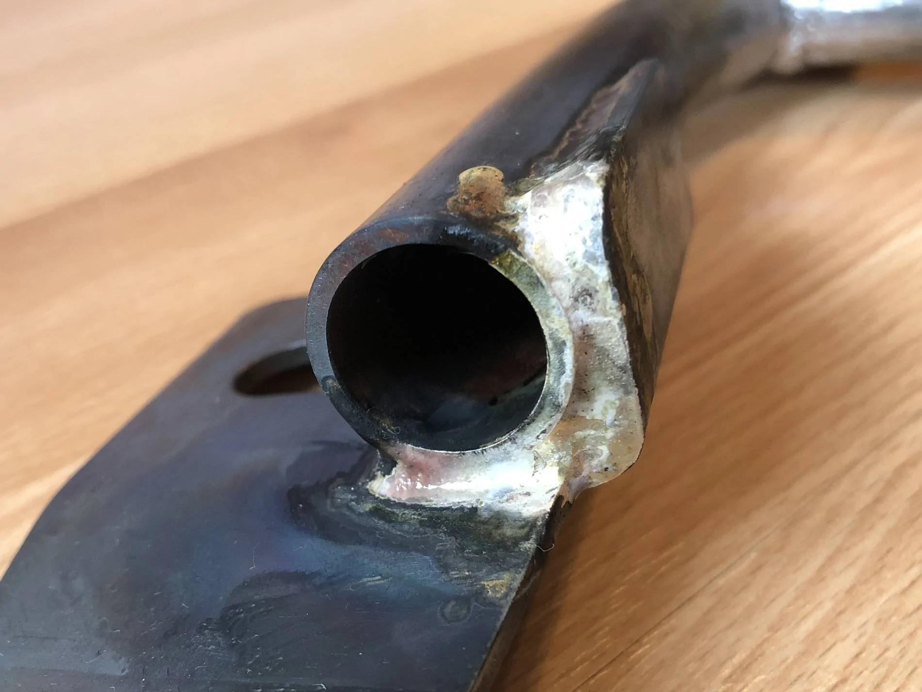

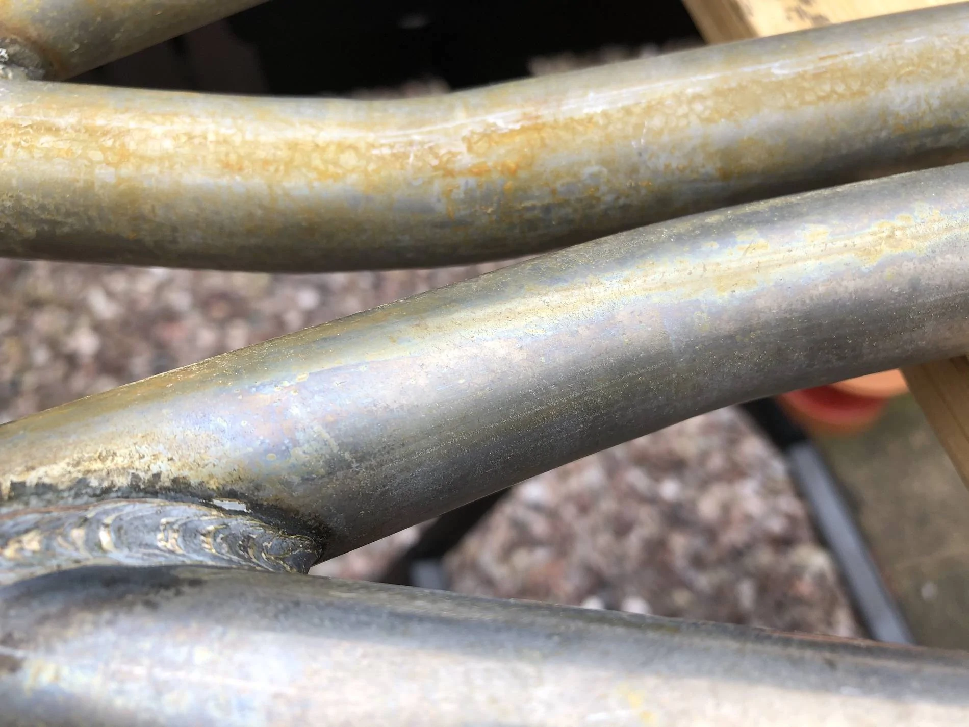

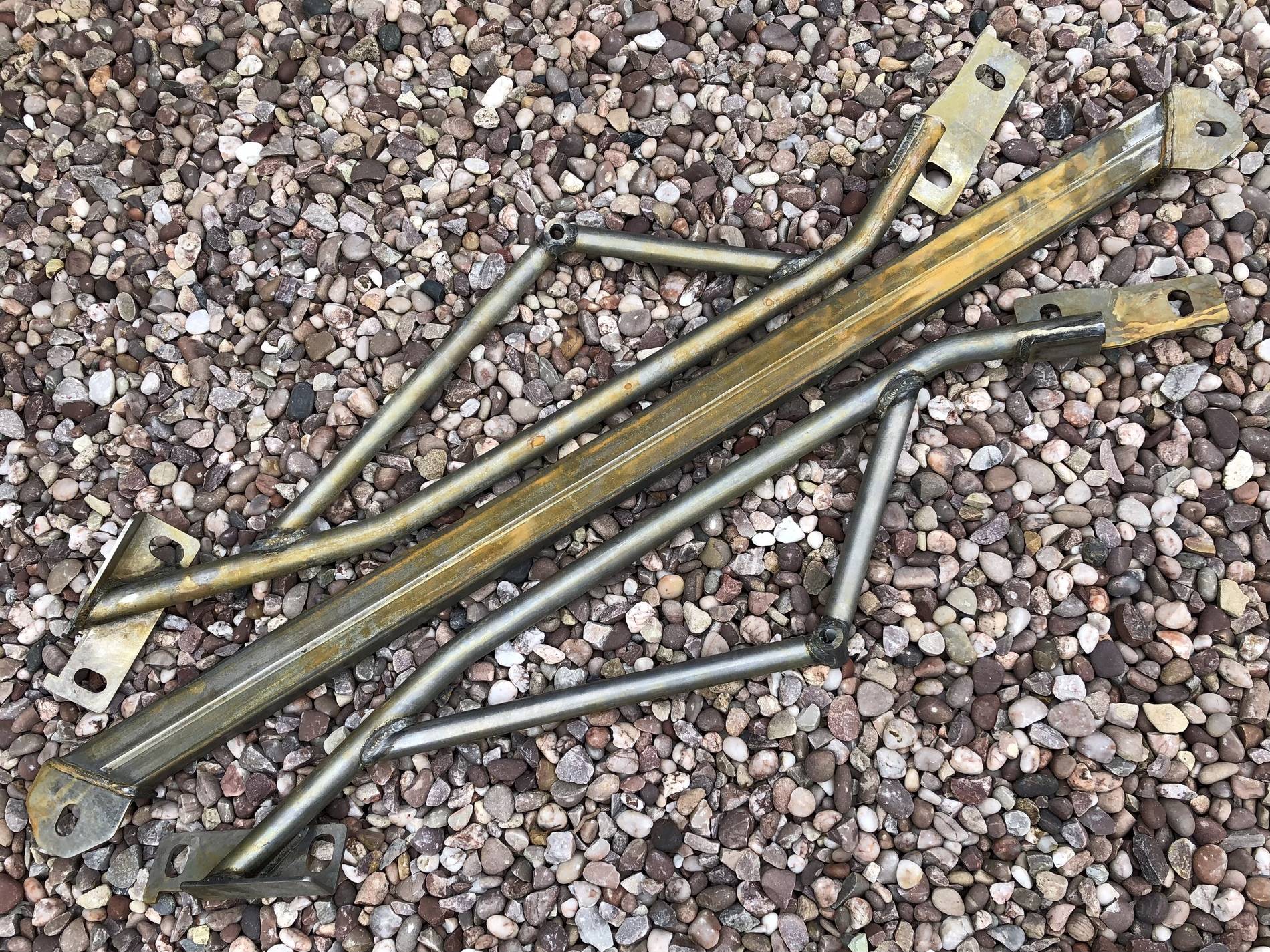

Time to work on the Steeda stuff :like: As supplied, appears to be very little surface prep prior to coating :
Confirmed after a chemical strip :

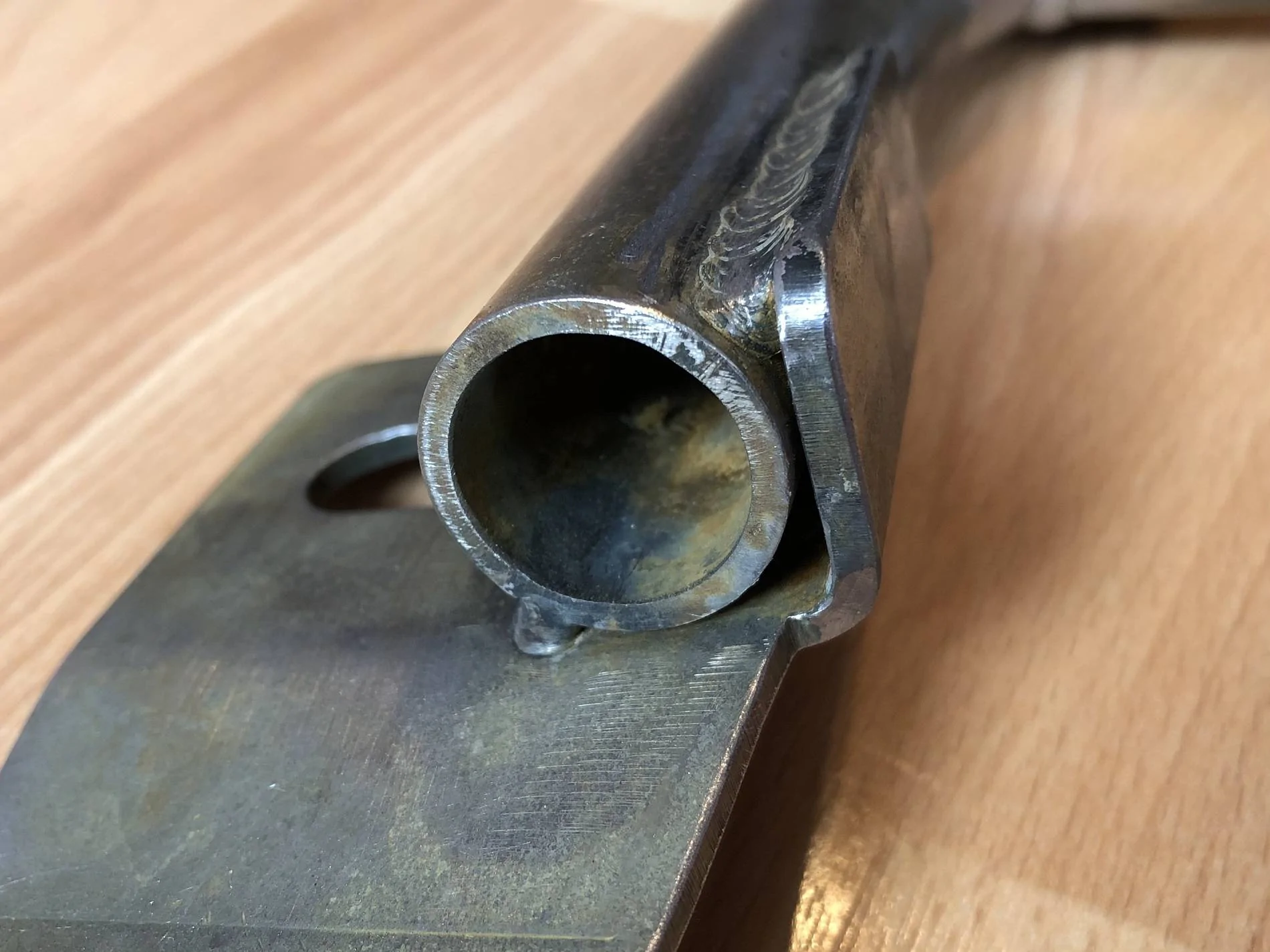

Straight from the chemical bath :
After dressing / blunting all the sharp edges / removing weld spatter / smoothing some of the welds etc :
Standard - a nice rust starter, even with good coating :
After some brazing (done in the front room ... :giggle:) :

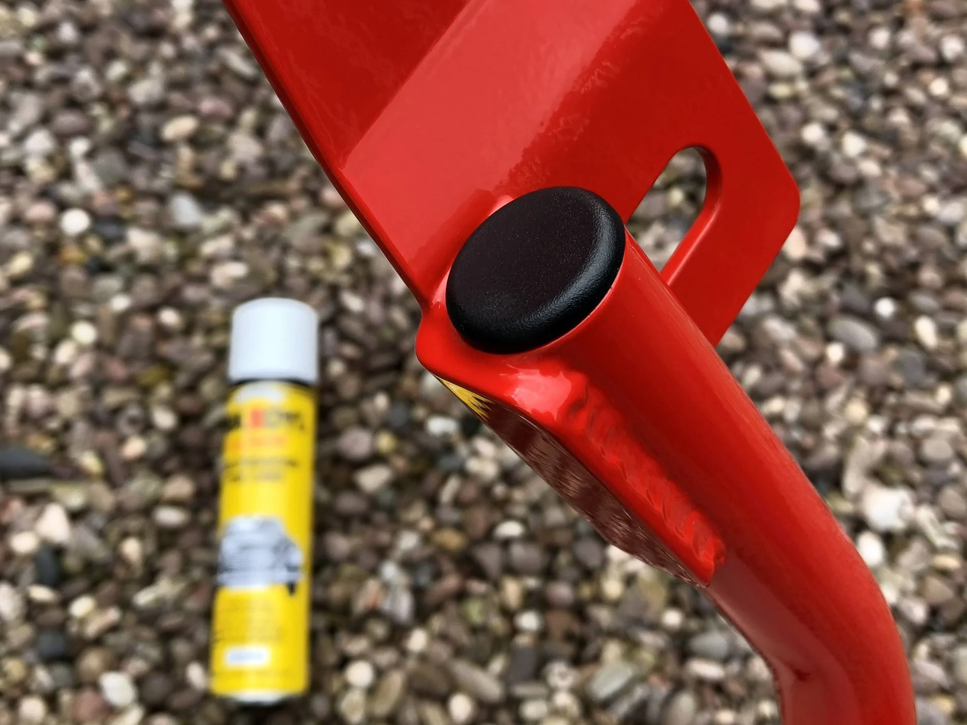

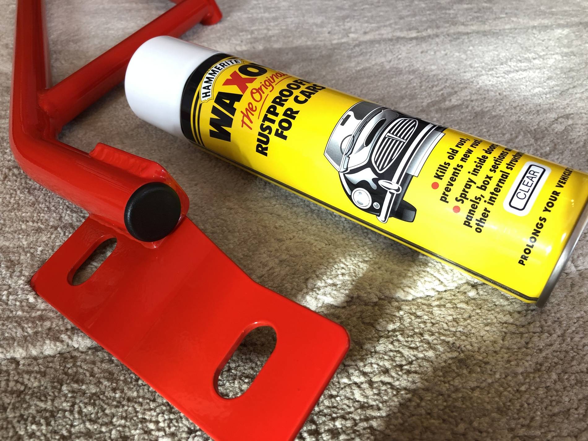

Coated in RAL3020 (traffic red). I used 3020 as it’s a proper red, I have used it before on other auto projects and as I know the reference, I can easily match it in future :

Mine are finished now, ready to be put back in their box until I fit them (they are last on the list of the suspension jobs).
I put some Waxoyl in the tubes before refitting the caps and flatted back the lining on the boss where it clamps so it doesn't crack the edges when torqued up.
Thick gauge large diameter stainless washers on order for all the mounting locations.
I took the opportunity to put them up against the lime and it's fair to say the red really pop's (@Justin also mentioned this with his red bits) :sunglasses:
If viewed at the same angle / in the same light, the red is very similar to the red on the 5.0 dot (which is a little more red than the orangey red of the Brembo print on the front callipers).
